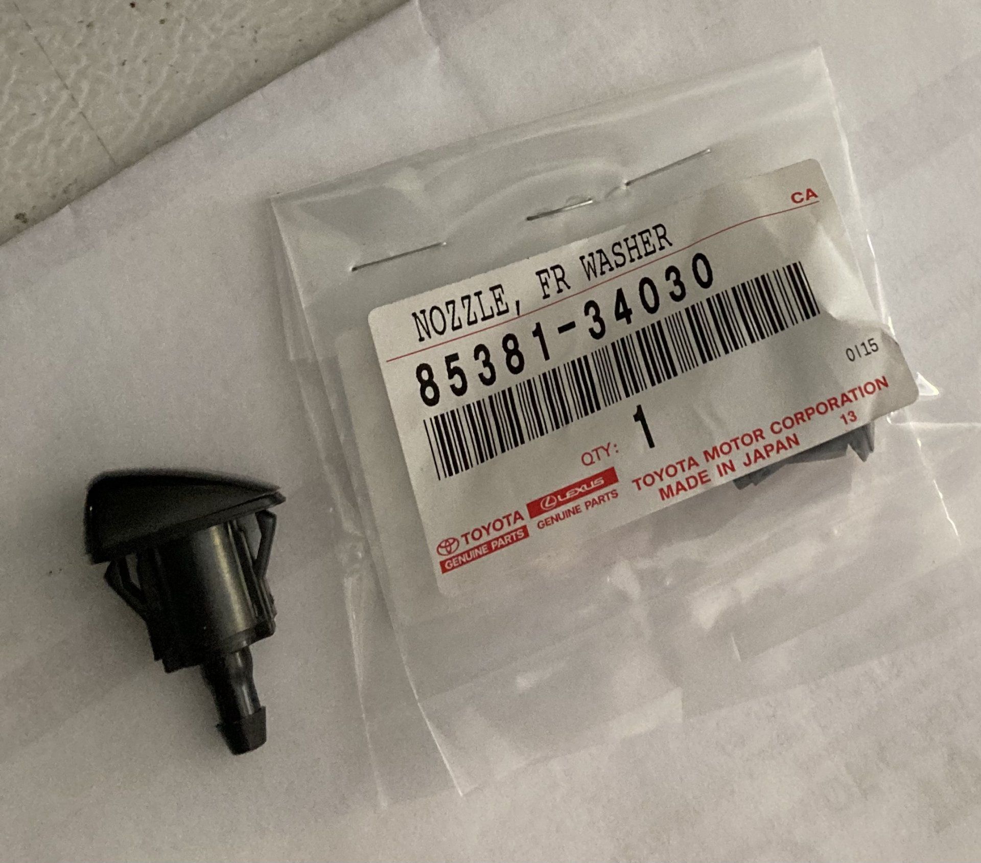

I really didn't like the windshield jet pattern so $20 and 20 minutes fixed that. (1 Viewer)
Based on many discussions and opinions from a few different threadsI went with OEM
So yeah, turns out that toyota part number 8538134030 is an exact fit, spray pattern is also a very welcome upgrade over the original two stream nozzles couldn't take pictures as it is dark outside but will update tomorrow
I just installed these and this worked great for me. I added the valve mentioned as well right before the bifurcation to stop fluid from running back to reservoir and it is perfect. Nice wide pattern although hits about 1/3 of the way up the windshield. Fine for me based on a non-OEM version that I tried prior.

Not on these that I used. It is a wide angle mist that hits the same height as stock but much wider coverage than the 3 spray design. I much prefer these.
