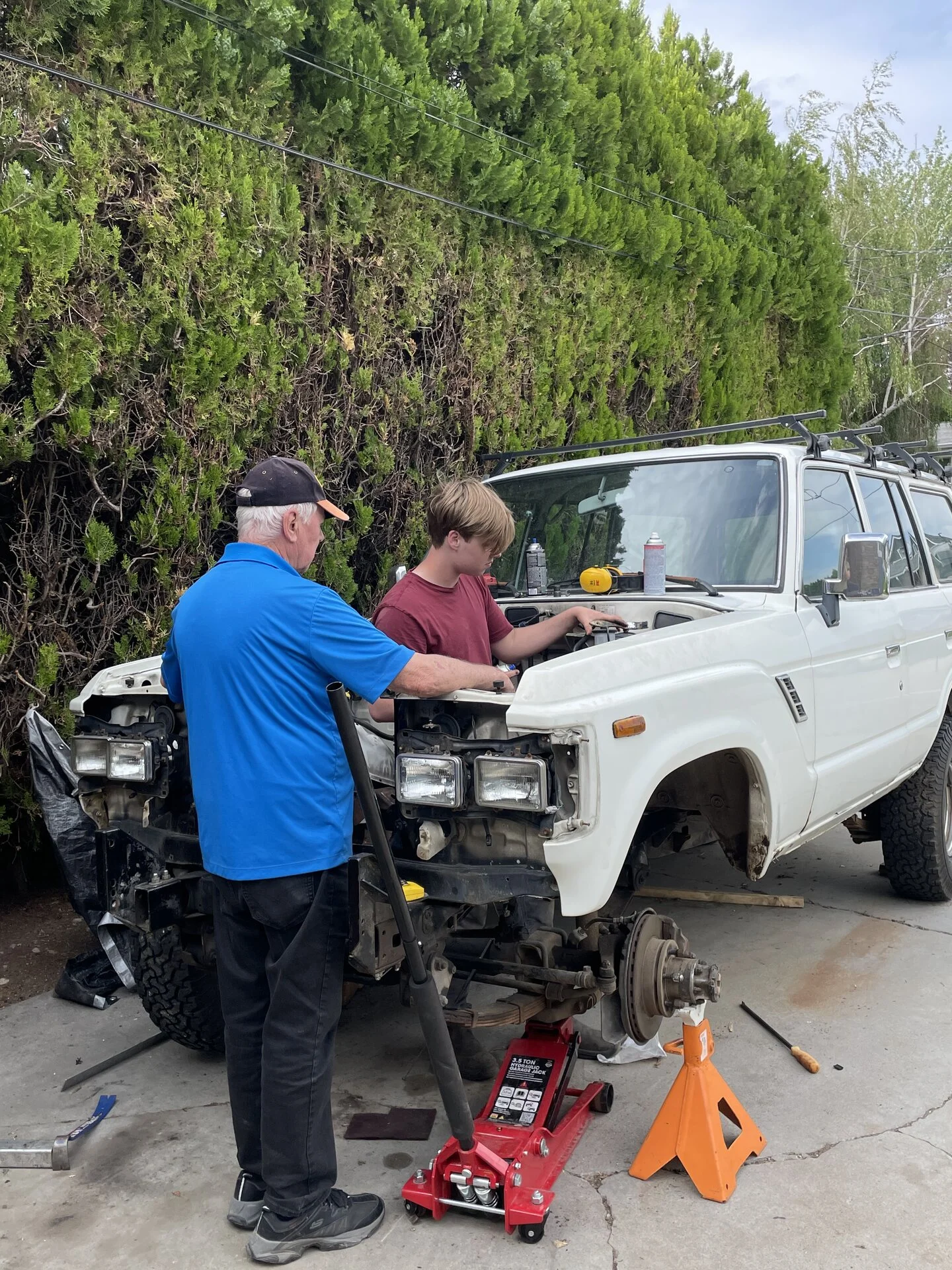

Yep did it on my parents driveway - we don’t have a shop - has to buy a bunch of tools.
I figured if I wanted a diesel 60 bad enough I would have to build one on my own.
I wouldn’t not do it again unless I had a big shop to work in.
