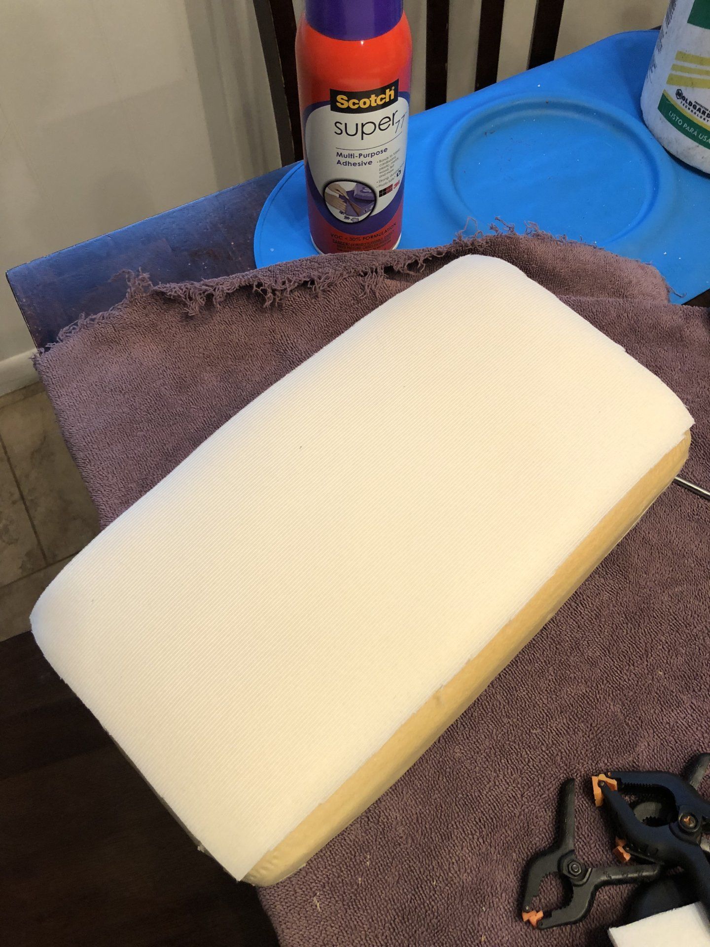

Decided to tackle the console cover.
The foam underneath was all eaten up where the hole is so I cut it out and replaced it with new foam.
This is the $35 Ebay console cover. Fit great, stretched good. I stapled in over the 3M adhesive and Gorilla Glue’d the corners. I think it came out great.
