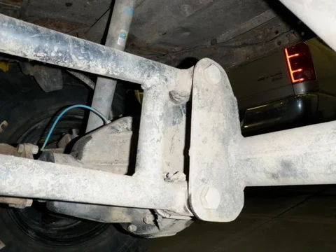

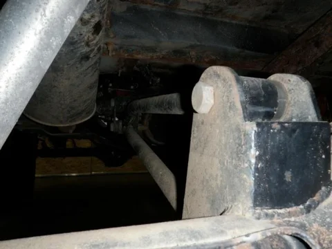

PO built a nice one on my 40, holla if u need a pic.
Anti-wrap:
yes, the twisting force starts at the axle and is greatly reduced by "reverse" leverage, caused by the length of the trac bar.
Thanks for the pics Todd, one question though. Is the stock crossmember strong enough to withstand the forces being exerted upon it by the anti-wrap bar?
I disagree with John a little on his answer since it will depend on the integrity of your cross member. Some are in much better shape than others and I have seen some fail in the past. In those instances the owner should have known better. Prior to flipping my rear springs I had my track bar attached to the stock cross member and it held fine since it was in good condition. When I flipped my rear springs to make room for the auto I had to cut the original cross member and I had Carl fab me a new one out of DOM. RuffStuff has a great kit to make your own track bar which is what I will use if I ever do it again. I fabbed my own from scratch with Mike and AJ supervising and it was a PITA and still cost close to $250! I used chromoly tubing and expensive heims, but still it added up quick. It is definitely cheaper than not running one...right Luke?!? :D

It will be strong enough, provided it isnt a rusty POS,
:flipoff2:
My crossmember is in amazing shape. There is zero rust and was painted by the PO. No dents, dings, or damage. There is a bit of debate using the stock crossmember since it is thinwall tube. I've seen examples of using the stock tube with success so it is something I will try. If it doesn't work, I have enough tubing to fab up a new one.

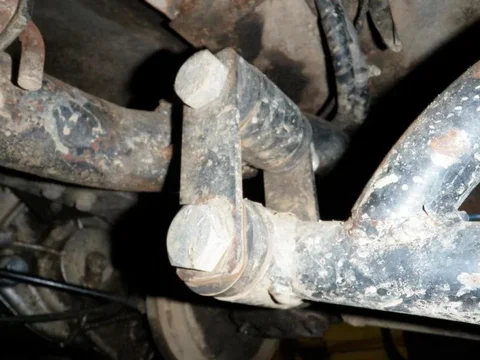

I have some solid tube & heim joints from a truck with a 4 link rear end I stripped in my garage
I kept all the links/heims, in case I ever needed them....Looks like a good time to break that stuff out & see what i can do wif it.
Guess I didn't know the front end of it had to pivot, but I guess it makes sense (?) I think I will need help on this part of the project.

Wow, more nice pics...After thinking about this some more I guess it would have to pivot at the front.
Was comparing it to the factory front anti-wrap on a solid axle Toyota mini truck, just a rubber bushing on each end.
