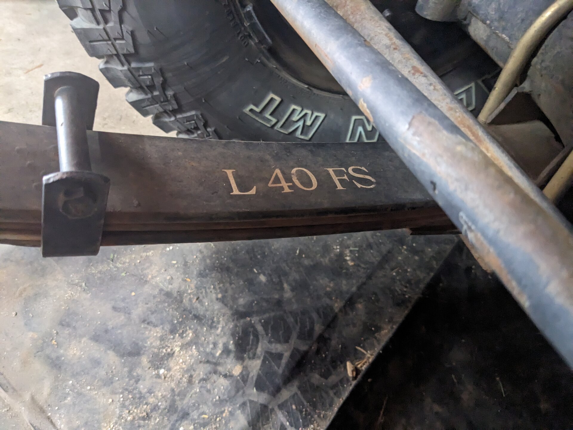

The lift seems to be Rancho shocks and maybe Skyjacker leafs? A good 4 inch lift. Damn rough ride for sure, looking to replace it with something less bouncy. I have driven 40's before, this is just a little too much. :)

The ride sucks, even for a 40. Very harsh. There is a local guy selling an Alcan 4" lift with Rancho shocks that sounds like a smoother ride...although I currently have Rancho shocks and I think the springs are Skyjacker. Any thoughts?

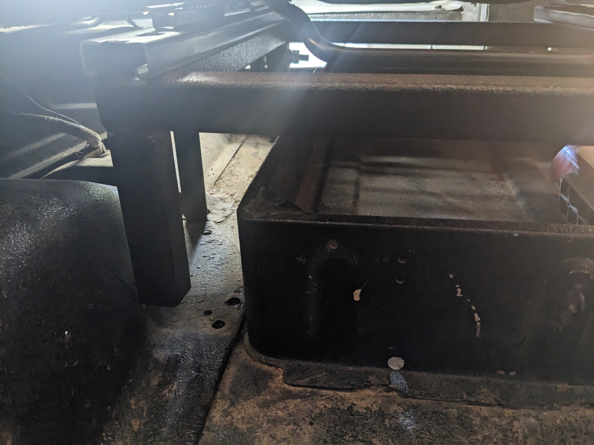

Darn seat is too high...my legs barely fit under the steering wheel. Aftermarket seats (Jegs?) are pretty comfy but I need more room. Bracket looks very strange. (yeah, one end is an inch above the floor...) Any ideas on a better seat bracket? (pics attached)

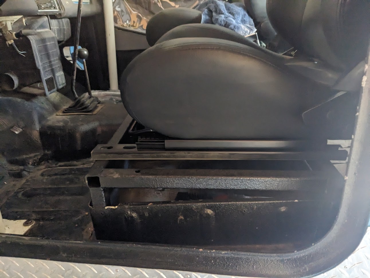

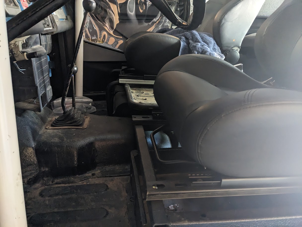

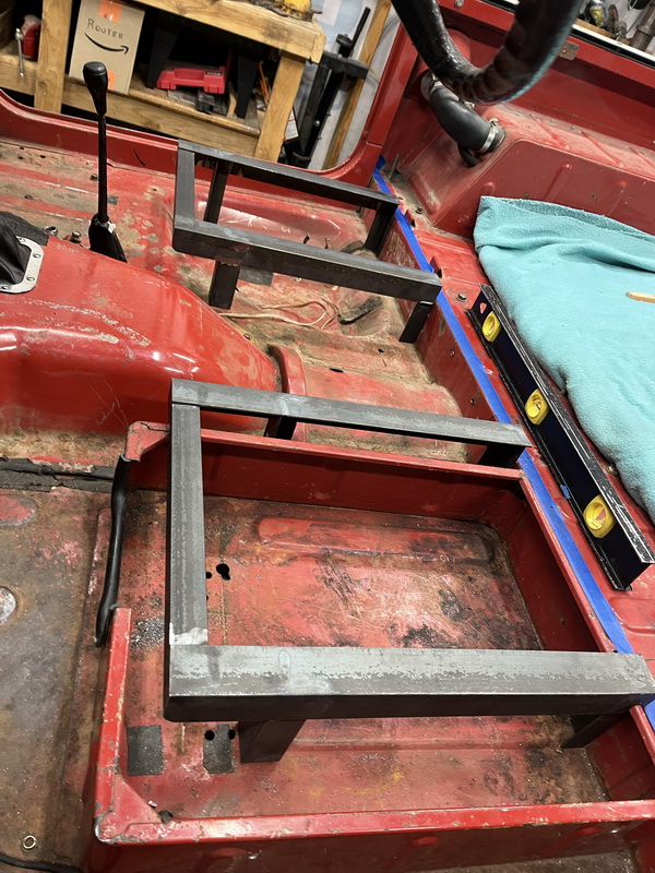

I just finished redoing the interior of my 72 and made new seat brackets the sit just to the height of the driver's side storage. the first pick shows mocking up seat frames. 2nd shows completed and amount of clearance between seat and steering wheel.

great cruiser. Im not a big rancho fan at all. I would at minimum go with bilstein. The obvious answer is dobinson IMS from all the fanboi on it, but that’s $250 a shock.
Do you know any specs on the Alcan? Those can be pretty custom so you might need to see the specs before you get shocks.
Alcan springs are custom. They will want to talk to you on the phone before you order to set them for what you want. I went with them on my 78. It is not running yet so I do not know how they ride yet.
