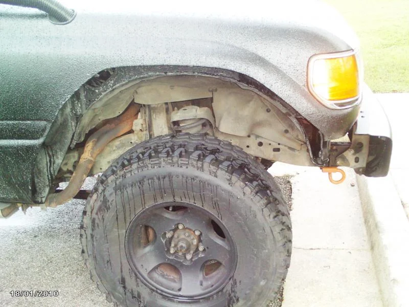

I cut the inner fenders out...
Before:

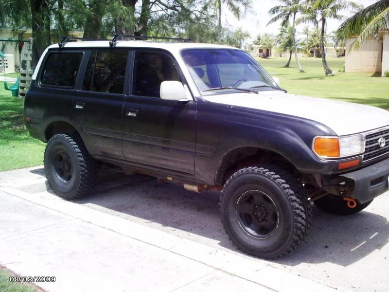

After (same pic as above):
no worries about mud getting into the engine . just wash it off. But i cut out only the outer few inches of the inner fender. all the gains are in cutting out the outer few inches as thats the part of the fender that hangs down.
and on the rear fender i didnt cut the fender at all of the forward part of the fender. I cut only the rear part of fender. but if u do that u will need to extend the rear arms a bit (sleeve em).
Metaltech style is great but there is also one little problem...you can't ever remove the outer fender again with out cutting where you welded it to the inner fender. The outer fender bolts into the body with at least nine bolts after the inner fender is cut, and that is more than enough support for me.
Just so everybody is clear, the MetalTech Fender Cut does NOT weld the inner fender to the outer fender! You can still remove the outer fender just like you did before. :cheers:
Sorry for assuming about what I saw from the pics creeper...so is it bolted or what? It looked welded...

Good work (and thanks for the compliments :cheers:). But don't even consider 37's - you didn't need to cut anything material to run them.
Get those 38's on there :bounce:

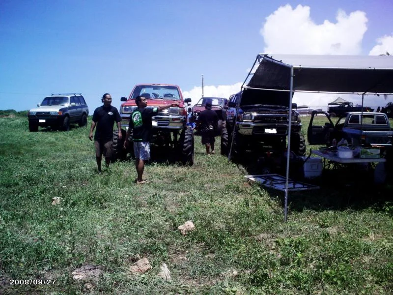

Here's a SAS mini and 4runner...maybe I'll be next...we'll see:
That pic is great because everyone was setting up to watch the mud drag! It is an island favorite here in Guam...an all day event every 2-3 months :hillbilly:.
Neither! We used that rubber edging on the modified inner fender. The inner fender was designed to make a good seal with the outer fender just by tention. The rubber keeps it from rattling. I hope that makes sense...
