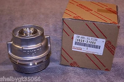

Someone needs to make a sticky of the mods to make sure you do for the gx. Holy cow!!! I wasted a good chunk of my weekend to change the oil. yeah, the darn plastic filter housing cracked ( I was not using an impact) and then it was a race to find the aluminum housing. Had to go with one from amazon.com as no local dealers had the (15620-31060) toyota aluminum housing, then I had to go back and get a oil plug for the center of the new housing and o ring.
What a pain!!!
If you have not swapped to the aluminum housing, buy one now!
@StucknKS
Kelly, pn's for the plug/gasket? looks like I will be upgrading the one in my fleet that uses this.

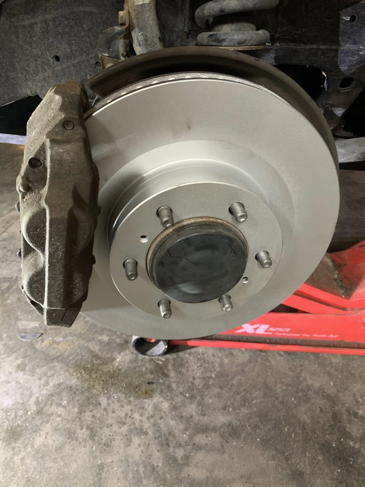

Had an unfortunate problem. Never had a warning noise from the front brake pads before they went out. Appears that the metal squeaker actually rusted....so likely when it started making noise it broke off. The result was that we had metal on metal and ruined the rotor. So installed Bosch quiet cast rotors and pads....
