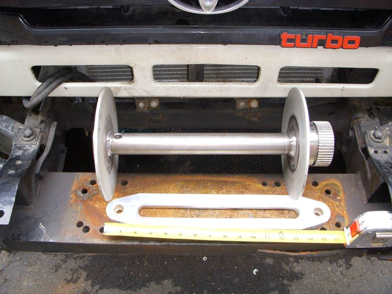

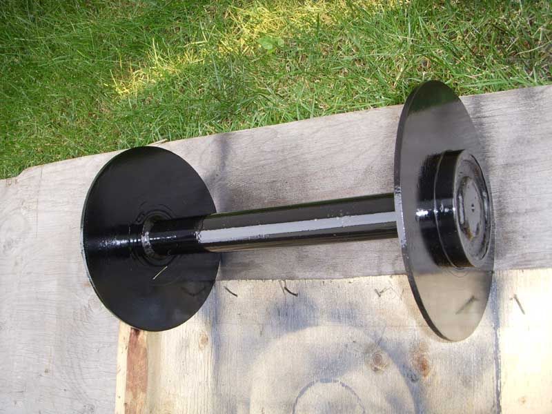

Getting my Warn 8274 winch drum back today, had the drum size reduced to 1.5 inches and had it lengthened 4 inches, should be pulling pretty well now.
Warn 8274 drum mods
Ok, got the drum for my 8274 back, looks great and should put very well. The drum size was reduced from 3 inches to 1.5 inches, we used 1.5 inch solid stock for the retrofit - it won't ever break. The old drum was cut out, surface was machined, jig set up and rewelded.
Over all the drum was lengthened 4 inches as well. We also added 4 inches to the masterpull fairlead.
Here are some pics.
