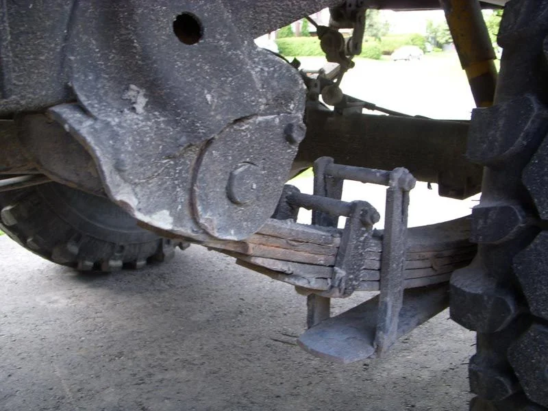

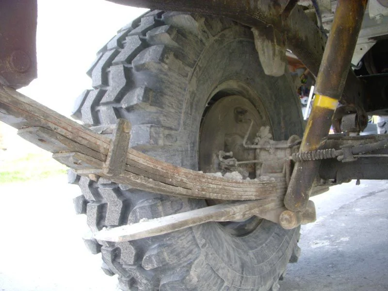

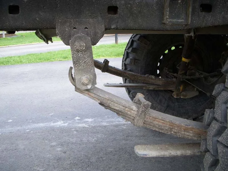

Ok here are some pics of what I am dealing with. I am pulling the packs off now and think I will remove the 2 overload flat springs, and the first leaf with the U bracket on it - I will then have a new U bracket installed by the spring shop here.
Then I'll load a couple of hundred pounds on it to mimic my aux tank and a spare tire, gear etc and then see how it is.
What do you guys think?
remove leaf 3 and 5 (from the top).
if you are never going to carry a load on the tray then get rid of the over loads BUT if you will be then leave one in...you will have to articulate quite a bit before it will come into effect...
the ride should be very smooth and then the articulation (fender rub) might come into play...

Ok, as Greg and Wayne suggested I removed #3 and 5 springs as well as the large load spring. I left one small overload spring in and it is very nice now, sits a little lower but has more movement. I also had the U brackets reinstalled on the old 4th spring which is now the 3rd spring.
I'll drive it for a while and if I feel I need more stiffness I can always go back in and add an old leaf.

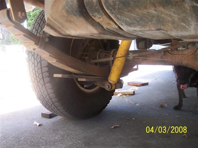

My leaves look a little thinnner
