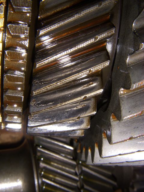

I tore the tranny down and found that one gear on a shaft was breaking down, the corresponding gear on the output shaft was doing the same, so luckily I had a spare tranny that I tore apart and I can swap out the parts that I need. Also, the R151 on the cruiser has a short output shaft that is connected to the transfer with a sleeve/shaft that go into the transfer case. The old shafts were a 3 piece type ie. output shaft/sleeve/transfer input shaft, but they were weak so toyota made a solid transfer input shaft with the sleeve attached - looks a whole lot stronger that the old set up.
I also bought a marlin reinforcement plate for inside the tranny to keep things nice and tight. Maybe some day I will buy an H150 to install but I have been torturing the r151 for 3 years and it didn't fail.

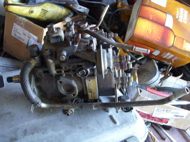

Injection pump is out and getting ready for a boost comp. install at the injection shop, rebuild the pump while it is out?? only 150 k kms on it so I don't think so. Bought the SST for pump nut removal - makes life easy.

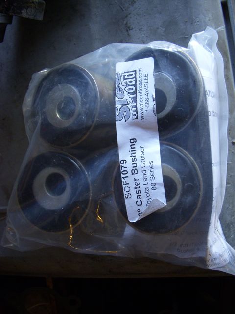

Also installing some castor correction bushings from slee, some new material with more flex, right now my bushings are just flopping around in there.

Where did you get your boost compensator from? Toyota? What are they worth anyway?

It's going well, I rebuilt the tranny, waiting for the tcase kit to come in from radd cruisers, clutch kit is in customs now so just waiting for that, boost comp is in the mail as well, cosy me 223 euro - about 320 all in. The engine is coming out next week, then everything goes in for ceramic coating, will get the XMC coating on the mainfold and the regular ceramic coating on the turbo and outlet and down pipe.

Oh, once the boost comp is here I'll send the pump out for rebuild and comp install.

I'm being held up by the boost compensator that I am waiting for from All American Imports in NL, once it gets here I can get the pump sent off to saskatoon for the compensator install and some pump adjustments. Then I get to set the valves and get everything back together.
