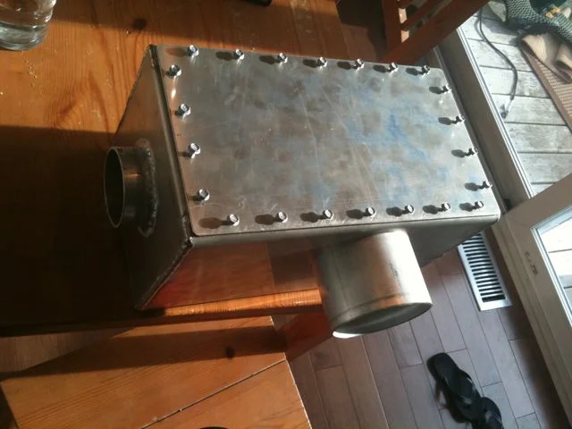

It's been a while since I have posted here but I am just upgrading my snorkel to something that allows for proper airflow, here is my airbox all welded up with large size unifilter. 4 inch filter opening and 3 inch to the turbo, 4 inch inlet to the 4 inch snorkel - will post more pics after I weld on the brackets to hold the box in place. The snorkel is cut and ready to do.
That air box looks king,
Are you sure it will fit in your engine bay ;)
Cant wait to see the snorkel fitted up

It is a blow by tube, I run it into the air cleaner as I want it sealed and not venting to atmosphere. There is a filter catch can on it to catch the oil before it hits the unifilter.
