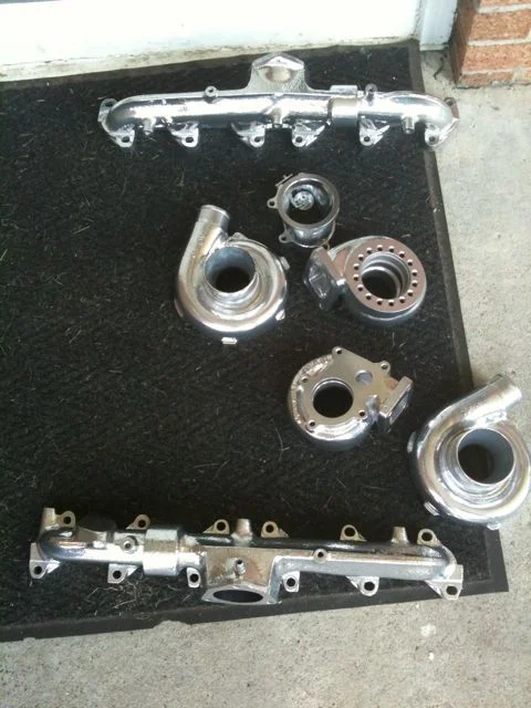

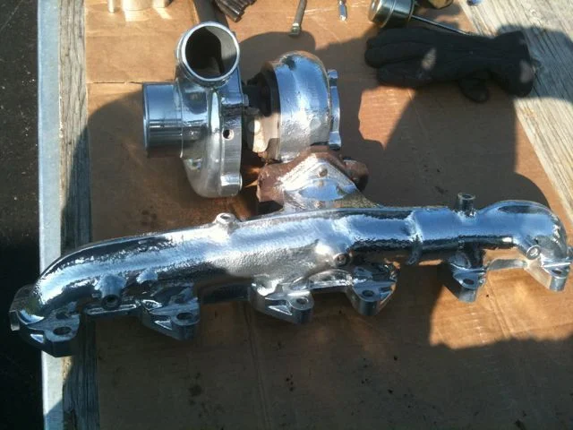

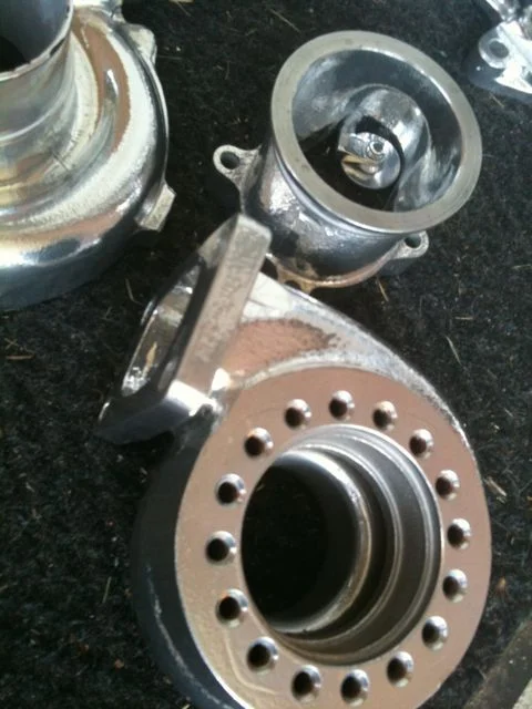

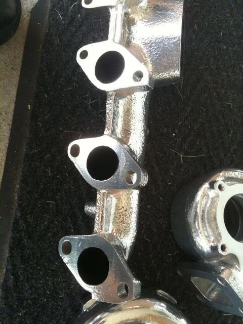

I finally have a bit of an update, just got my coated parts back and I sold my other 1HZ engine - the new owner wanted his parts coated as well. Everything looks great, this coating is very tough and very impressive, i had another coating done inside the ex manifold (XMC coating fireballcoatings.com), the xmc coating is supposed to result in more hp and better fuel economy in the big trucks - i did it just for the heck of it. I even had the turbo outlet coated and I'll be ceramic coating the downpipe as well to keep the temps out of the engine bay.
There is a big difference between ceramic coating and cermichrome - if you are having something coated make sure you know what you are getting.

Here are the pics of the coatings.

looks very nice and shiny mate
hope it works better
