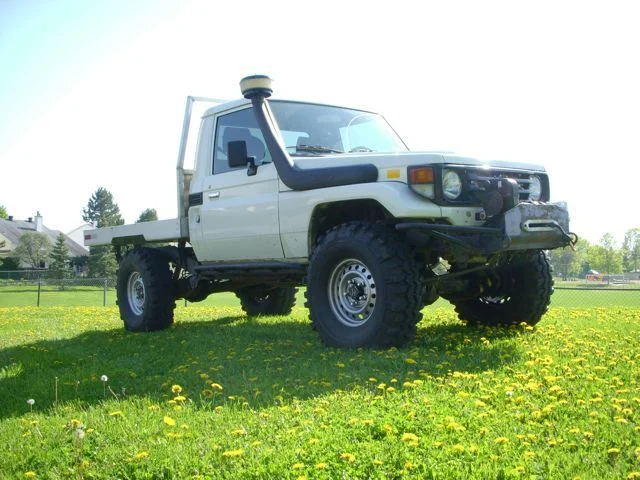

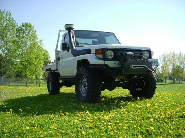

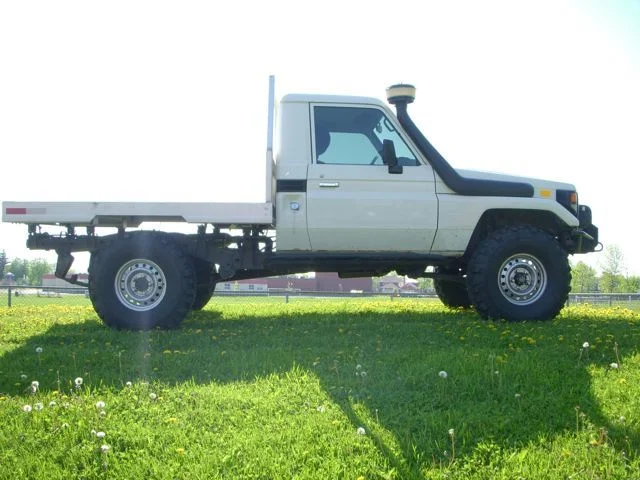

Ok, got the spacers installed and it rides nice and high now. Summer tires are back on and ready for some fun as well.

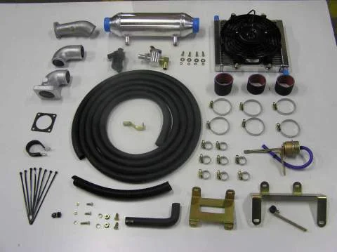

Just bought the 4x10 PWR barrel intercooler and should have it next week, just have to figure out where I will mount the intercooler rad - maybe behind the cab on the tray headboard thing as I never really carry anything in the back anyway. I don't want the rad in the engine comp or in front of the rad, and I don't want it underneath the truck anywhere as it will just get full of dirt and crap. Anyone have some suggestions?
This is where I ordered the intercooler from, cheapest place in North America that I could find:
PWR Intercoolers

Dude nice wheels and makes the rig look even better just need to add MUD haha.

So did you get a whole kit from those guys or just the tube and you are making your own??

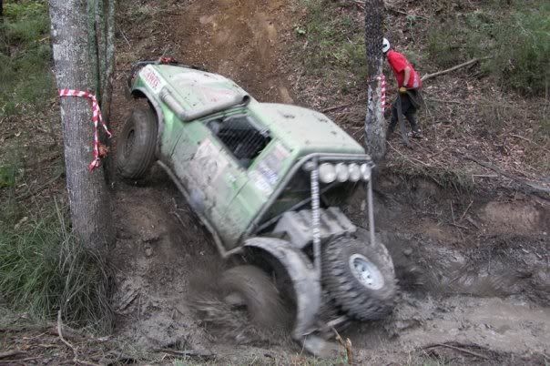

Completely insane! He is running a 60 series rear end in the front with a GQ diff and 80 series knuckle balls welded on - and longfield shafts. There is no way the new 7X series front ends would survive that.
It was a good event that one, some series carnage at that stage though. Heres a coupla pics from it. The Blue GQ snapped a radius arm, which allowed the diff to twist up and hole the sump, at full noise. Didnt sound healthy.
Thanks,
Michael
I just got the barrel from them, the rest I will get from silicone intakes probably - unless you know of another place?
I'll custom make the connectors from the turbo and intake to the cooler. the rest is pretty standard stuff. I'll use a 12x12x2 intercooler rad and a bosch cobra pump.
This link has heaps more pics and vids

BTW.. I was looking at Silicone intakes and they have an intercooler that would work instead of the barrel for a lot less $$
Water to Air Intercoolers
