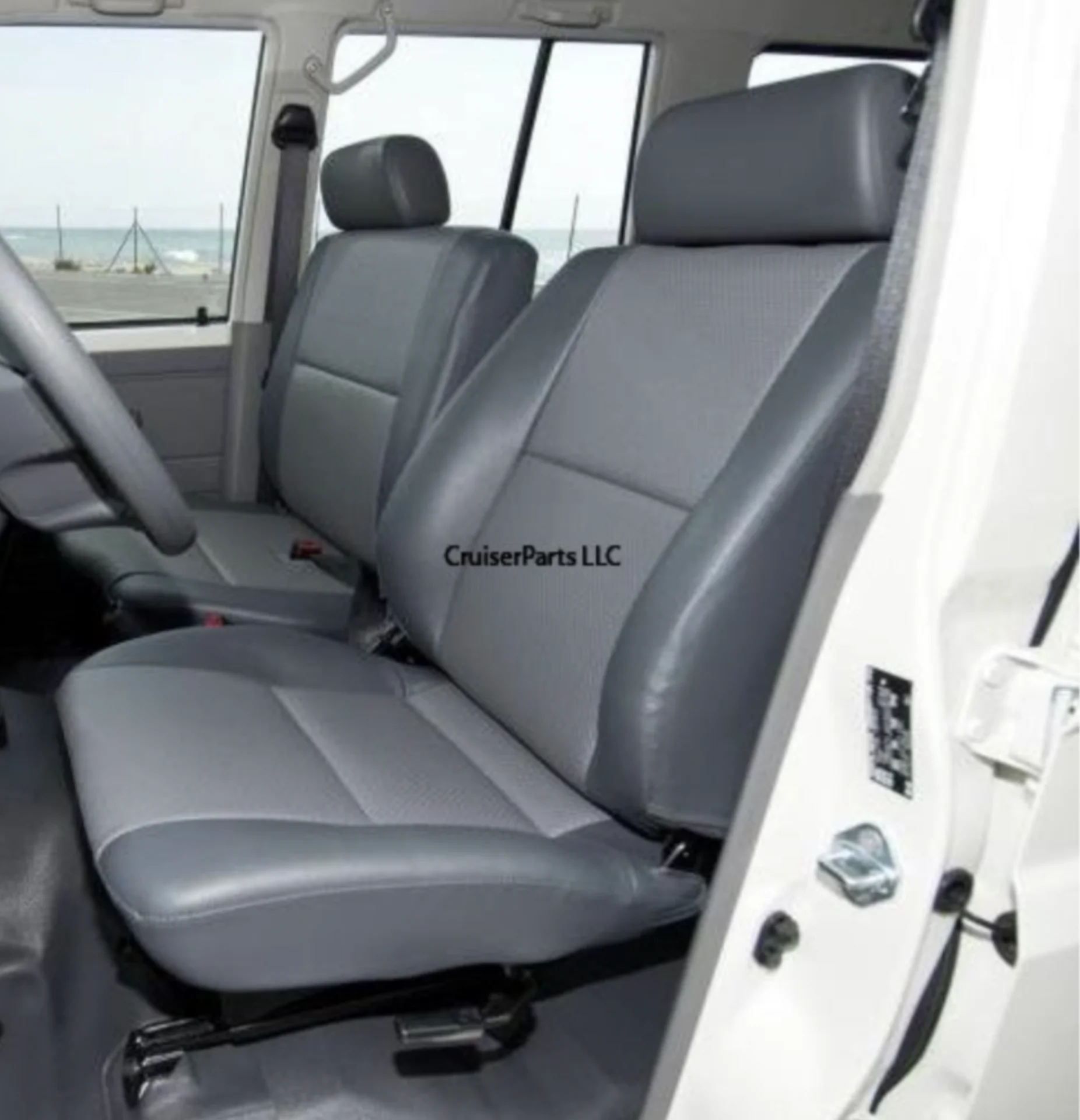

I bought a set of these seats which I believe are from a more recent hzj76(picture is from cruiserparts) . I have a 1990 hzj77 with suspension seats. The rear seat installed perfectly with zero issues but the front two have some problems I need to work around. The track mounts are vertically staggered about 1 inch on the driver and passenger side (RHD). The mounts are also wider on the passenger side because the seat is from what I can tell a 60/40 split bench seat. Does anyone know of an adapter I could use to fix these issues or should I have something custom fabricated? Has anyone run into this issue before? Bought the seats knowing they were from a 70 series but not much more than that. They look great so I would really like to have the set match if it's feasible.
Any advice is welcome! And thank you

I would look into adding the new seats to the suspension bases unless it is a 60/40 split set up as pictured.
It is the 60/40 set up, the drivers side is doable that way but the passenger side has a wider track set up

Yeah, if you have the 60/40 set up then you will need to find the captive nuts under the floor if you want to go swap that “bench” seat to a single seat. My understanding is that these captive nuts may not exist in the newer rigs. So you would have to make new holes and use bolts w/ nuts. Didn’t think suspension seats came in the 60/40 set up🤷‍♂️ or are you swapping the single seat for a “bench” seat?
I'm swapping the single seat for the bench you are on point lol. I think my original post was worded poorly and created confusion
Ok, now maybe people can help more intelligently 😉 haven’t heard anyone doing what you want to do since everyone usually wants to go the other way. I’m going to guess you are going to have to figure this out yourself. You could ask on one of the 70 series groups on Facebook.

Non-suspension seats have different mounting points. And, as you may have noticed, rails are staggered.
Some custom fabrication is needed to make them fit.
