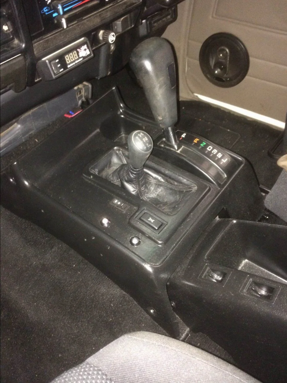

Progress report:
Looks a bit dusty in there but you get the picture ;) It'll get cleaned at some point
