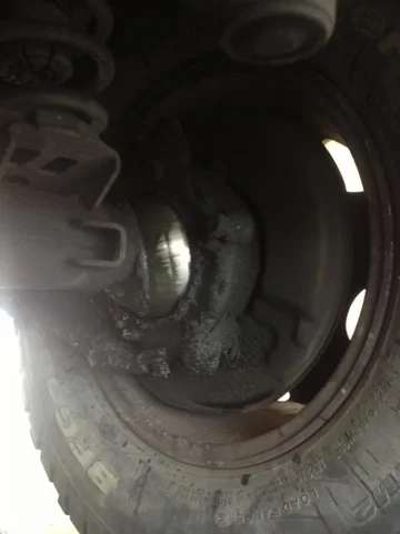

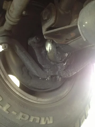

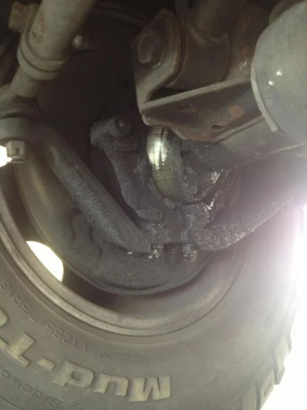

Day 24: after the tank of gas, with a bottle of injector cleaner, I started my front end rebuild with a trip to the coin op car wash to degrease those nasty knuckles.
Got everything torn down and cleaned all parts, prepped for reinstall.
