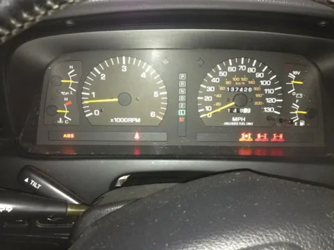

Day 18: CDL hasn't worked (and hence the front and rear lockers haven't worked) since I got the rig, (I used it to negotiate a better purchase price) and just now got around to tinkering with it. I pulled the connector on the cdl position switch, used a paper clip as a jumper to connect the two female receptacles within the connector, went and turned the key to "on", and poof, my elusive cdl dash light came on :D
So I pulled the cdl position switch and began looking for my multimeter to test it. had to go buy a new multimeter because I couldn't find mine :doh:
Got home, had infinite resistance on switch without depressing it, and about 100-150 resistance when depressed. :/ banged on the metal hex part of the switch housing and had about 60-100 resistance, knocked it again a few times, 30-60, came to mud, searched, found some cdl threads with advice about cycling/depressing the switch rapidly about 20 times, so I played with it (the switch boys, the switch!), and had 000-006ish resistance. :D
Happy camper!!
Nice job! As someone who had non-working CDL when bought too, sure is an awesome feeling to finally see those 3 lights light up solid! Enjoy
