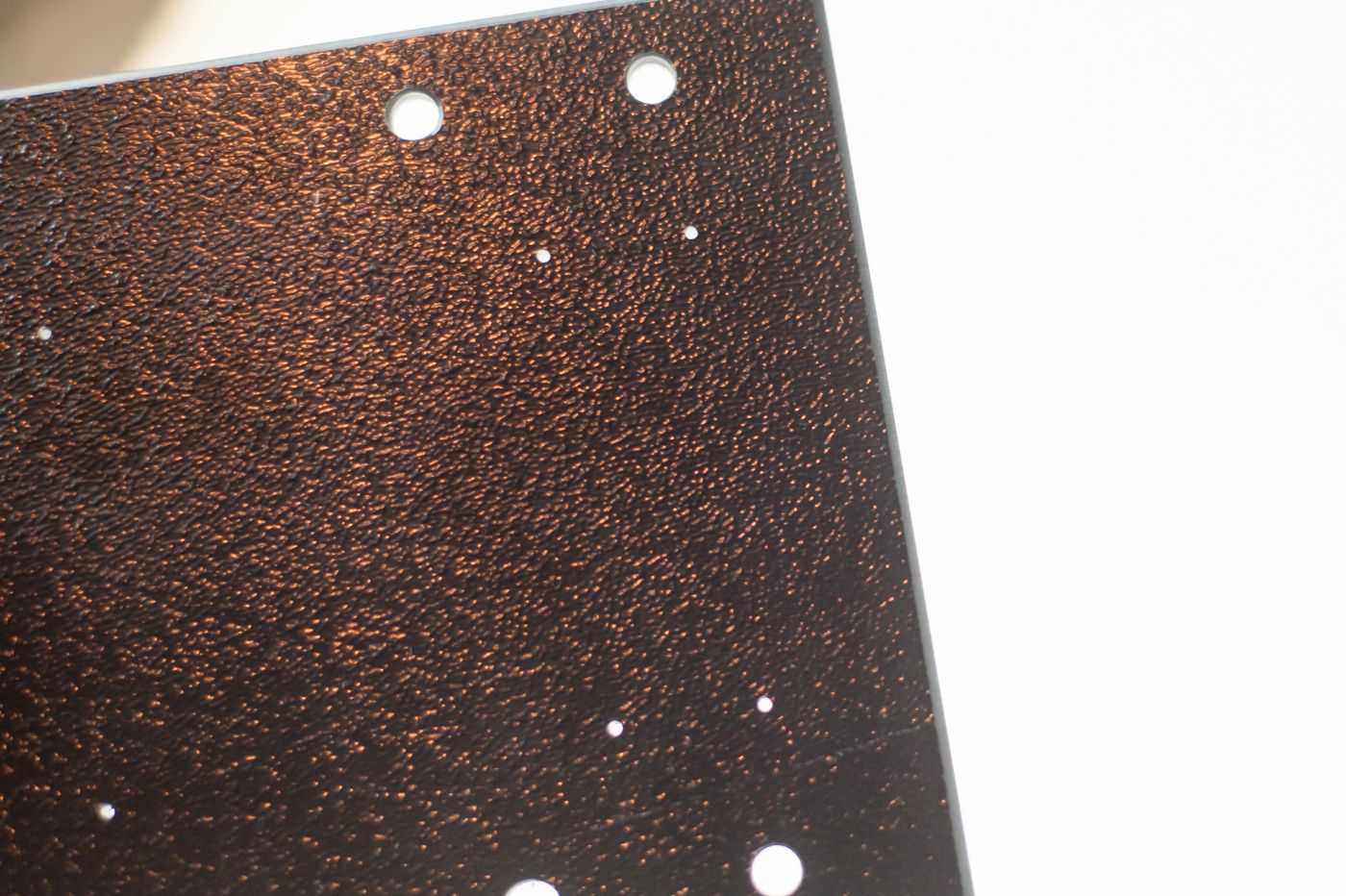

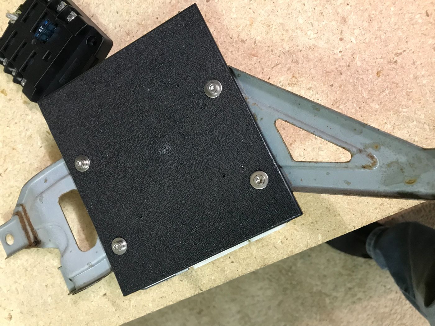

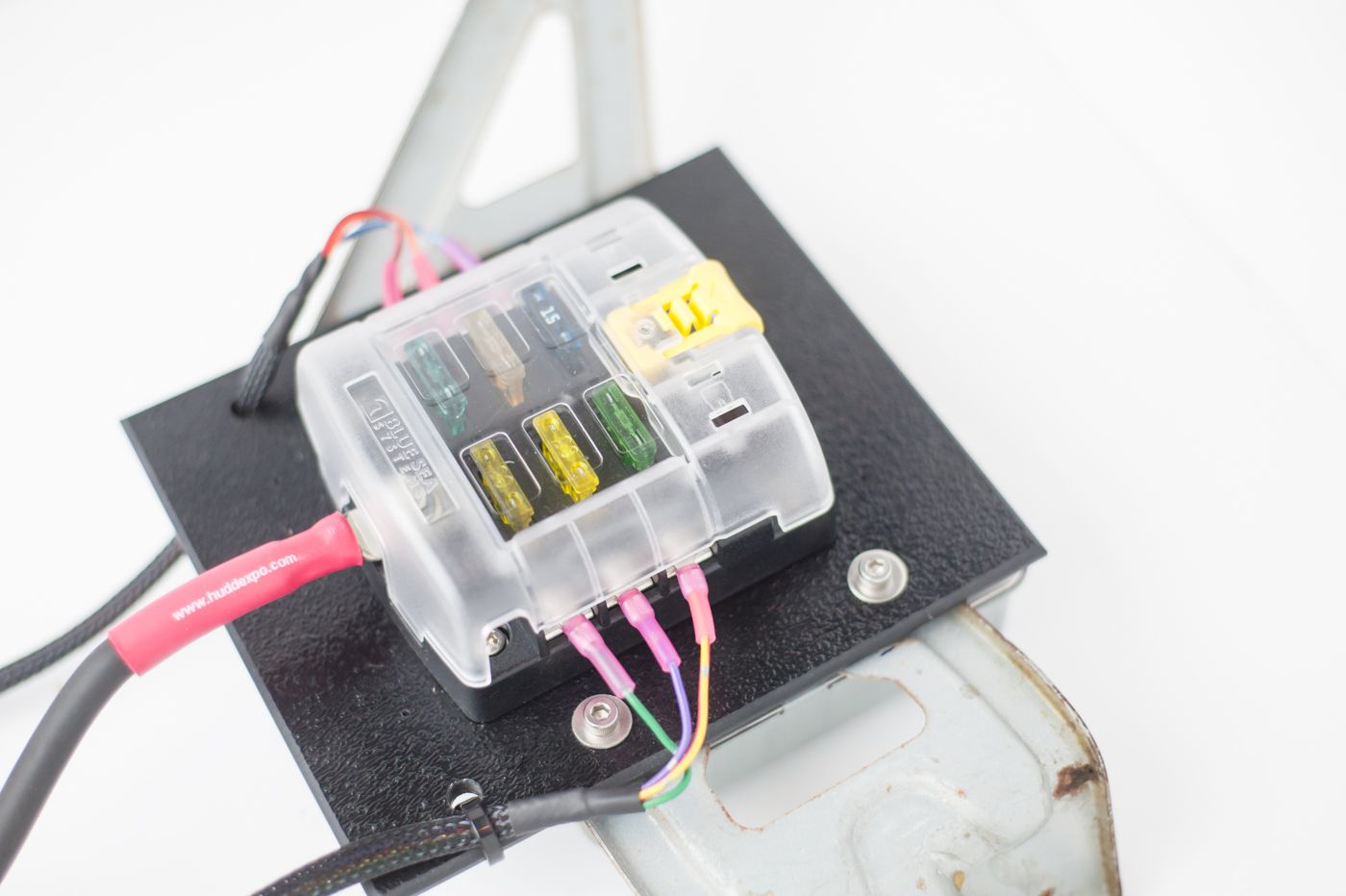

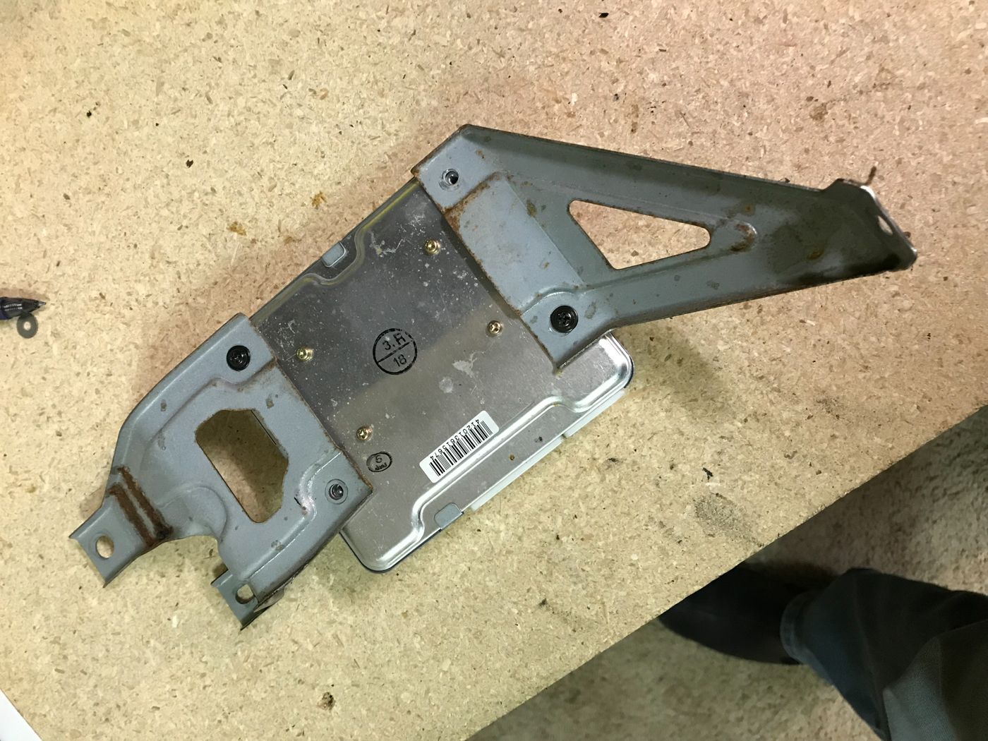

I have had many requests to roll out a simple kit to add a fuse block to the main battery for the guys that prefer not to deal with the dual battery setup or that just want to get some more power into the cab. Here is the beginning. I will be offering a 3/8" thick HDPE panel cut that will install onto the brackets holding the ABS module at the drivers side kick panel. For now, this works with the 95-97 as I haven't had a chance to look at the other years. **update* will work for years 94-97.
I plan to offer the mounting panel, choice of two fuse blocks ( 6 and 12 circuit), 4awg cables for the main battery to the fuse block and a 100amp circuit breaker.
Nice thing about this, is that I am making the panel large enough soif you want to add some other small things at that location you can just drill it and mount it up.
I don't have pics of it in the truck yet, but here are some pics of the beginning. Let me know your thoughts or if I am missing something obvious.

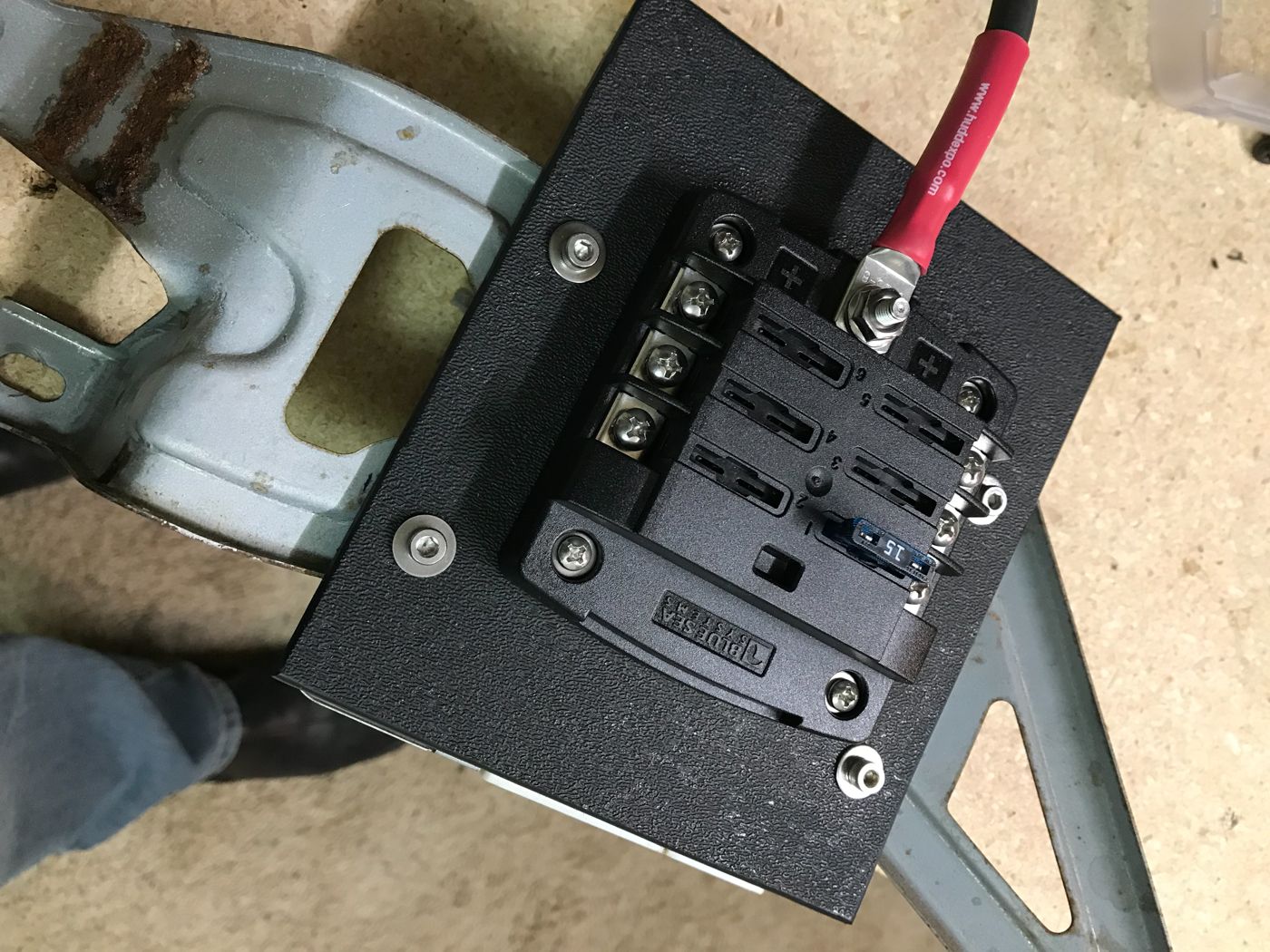

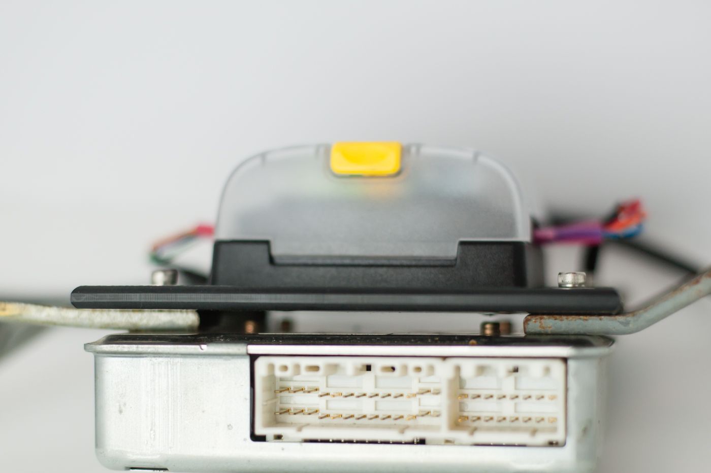

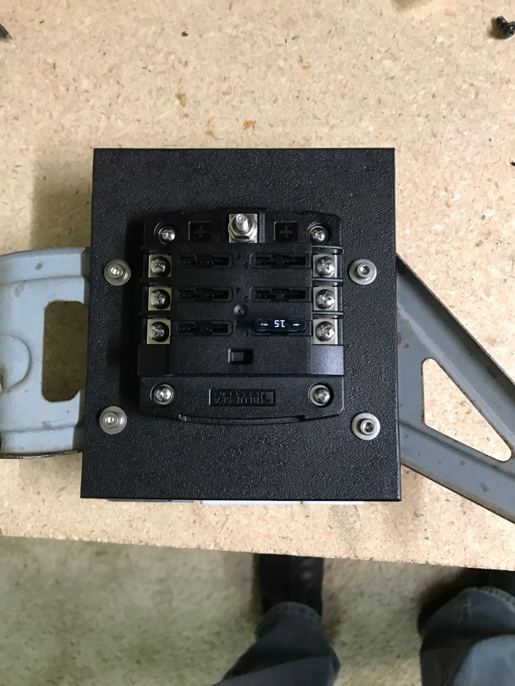

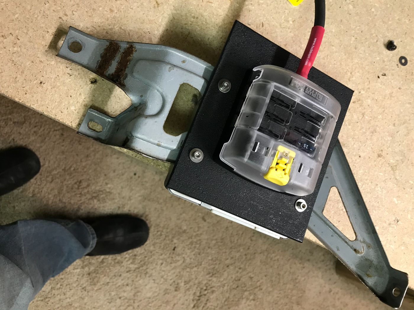

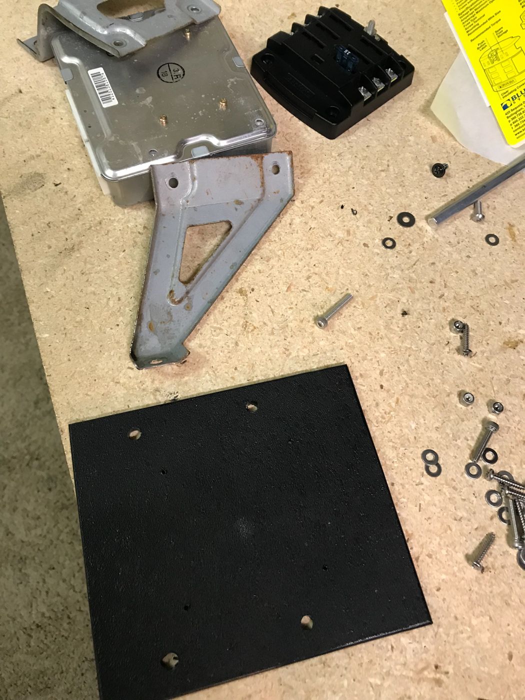

Final tweaks and changes made. I moved to 1/4" thick ABS for the mounting plate and have decided to allow each person to order as little or as much from the kit as they like, essentially once you pick the mounting plate, you can just add from there. Options will include tinned marine cable, fuse or circuit breaker, six or twelve circuit fuse block and an option for the circuit breaker mounting plate. You can see the circuit breaker mounting plate mentioned earlier in the thread. Here are some pics of the mounting panel with the six circuit BlueSea fuse block mounted. Remember, just is just inside the drivers kick panel slightly above and to the left of the dead pedal. The mounting plate is pre-drilled to allow easy mounting inside the truck along with pre-drilled holes for both the six and twelve circuit fuse block. There are also two holes at the top allowing you to zip tie the wiring, securing it just after the fuse block. Stainless mounting hardware will be included.
The mounting plate is also very easy to drill and if you pilot it, mounting other things to it will be really easy. I like the idea of mounting relays and other things if you don't need the fuse panel there.
I will have it listed for order on the site early next week.
