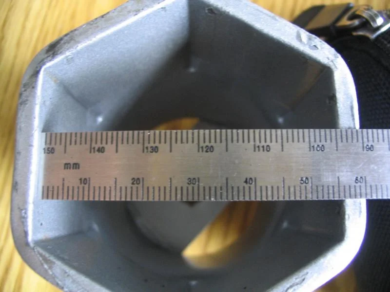

OK, the '94 FSM calls out SST 09607-60020 for adj/removal of (wheel bearing) adjusting nut. I have in my hand the SST. It measures 56 MM (2 & 3/16" SAE) inside tool diameter. I bought it at my local Mr. T shop and used this tool with no problems last time on my wheel bearings. The tool is marked: "oTc 09607 - 60020 - 01". So where is this "54 MM" coming from?
It comes from the size of the socket that fits the nuts. When the nut is that big and the torque that low, close is good enough, so it's entirely possible that a 56mm socket would work, which means that if a 54mm is too big for his nuts he's got the wrong size nuts on there, or the corners have been rounded off badly, or the nuts have been ground down.

OK, fair enough. Just for the record the SST is 56 MM or 2 & 3/16" as shown below, not 54 MM:

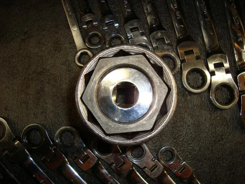

2 1/8" socket with a new spindle nut sitting in it, I will have to measure the socket to see what the actual distance is flat to flat:
attachment.php
Wow! Thanks for the quick reply. On the other hand the hub locknut is not ground down or rounded off. It's in good shape, it's just on very tight and I can't knock it off. I need a 52mm hub socket I think. I was just concerned if this was normal or not. I was not sure however I thought from 75 up to 97 the hub socket was the same 54mm.
Thanks!
Well, looking at the pic above your reply, their might be 2 mm of slop between the nut flats and the socket, so a 52 might fit tightly. I routinely pre-torque my wheel bearing nuts to (over) the suggested 55 or so foot-pounds to seat the bearings with a normal 2 1/8" chrome socket (Craftsman) and it never feels like it's too big or is in danger of slipping. If I were in your position, I'd order a new set of nuts and just crank on the 54mm (or 2 1/8", if that's what you have) until those babies came off. If they survive, toss 'em in the trail spares box and install the new ones. Or, you could find a 52mm (or 2 1/16", if you wish) and let us know if it fits.

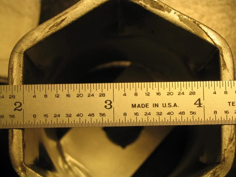

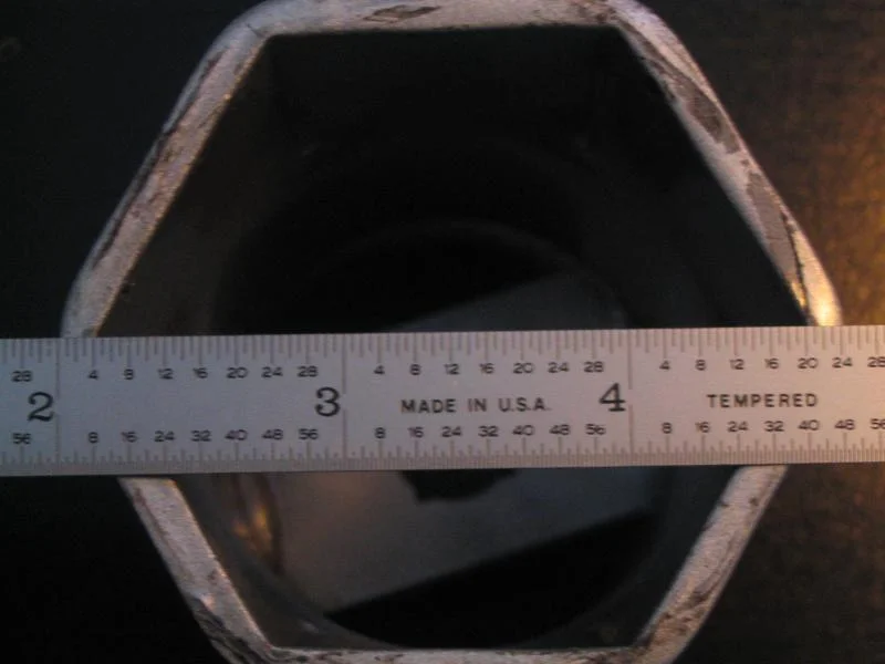

It doesn't surprise me. How many times do you get a tool or an item that spec'd as one thing and you measure it and it is actually different than the specification, and yet for some reason we go by the spec. I re-measured the SST, both inside (at flats) and outside at widest point. This time using SAE or inches. Pics below confirm:
Inside (flats) = 2 & 3/16"
Outside (widest point) = 2 & 25/32"
