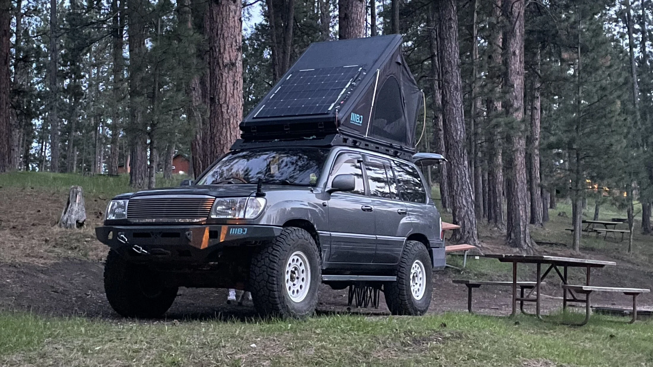

Overall, I am happy that I did the body lift. The lift itself is a quick job. I was in under 2 hours by the time I was lifting the body off the frame.
It's the OCD detail work that takes up a lot of time and turns a 3-4 hour job into a full weekend, but worth the results.
I had a little surface corrosion between the body and mounts so I addressed that before installing the BL pucks. Of course, followed up by cleaning this and that. Fab'ing the upper rad brackets, trimming and fitting the front and rear bumpers to fit properly take a bit of time. followed it all up with a pinch weld beatdown, painting, and sealing the areas for a clean finish.
I capped off my BL with a fresh set of Pizza cutter 35"s on 17x8 30et FN LC100 edition 5 stars, and an alignment.

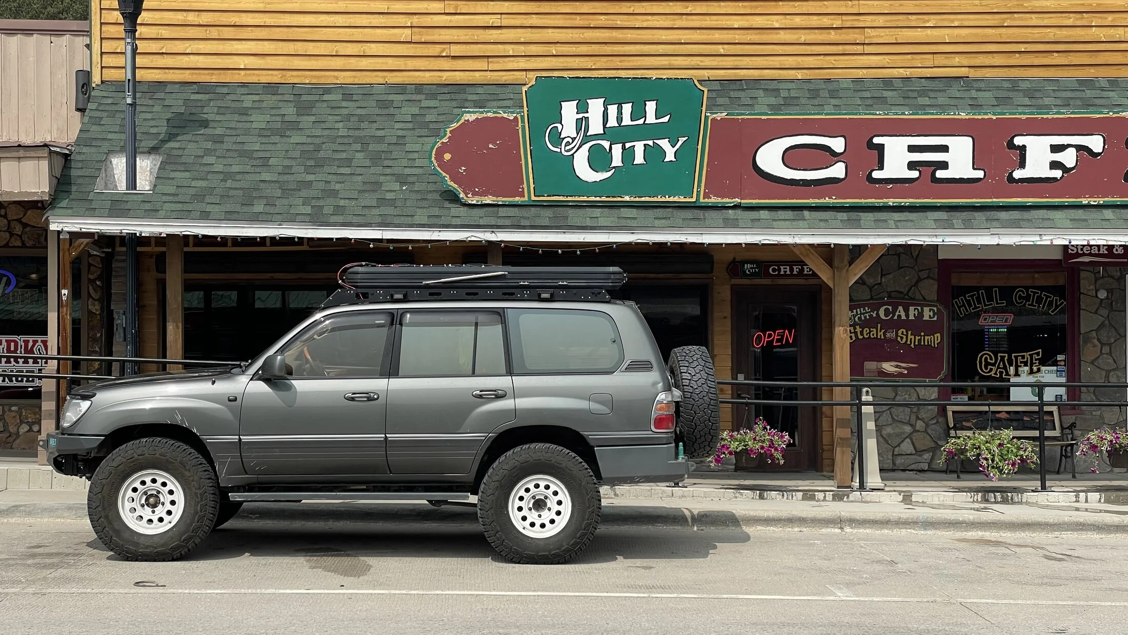

The following pictures show the final results.

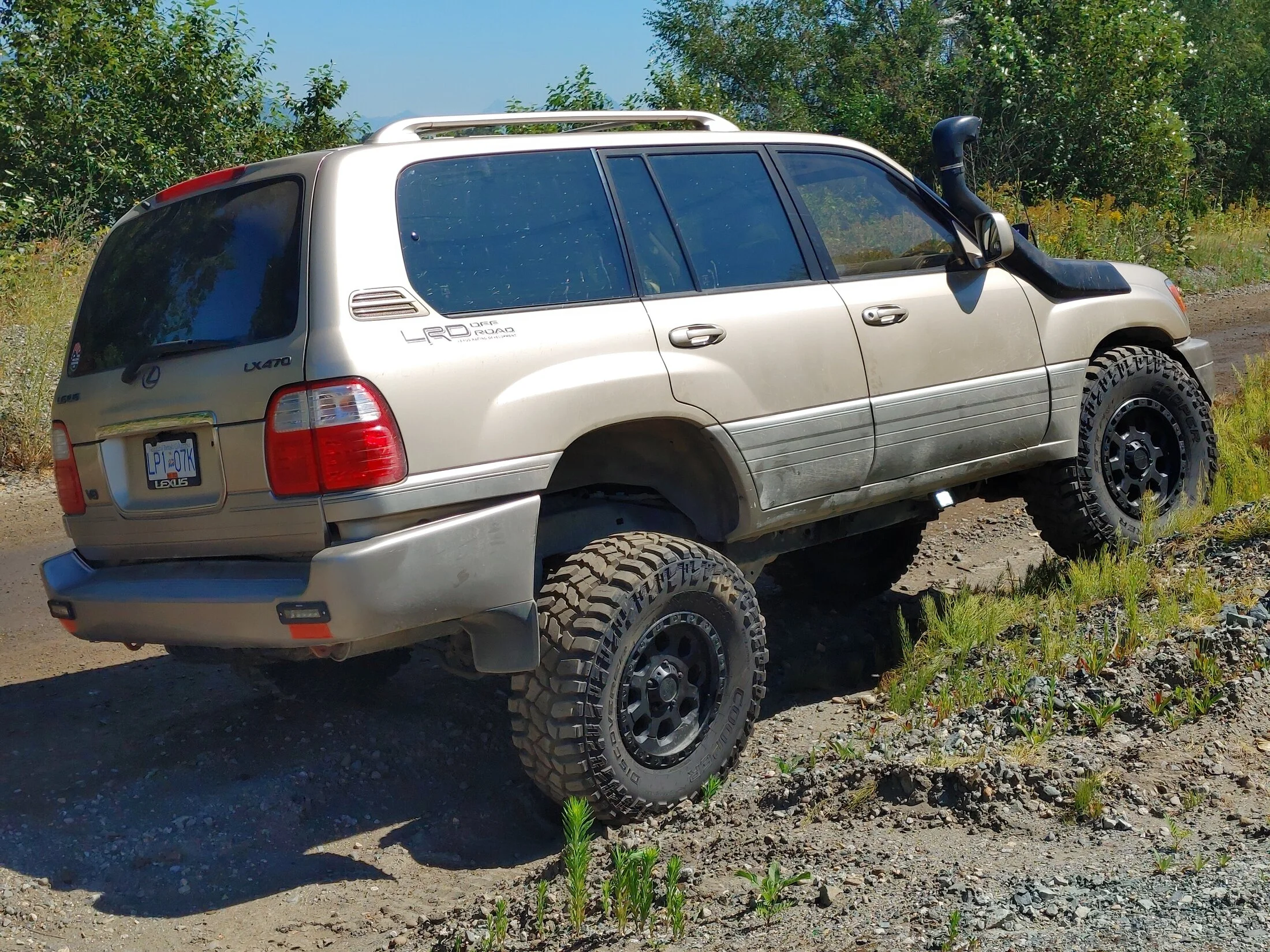

See the gap on the bumpers, i think nobody have posted a good picture showing on how much they stretch.
I run 295/75/18’s, Reindex front OEM TB’s, 1.25 wheel spacers and 2860 OME springs plus the 1” body lift all the way around.

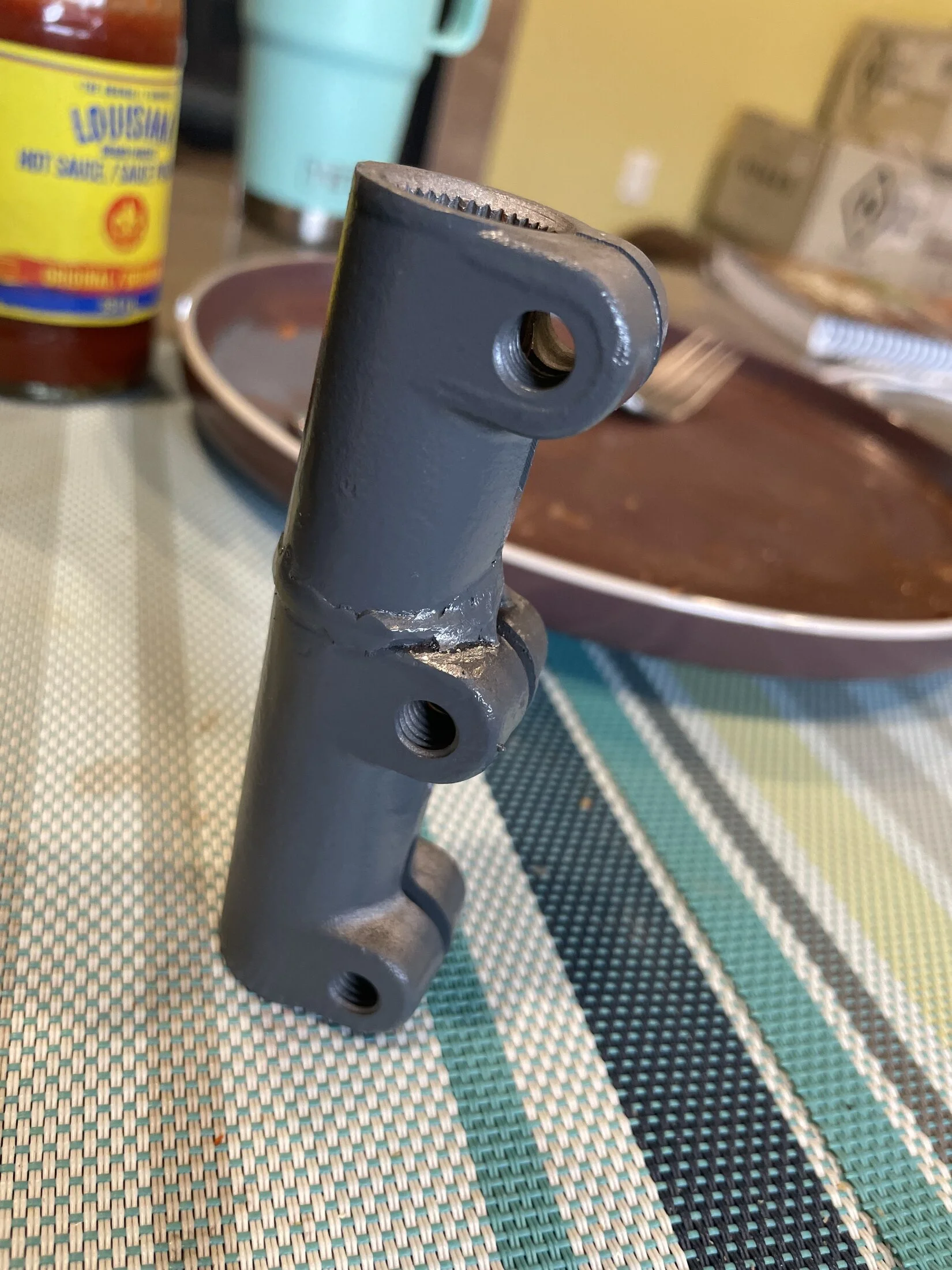

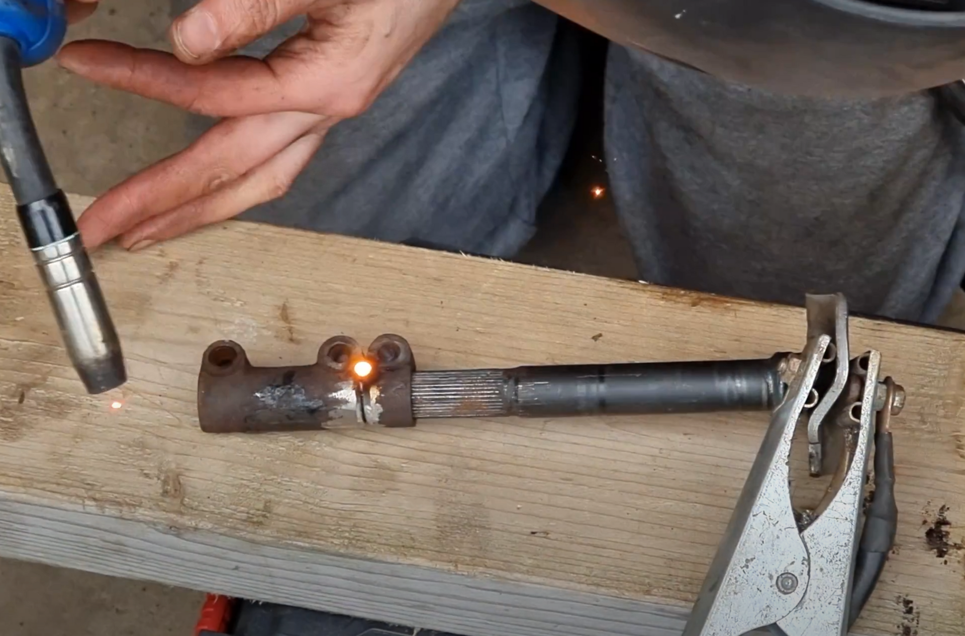

In case it helps, to help with my steering column I purchased a second "yoke" from Toyota and welded it into a longer sliding extension. I purchased very expensive aftermarket steering extension from New Zealand and it was awful.
Part number from Toyota was 45219-60080.

I went slightly different route, but nearly the same plan.
The available steering extensions work, but have some caveats, modifications required, or actually do not work at all.
Flat out offroad - offers ‘105/100 steering extension’ incorrect, it only work on 100 with telescopic steering, firewall modification, placement at upper end of engine steering link. And, requires re-clocking of lower link to rack spline 45°. Fits 105 at lower link / rack, requires re-clocking 45°. Does not fit 100 with non telescopic steering.
