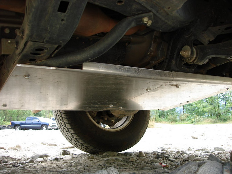

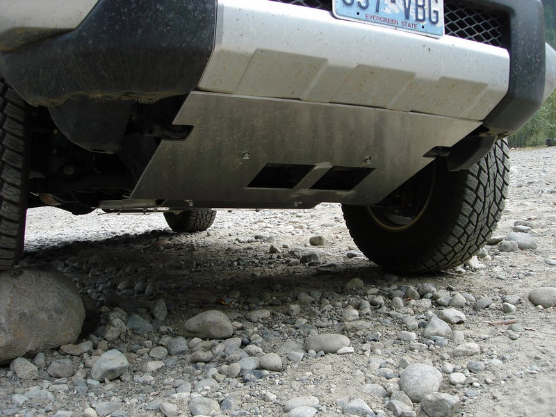

Currently there are no alternatives available besides the stock plastic stuff. There is an owner that made his own skids:
I saw that vehicle last Saturday at the Trail Team even at Reiter Trails in WA. state.
Him & his dad will be fabbing these up for others before to long.
The skids looked very beefy.
