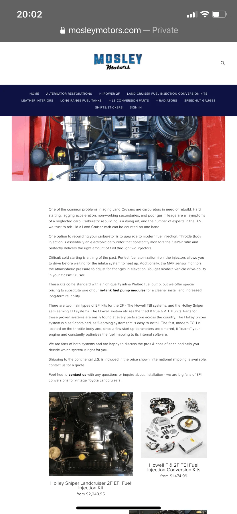

Noticed Mosley Motors offers both Holley and Howell. Might want to reach out to them as suggested and let them convince you why Holley $800 more is worth it.
Ease of install/tune would be large part of cost of ownership to consider as well.
