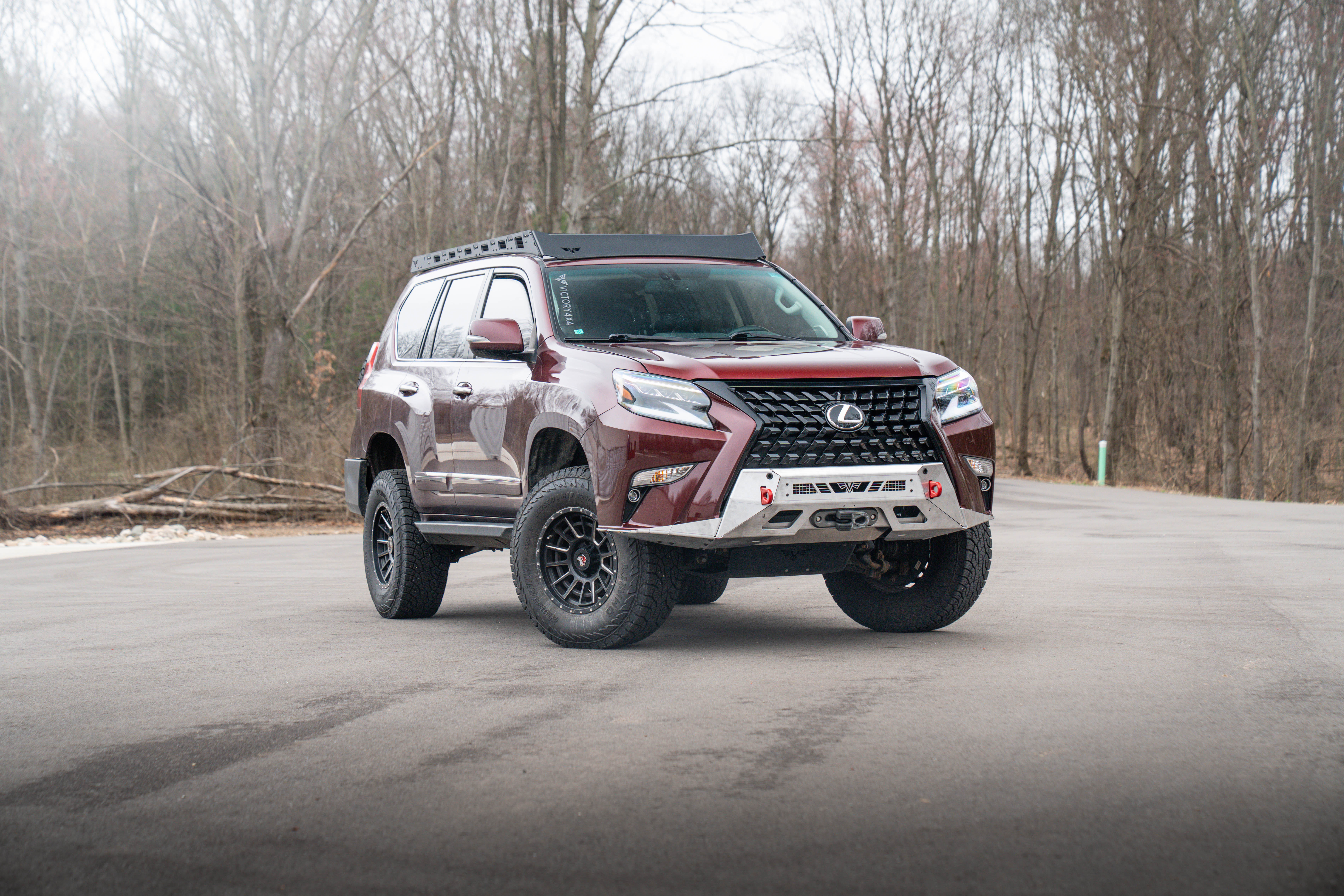

I have a 2019 Lexus gx460, 115k miles, well maintained, lightly modified, daily driver.
1.5" lift: Bilstein 6112s and 5110s: Standard weight Bilstein spring up front with an Eibach load leveling kit in the back
KMC Wheels: Cooper Discoverer All-Terrain 265/70R17 Tires
I am not building a crawler or overlander, I'm bulding a comfortable daily driver that can handle big road trips and get out in camp in primative areas.
I have developed a clunk in the front end, Lexus replaced the steering rack for me under warranty. L certified warranty expires in 5 days.
The clunk is still there and Lexus is saying its the impact bar hitting the frame, possibly due to a broken spot weld. This is insane to me as the car has never been in an accident, original bumper cover. L certified warranty will not cover it. Lexus is quoting me $1200 to install a new impact bar. This is not an option for me. I can do this myself. This pisses me off that they wouldn't cover something like this. Also the car is taken apart right now so they will put it back together with existing part for $0 but want $800 in labor to put it back together with the new part ($400).... how does that make sense?
My options:
1. Have them put it back together and drive it as is until the sound annoys me enough to address it.
2. Buy a new or used impact bar and do the work myself.
3. Buy a hidden winch bar from these guys and replace the impact bar with this and the winch in later, the steel section shouldn't be too much heavier than stock but ceretainly looks more stout.
I don't want to add so much weight to the car that the springs compress so a alumnium or steel full bumper is out of the question. Plus the cost is around 2k for this route.
img_5629-webp.3978031

I'm leaning towards this HK offroad hidden winch, seems like it sits a little higher than LFD which avoids the odd cuts on the lower grille boarder plastic.
LFD:
HK OFFROAD:

Option 3!
Maybe even get one of those lower front like the Victory 4X4 Blitz bumper
You can get it in aluminum, increases your approach angle and still keeps a somewhat stock look without screaming "OVERLANDER!!" (what that last point really hit home for me with my rig...R²M 2013 GX 460 Overland Build)
Have the LFD hidden winch mount. If you do a little snip snip you can push it back for better approach angle. It also protects the lower part of the radiator quite nicely. Here is a pre-rhinoplasty pic.
I'd go for option 2 unless you have a need for a winch.
The weight of the winch, mount, cable, plus the expense of wiring etc. would just be dead weight most of the time. Realistically you're looking at about $1k and 150lbs or so when all is said and done.
You could probably find a impact bar for free from someone who's installed a full bumper. I'd give you mine since it's just taking up space in the garge but shipping would probably be prohibitive. Changing it out is pretty easy to DIY, for someone who's done it before it's probably a half hour job. I can't imagine a broken spot weld being the issue since the bar is aluminum but maybe it's a loose nut or something like that.

I slid my LFD all the way back, to get better clearance.
These trucks are so much more forgiving to wheel with a viper cut.
do you have pics of mounting? what do you mean slide all the way back?
mine is mounted to where the crash bar was- i didn’t know there was another way to mount without cutting the frame or the mount.
The LFD mount is the same for both 4runner and GX, so it is two pieces and they have adjustable depth eith heavy duty hardware.
So if I get a bumper I can toss my LFD winch mount on the 4runner.
