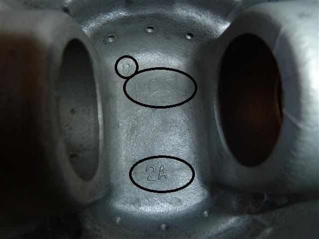

Hi all, I just bought an old 24v HJ61 that has supposedly 200k kms on the clock. I say supposedly as the speedometer looks like it had been disconnected and wound back perhaps, I pulled the dash to fix a gauge when I first got it and the speedometer connecting cable popped right out!. Is there any way to tell without pulling the head if it has been rebuilt with alfin pistons? I have searched the forum and have gleaned that the EA rebuild kits have pistons stamped with "2A" underneath, I will drop the pan and see if I can see any markings when I get home from work (I work offshore). Any other clues that you guys might have would be appreciated. I'm worried about the pistons dropping rings after I breathe a little more life in to it with more boost/ fuel. Getting real excited, bought a pyro, boost gauge off flea bay and now saving for the upgraded valve body for the a440f. I would hate to have those pistons come apart and tear it up! thanks for your help in advance...

I have a set of Alfin pistons also with the 2A stamp but not from EA. I still believe that they all (aftermarket) come from the same manufacturer.
That's about where you will see the "2A" if you go that route. All the best and keep us informed.

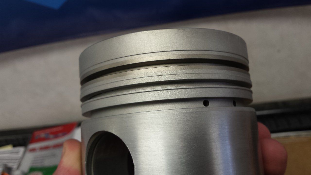

Reviving an old thread. I was just searching around to see if anyone has posted pics of the damage that is common in the stock 12HT. I have rebuilt 5 and all have had this damage. Its been most severe in piston 1 and 2 in the ones I have done, and its always most prominent on the intake side (also where the injector is). I think the condition is accelerated by neglected injectors. Sticky and leaky injectors wash the cylinder wall.
Rebuilding one now. Piston 1 and 2 below. This engine ran OK. Sounded a little off to me but I dont think most people would have noticed.
