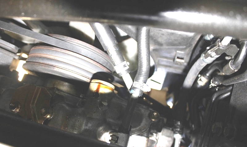

So, I got everything put back together. The oil pump seal seems to be leak free, but the main crank seal has a small amount of oil around it. Did I not seat it deep enough? I swear it wouldn't go in any farther, but looking from under the truck it seems to be sticking out alot. The new seal did seem to be a bit different than the old one so maybe that's normal. Does it just take a little while before it seals all the way?
By the way, I replaced the ribbed belts with OEM belts. Everything sounds much smoother!
Could you have put it in backwards? Don't remember mine sticking out at all. The lip side goes in towards the engine.
Its possible but I seem to remember it could only go in one way because only one side had a surface to hammer on. Looking back at some of the original pics in this thread it appears that The new seal does have an extra lip that the old one doesn't have.
Here's a comparison of the old and new crank seals from Zane's original posts. Looks like the newer one does have a larger lip which protrudes more.
Yep, I bet it is fine if it looks seated like this one above. Should be good to go. Clay
Sweet, thanks. I've been monitoring and it seems fine. Oil pressure is good, no puddles.
