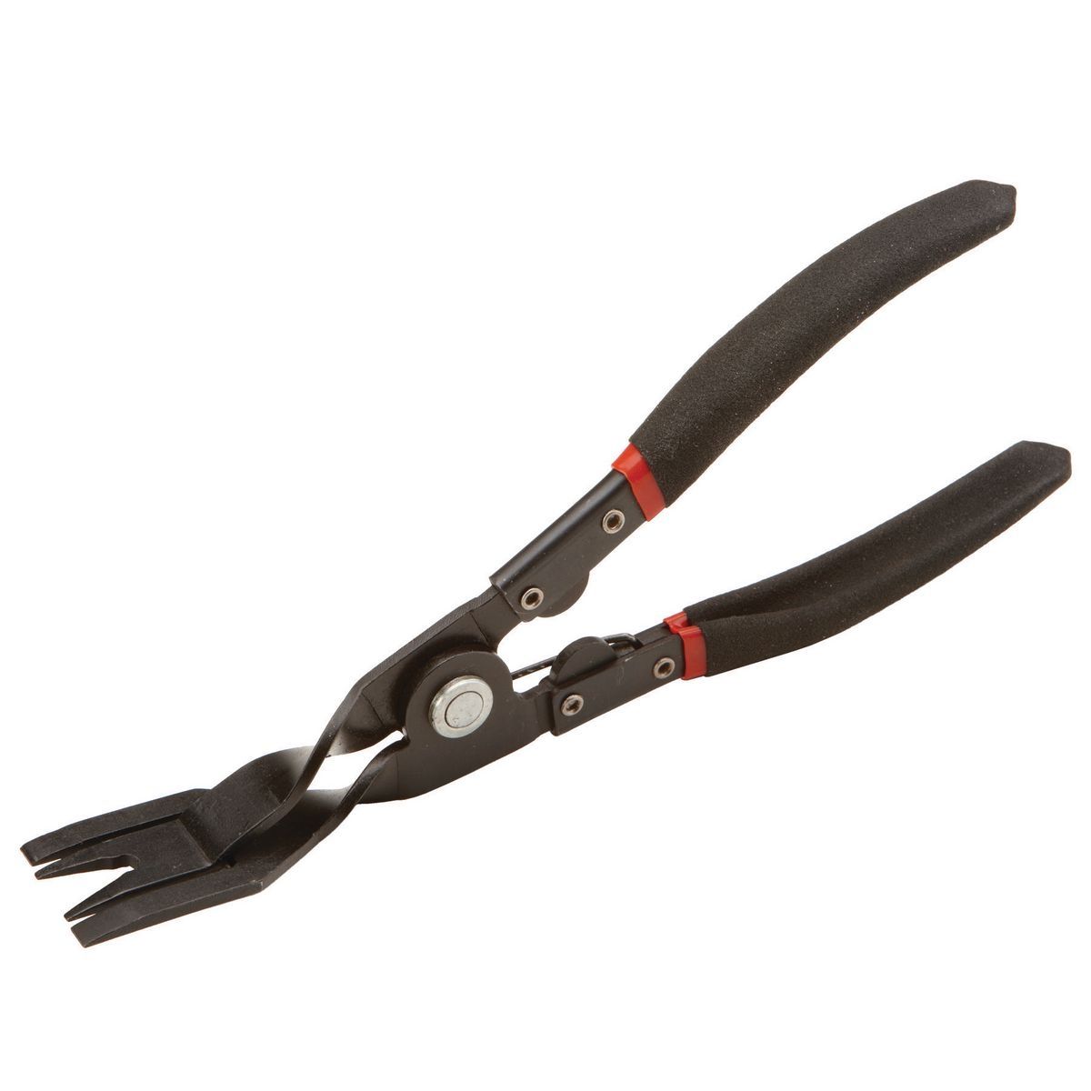

I think 'mud member @Taco2Cruiser has previously mentioned a trick he uses to remove them without damage, I think using a pick to depress the tabs. You might be able to search for more using his username.
It "seems like" you could slide a socket or something (tube) that is just a hair larger than the barrel of the white clip that would compress both tabs at the same time. For the couple of bucks involved, I've just never bothered.
Those stupid fasteners are a PITA, and shame on Toyota for making something that is almost impossible to remove without breaking it.
I have gotten a few out when I was doing my suspension. If you can get to the back side with a long pair of bent-nose pliers and squeeze the "catches" at just the right spot, they will come out. Make sure they are as clean as possible first, spray them down well with SimpleGreen or some other cleaner, then blow clean with compressed air. But some are just unreachable, so you have to break them.
