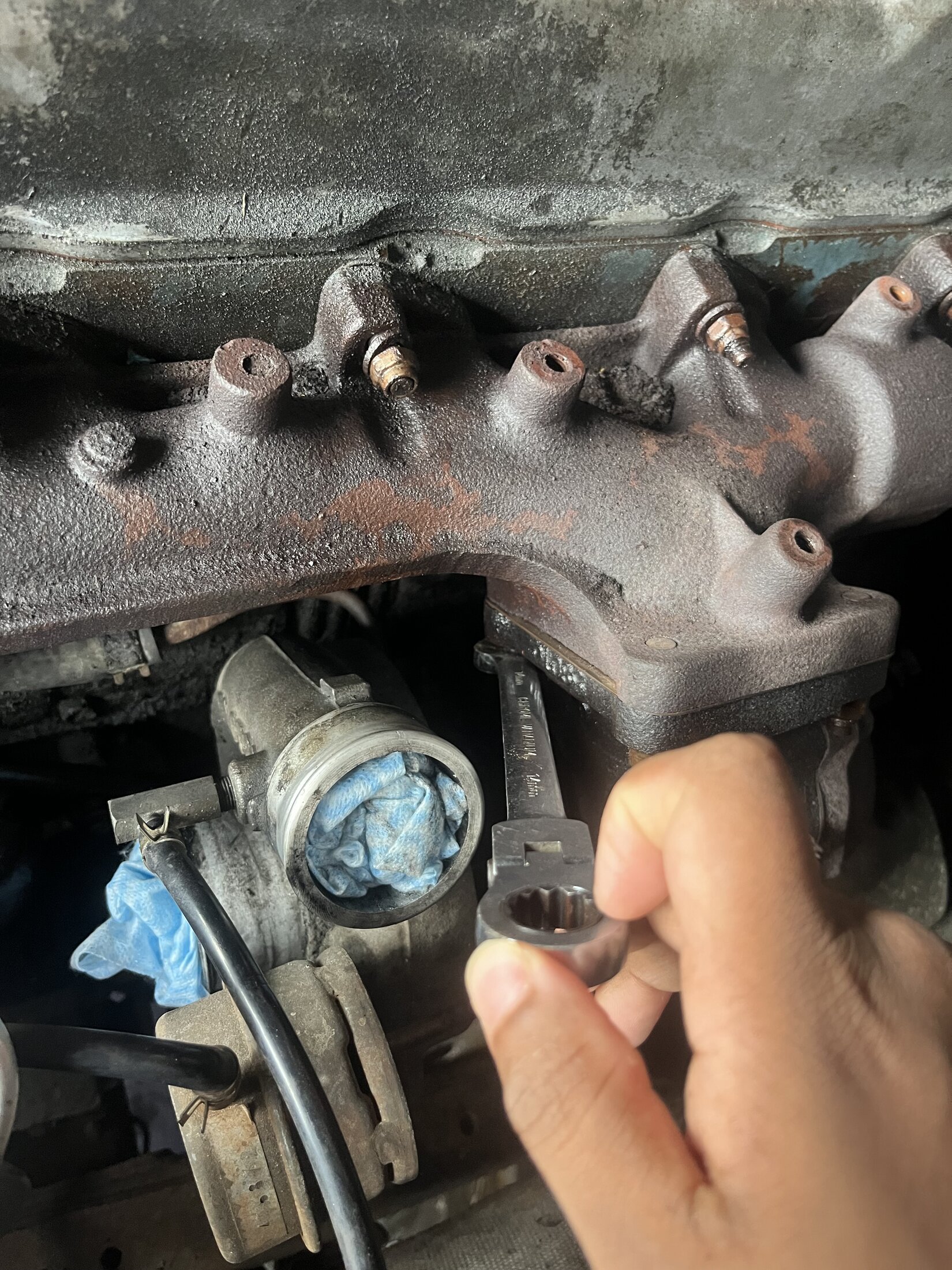

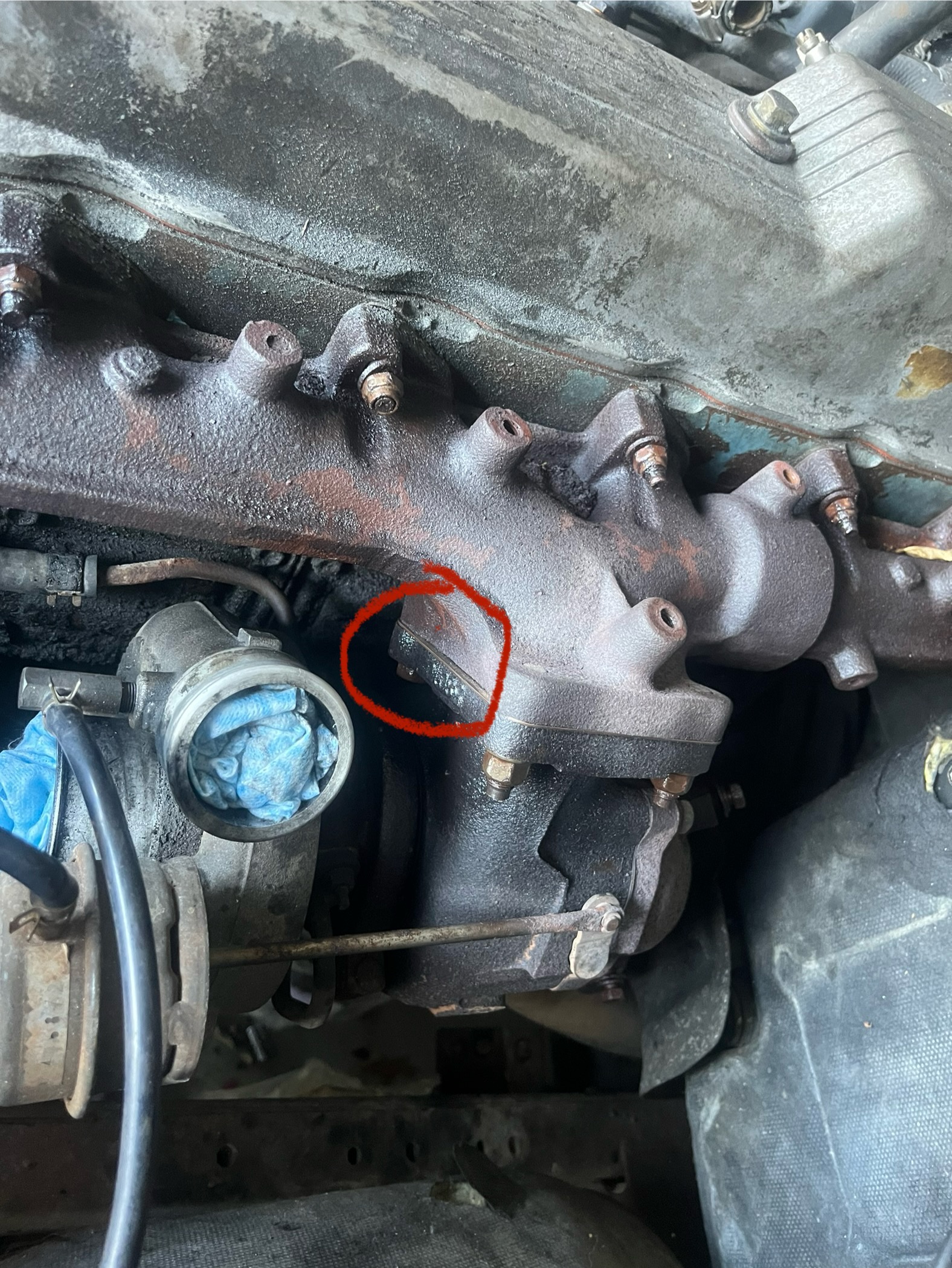

On to taking the exhaust manifold off. Struggling to take one bolt off. It’s one of the four between the turbo and exhaust manifold. Three of them were studs and the nuts came off with a bit of wd-40 and force but the last one is weirdly, a bolt. I have a feeling that someone previously broke the stud and put in a bolt. Will put a photos below. I can put a wrench on it but won’t turn an inch (have soaked it in wd-40 for a week). I’m scared i will snap the bolt. Any advice is appreciated

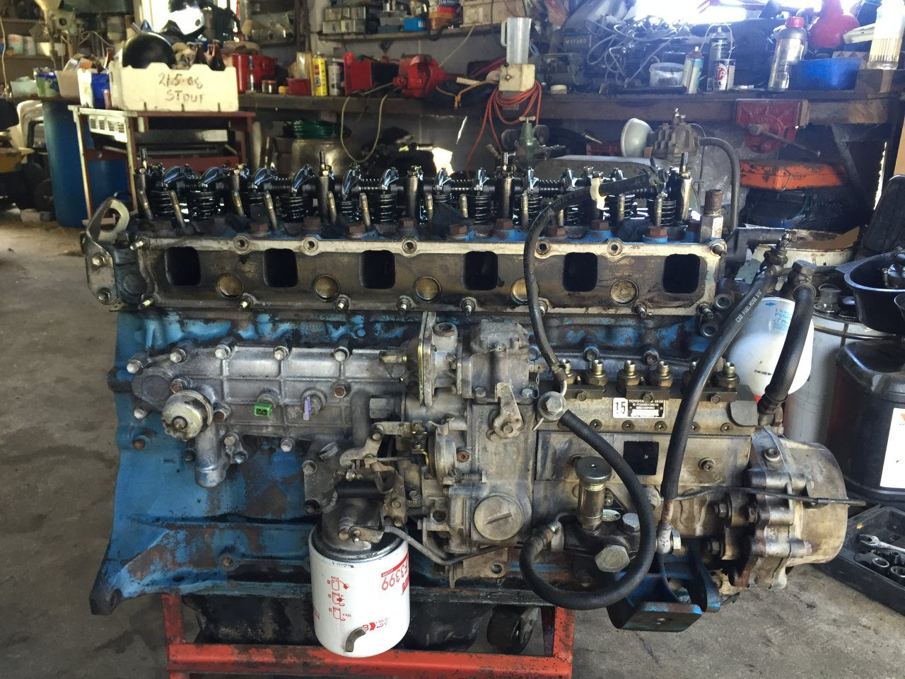

just read it now - you're in Auckland - that's 5 hours away from me .... I might pop in some fine day when back in AKL. Good to see projects grow.
too bad the box with stout written on it is not there....but down the road from you !
