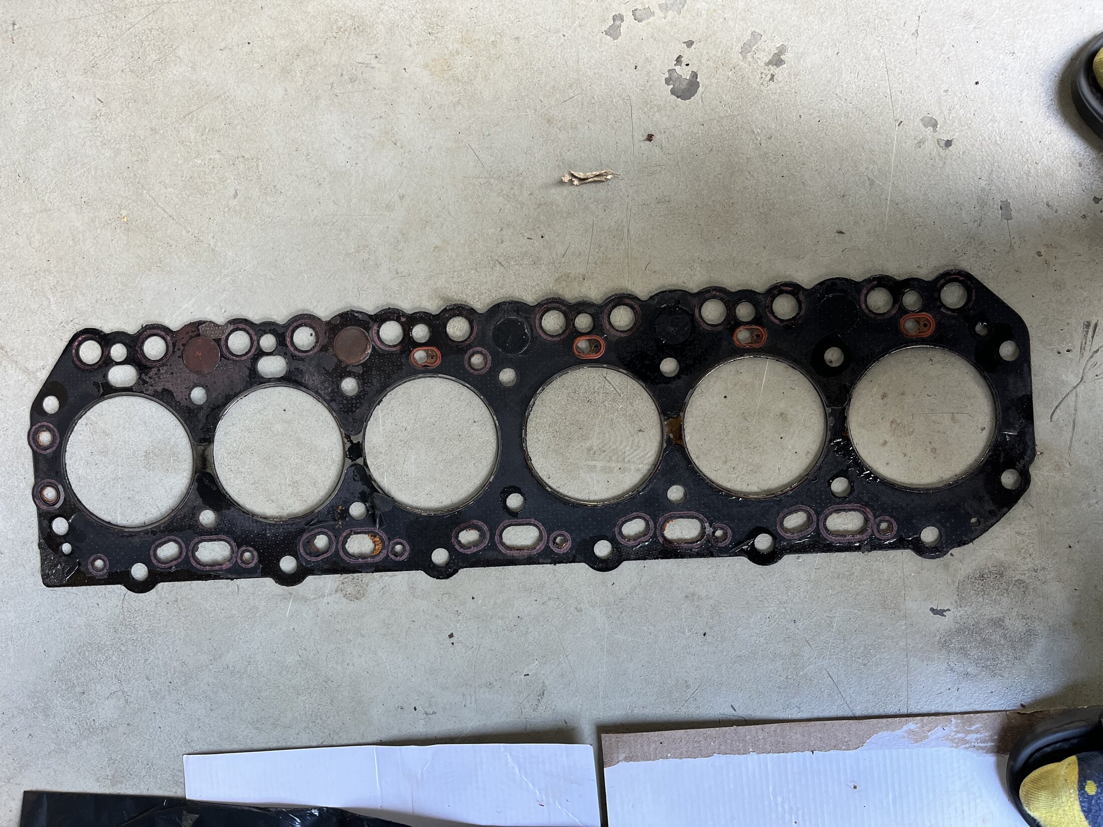

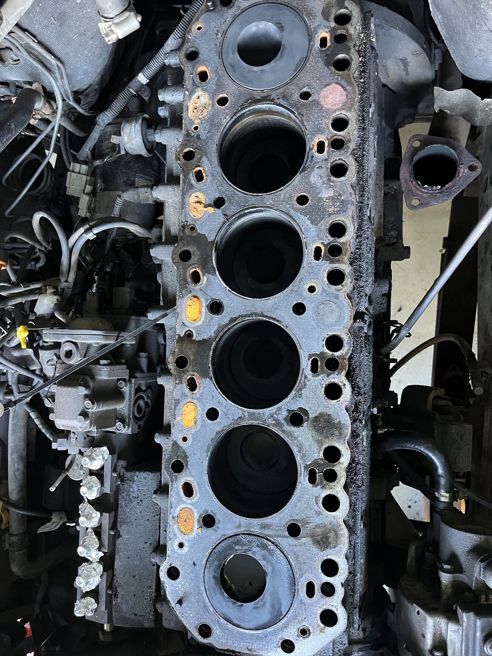

got the head off
So, what are we looking at ? What is the verdict ? Any head (Gasket) specialist araound here ?
Teltail signs ?
Teltail signs ?
i’ll put up some better photos. I’m no expert, i’m thinking of taking it to a engine shop to get an opinion and get the crack test done.
Some of the head bolts are going right through the water jacket and are protected only by thin, pressed in steel tubes.
Let them check those. Not using antifreeze ( as common with older engines) with its anticorrossive properties let's them rust. Mine were rusted through when I got my 12ht and the coolant went in the threads and around the gasket surface...leaving a big rusty mess everywhere.
Also run a new sharp tap down the head bolt threads in the block... I got a lot of grime and rust out, in fact my head bolts bottomed out on top of the unpleasant stuff. Might not apply to every engine...
Worth checking anyway.
Yeah for sure, will keep that in mind. Will be taking the head to the machine shop to get it properly checked out. Hoping its not a cracked head otherwise im in big trouble...... very nervous for the result (i was hoping i would see a blown gasket, but i dont seem to see anything obvious)..... happy that i managed to remove my first cyclinder head though (learnt heaps along the way)
UPDATE: the machine shop did a crack test on the head and they said there are no cracks and its all sweet, according to him its blown head gasket. He said he will face the the head and return it (good news). On the hunt for head bolts and a head gasket now. Does anyone know any good places? brands? or any tips/tricks for when im putting the had back on? Cheers
