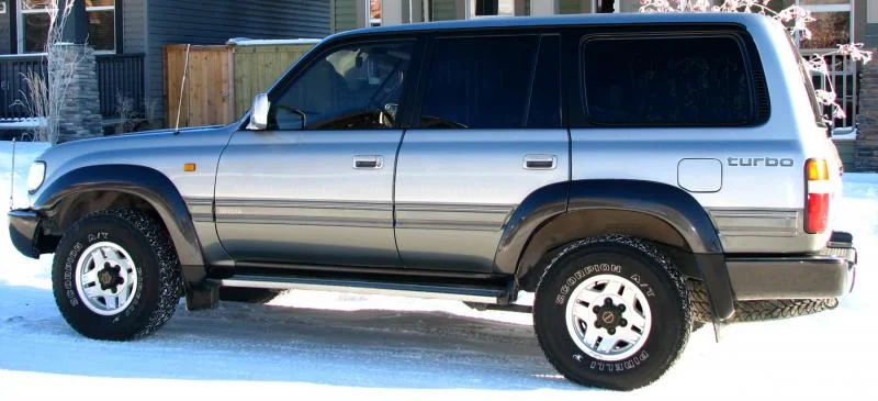

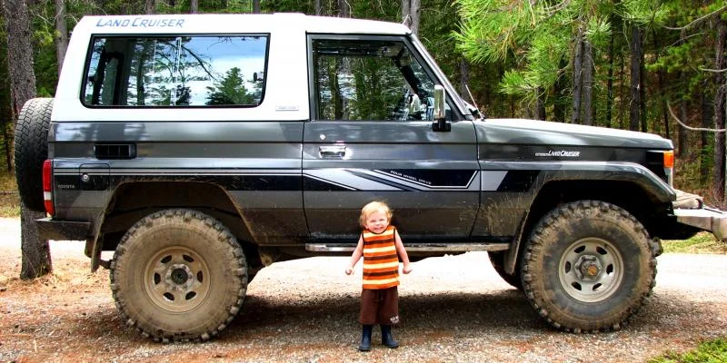

I have made posts before saying if anyone needs graphics of any sort for their vehicle I can do it. I actually specialize in vehicle wraps but also factory-reproduction decals, using exact colors and sizes. My BJ-74 had the nasty red and gold decals on the side when I got it, one of the 1st things I did was reproduce the factory deacl kit in a more "appropriate" color... turned out nice. My HDJ-81 came with the super nasty burgundy fender flares and burgundy 2 tone - my wifes only stipulation when I bought the 80 wasI had to get rid of the burgundy - cheaply. So I wrapped it in a 3M metallic charcoal. For easily half the price of paint. The 3M vinyl is warrantied for between 5-9 years... no pain in the ass like painting...
Also if you notice my 70, I camo'd it with a metallic vinyl that was just off from the paint color... its a real amazing alternative to paint that has no limits, for our wraps we can print anything at photo quality ( for those guys that want a wolf howling at the moon at sunset on their hood )...

the BJ-73 before...
for the factory stripe I used another of Toyotas designs, I liked it more than what mine came with.
here is my HDJ81, just picture everything thats is now charcoal as burgundy... it was ugly. Sorry I dont have a before pic here at work... should I be working?
