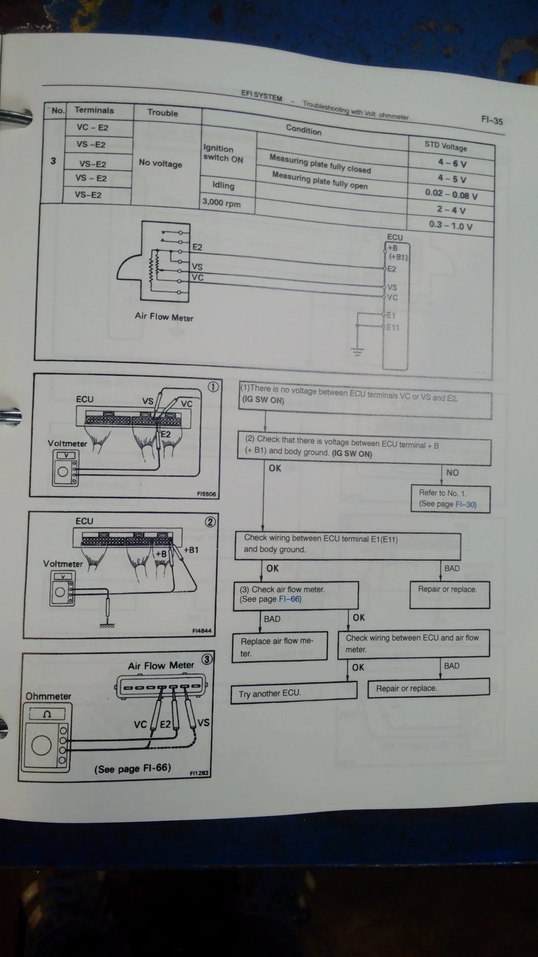

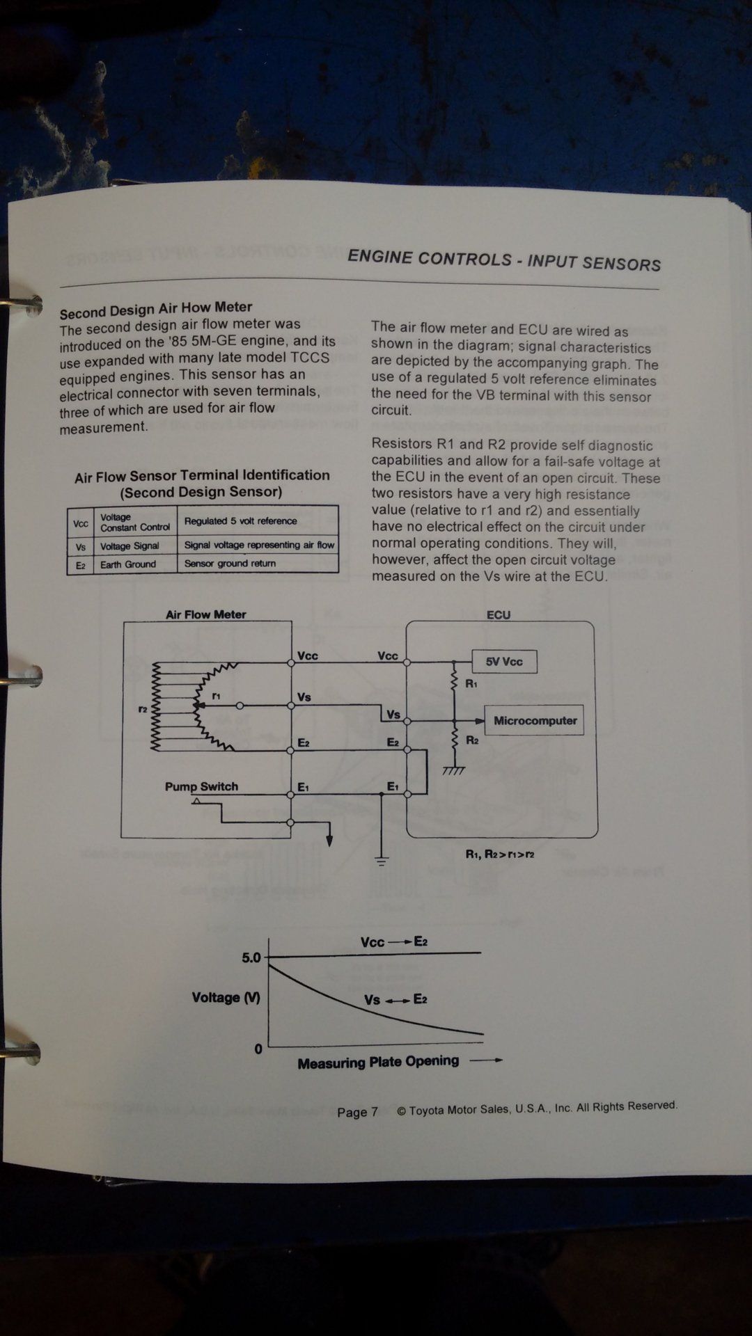

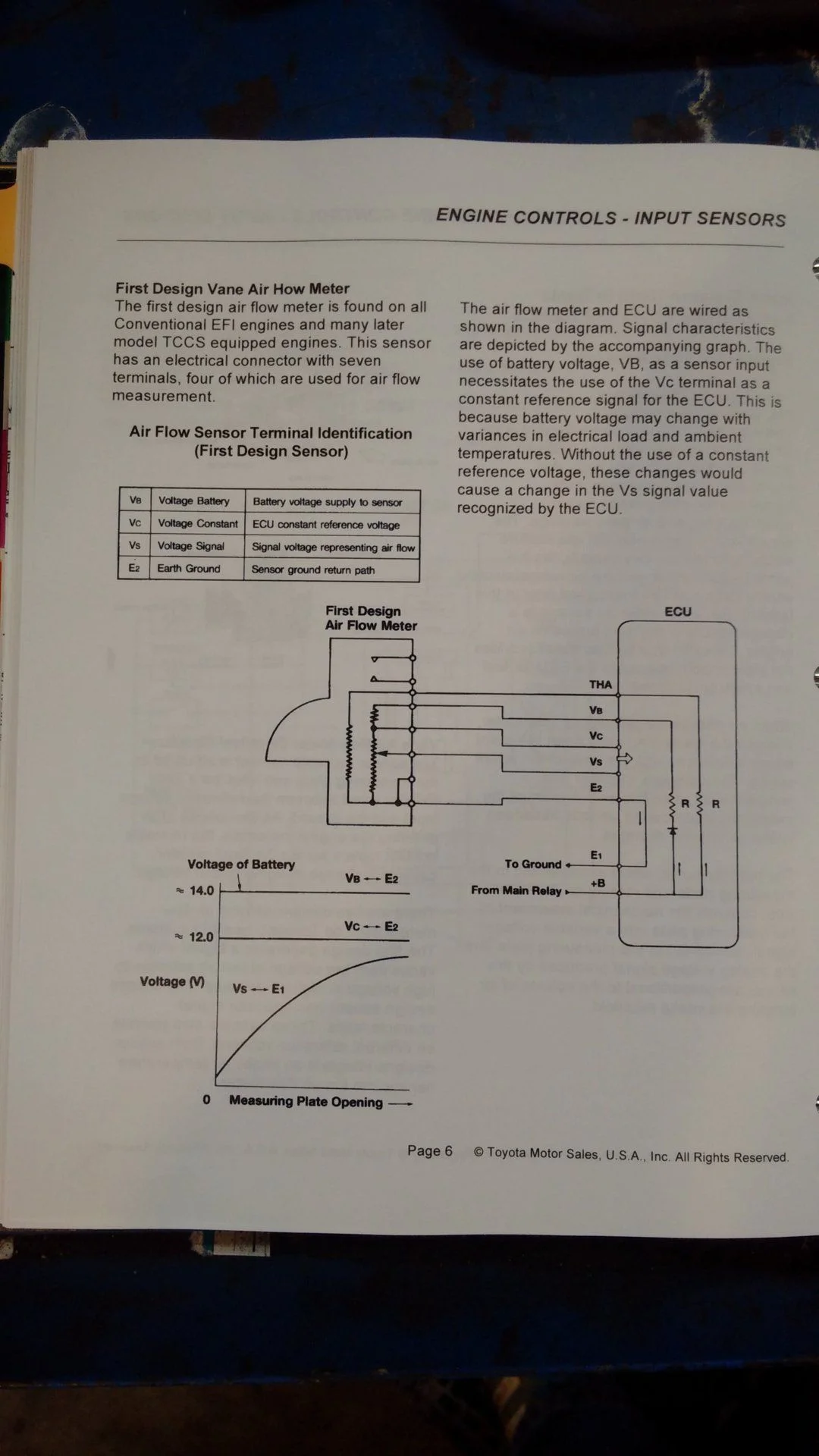

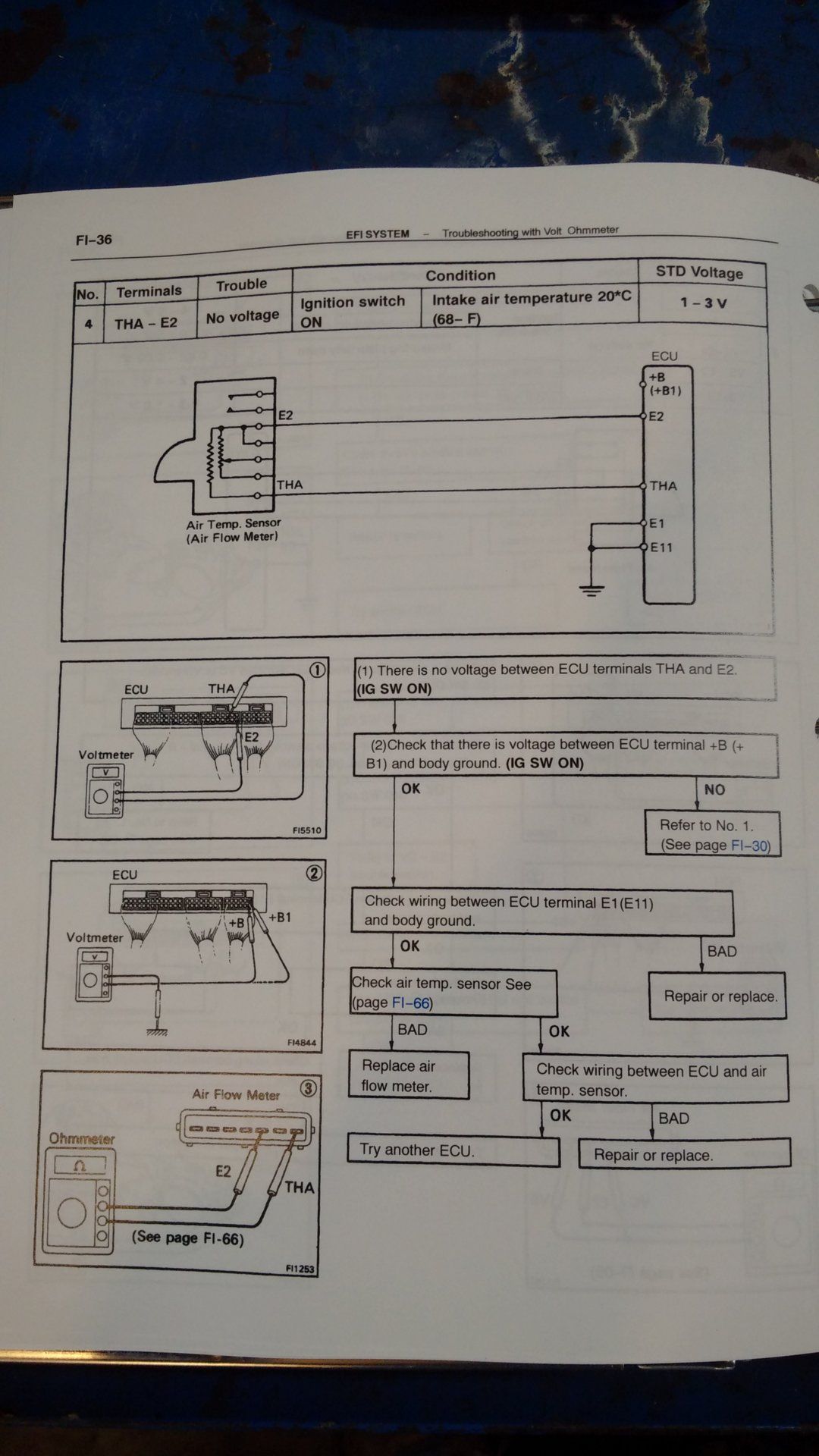

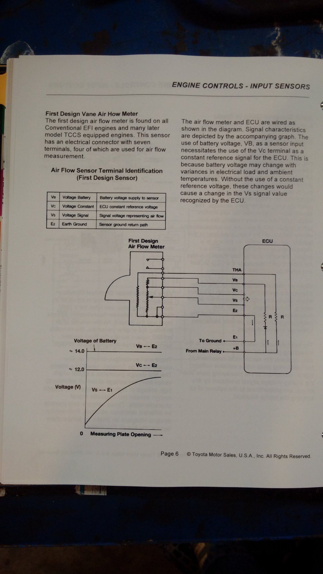

Absolutely no need to clean this unit. It is not serviceable and Toyota does not make them anymore. Rockauto lists CARDONE 7420105 as a remanufacture replacement for mine ('91 with a 3FE) and to nobody's surprise it is unavailable. The vane door/hinge is very delicately balanced to accurately relate to the volume of air flow. Do yourself a big favour and leave it alone UNLESS at trouble code is pointing to it directly. I will scan the pages from the FSM and post tem when I get home later today. Tinker with it at your peril or go for it and afterwards you can park it on your front lawn and plant some flowers in the headlight pods :)

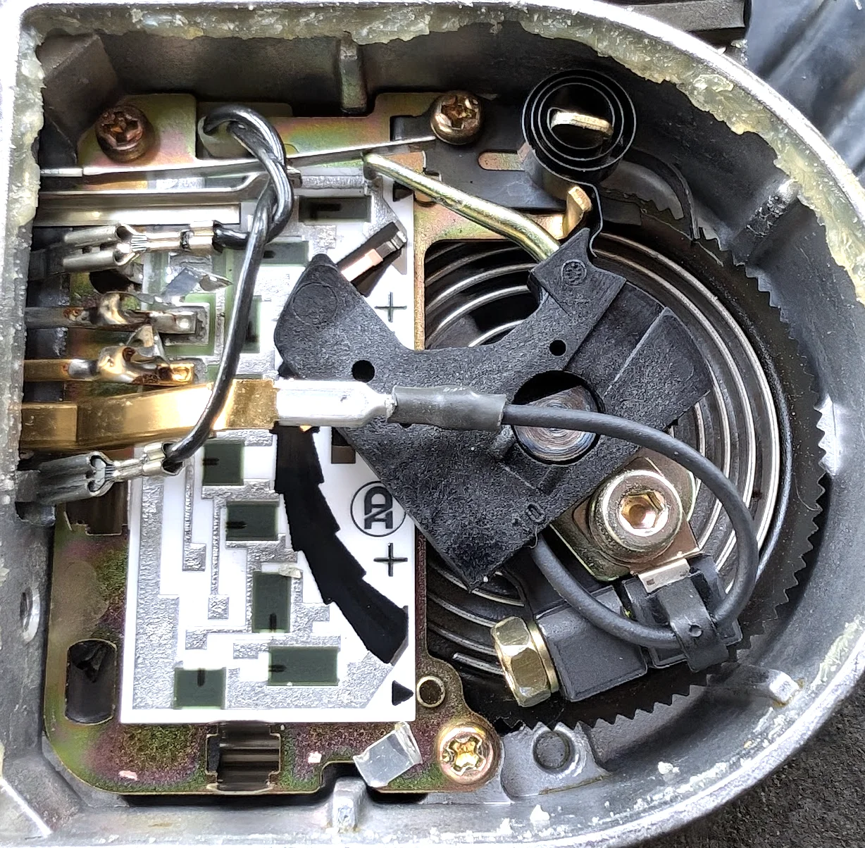

Thanks. It's a shame there isn't yet a better aftermarket solution. I popped open the cover, looks like we will be able to just carefully solder the bits back together and it should work. The truck owner is planning to get a replacement anyway, as a spare (as you suggest).
I was able to resolder this recently and I'm no pro at it. I went very, very slow....
