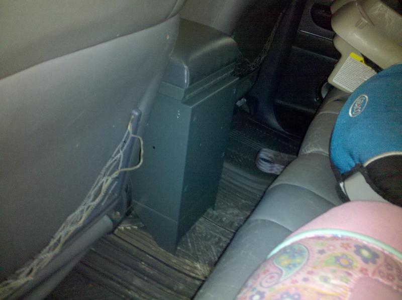

here are some tuffy photos
you'll notice that I don't have the shifter surround (darn PO) so I was able to snug my tuffy pretty far forward.
Still waiting on the cupholders (need to paint them) they'll go in back as the shifter doesn't give me room in front. Eventually I'll get a shifter surround built, and include at least 1 cupholder there as well.
If you look at the last photo in the original post, you will see the rear "legs" which came with the console. I understand that older Tuffy units didn't come with them, but do now. They are approximately 4" so the console just happens to sit level with the 80's floor. It creates a 1" gap between the rear stock console mount and the bottom of the Tuffy onsole, hence the 1" square tube.

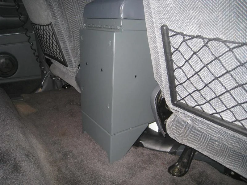

Just completed a similar install on my 94. I did manage to do it in a way that does allow the rear seats to be folded up completely. Only usage limitation is that when the seats are folded, you can swing the top of the console all the way back so it stays open on its own. It opens fully but just not past the tipping point because the pad on top bumps into the folded seats.
What did I do differently? I moved the wiring harness that is tied to the back side of the cross member to the top. Then I secured the Front of the tuffy to the cross member with the use of some angle iron. I was able to use the existing threaded holes in the cross member and two of the existing holes in the front of the tuffy (for use with the cup holder).
I did have to drill two new holes in the bottom of the tuffy to secure it to the rear bracket of the old console. Used a space (1-3/8" in my case) to level it out. I think I used 50mm bolts.
The next step was to attach the cup holder. It isn't possible to put in the planned position because the bottom front is blocked so I have installed it on top of the small slot/shelf/whateveryoucallit that I guess was designed for coins or pens (things that will only make irritating rattles anyway). I used the existing large (5/8") holes in the cup holder but had to drill two new holes in the small shelf to secure it. Pretty easy really. Hardest part was just making sure the holes were in the right place.
Very happy with it. Color is actually a great match for the grey interior even though the camera flash doesn't help it appear so.
btw, I don't think my floor looked any better but I did this after tearing out my carpet and doing a full soundproofing so was as clean as it will every be when I took the photos...
Photos didn't upload (too impatient to notice that the image upload failed) so here they are again...
Also, should have mentioned that this did leave a small gap between the cup holder and the shift cover, about .25". Not very obvious unless you are looking for it but someday I'll put something over it to finish everything off (plastic or aluminum plate).
ps. thanks to IronYuppy for the motivation! :beer:
and for those of you who don't believe the rear seats will fold up... they do touch as you can see but not enough that you even have to really push them down. I imagine if you put them up and down 10 times a day, you'll begin to wear the material on the back of the seat but I don't think it is a concern even if you do it once or twice a day.

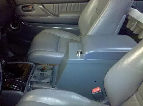

Just got my Tuffy console the other day and have it all set to go but need to wait for 1" square tubing to mount the way described in this thread.
Here is 2 pics of the basic setup in the truck. I find the gray to match pretty darn well with the gray leather.
