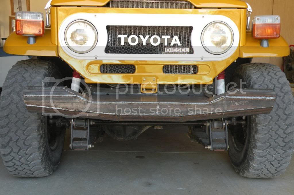

Been working on my front bumper this weekend. I was going to just use a piece of 2"x4" square tubing and put a bar on the top, but everybody does that. So I started drawing up a design that accents the lines of the front of a 40. I really like the Hanson offroad bumper and the old 4plus bumper with the forward swept brush bar, so I came up with my own design with a few angles and a bunch of welding on my part. Still need to make the end caps and then bend up some tubing for my brush bar. I'll take some more pics as I get further along. Now I just have a bunch of grinding to clean up all my joint welds and make it look like it was formed in this shape.

Thanks Don , looking sharp!
