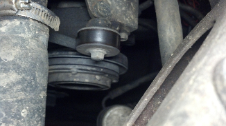

OK, I am missing something here, or as my Dad used to say "if it was a snake it would have bit you by now." The top pic is the compressor from above, I can see two short pivot bolts on the bottom, and on top is a long bolt going to a "slider block" on the arched bracket, secured with it's own (clamping?) bolt.
The bottom pic is looking up from below, at the tensioner. There is the tensioner center bolt, I don't see any long bolt there. Also, right now the tensioner is loose and spins by hand, is not even touching the belt.
Please point me to the righteous path of belt tensioning! Thanks, RJ
the wheel in the bottom picture keeps the belt from flapping around too much and falling off as the compressor turns on and off, but it does not set the initial tension. The you can see the bolts in the top picture. The tension adjustment nut (red arrow) and the lock nut that must be loosened first (yellow arrow).

Many thanks, that is exactly what I needed, confirming what I suspected.
Complete procedure as I did it. Confirm from the two pictures above that you have the exact same AC compressor config. These pics are from an 87 2F US FJ60. All bolts have 14mm heads.
  1. Loosen the two pivot bolts on the bottom of the compressor. I used a 1/2 ratchet with a deep socket, no extension.
  2. Loosen the slider block bolt (yellow arrow in above pic.) Same 1/2 ratchet with deep socket.
  3. Turn the long adjustment bolt (red arrow). Clockwise tightens the belt. For ease, I used a 3/8 ratchet, standard socket, and 18 inch extension to bring the ratchet up high where I could more easily count turns. It doesn't take much to noticeably tighten the belt - 1/2 to 1 complete turn may be all that you need.
  4. Tighten the slider block bolt (yellow arrow in above pic.)
  5. Tighten the two pivot bolts on the bottom of the compressor.
