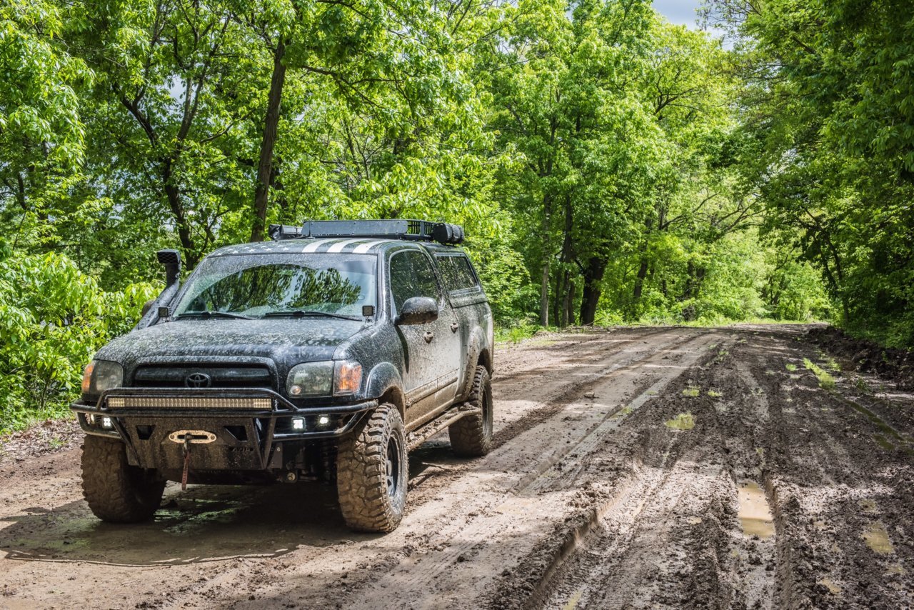

just one build
not mine... @FirstGenTRD4x4 2006 DC Offroad / Overland Build

That is a bad ass rig for sure and he's doing rowdier stuff than I'd be getting into. When you are driving 20+ hours from home you tend to dial it back a smidge. ;)
