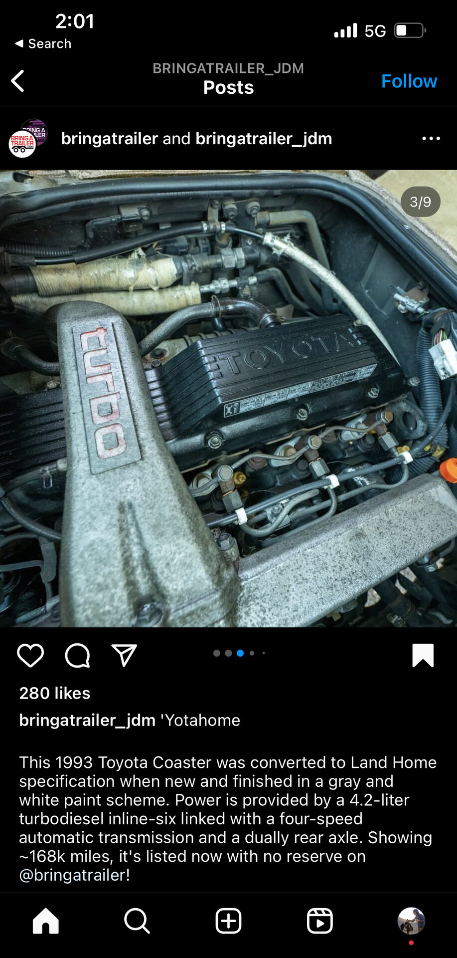

Is this an actual factory 1HZ-T? Perhaps this will quiet the naysayers who don’t think such a motor ever actually existed.
EDIT: realize it says 1HD-T in the description but the valve cover looks 1HZ to me. Thought 1HD-T valve cover was smooth/no ribs in the casting. But I’m far from an expert on such things!
