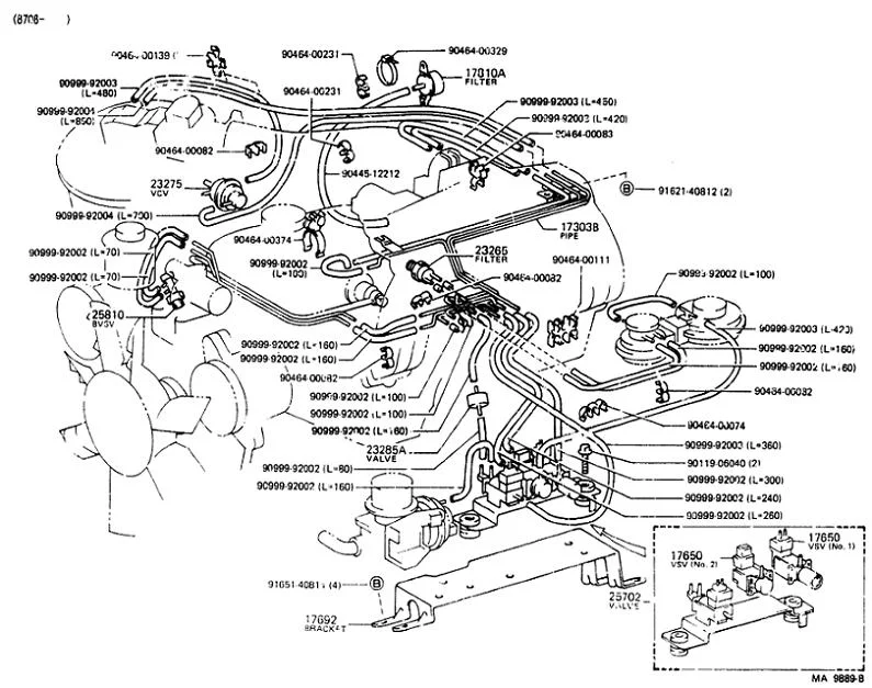

I want to replace all the vacuum hoses in my FJ62 3FE. For any who have done this, how many feet of 3.5mm and 5.5mm (correct?) do I need? Did a search and couldn't find an answer. And couldn't find a kit on any of the sites...which they should sell btw.
Thanks all.

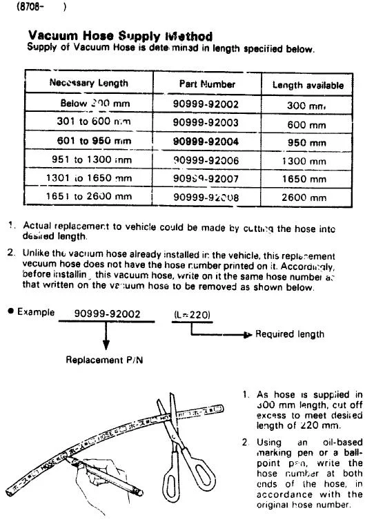

Here's the pages from the parts microfiche. The length (in mm) for each tube is listed on the diagram. You can just add them up...
IIRC it's like 30 ft. of the smaller stuff, and about 5 ft. of the larger stuff. This should be plenty plus some leftover for spare.
HTH-
Ditto, I bought 25 ft and came up short. 30' should do it. If you go with silicon from a place like McMaster, make sure you get the thick wall tube, especially with the 5.5 mm. Thinner wall stuff is not collapse resistant enough for vacuum.
I got some of the red silicone hose from McMaster Carr. It comes in different colors. I ordered 40 ft. but you should only need 30-35ft. I would order atleast 35ft. It is always nice to have alittle extra. Make sure you get the one with the thick side wall.
I show the part number is 5041K52.
x2. I ordered 40 ft from McMaster Carr and have about 6-8 ft left over
