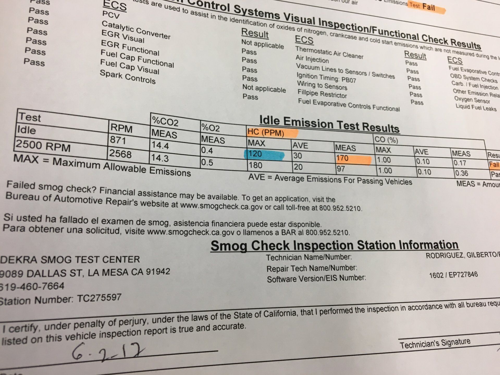

The one I linked to earlier is under $200, CA legal, may require welding. I'm gonna go for smog hot w/o cat on Friday and go from there.
Failed retest. Ran Seafoam through tank, replaced plugs, and drove about 45 min at freeway speeds and then right into test bay. Went down 11 ppm of hydrocarbons at idle but still 50 over pass. So something's going on at idle. Is there and ICV on the 3fe, I'm a little more used to my 02 Tacoma.
Oh, and reading the manual tonight I'm seeing that the spark plug gap should be .043, I had read somewhere else here on the forum to set the plug gap at .0315 (I set to .032). Not likely to have been the only reason it failed but I bet it didn't help.
