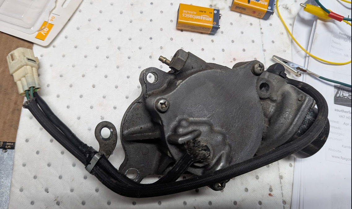

Yeah, bad luck here on the CDL after my T case reinstall. I have the EWD for the CDL, but I'm having a hard time understanding it.

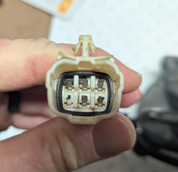

I'd like to check the operation of my CDL motor with a 9V battery. I have read that I can connect the 9V battery to the 6 pin plug (only five in use) coming off the CDL actuator motor. If you know, could you tell me what pins I connect to Neg and Pos on the 9V to cycle the actuator? I also don't see an indication on the six pin plug coming off the actuator as to which pin is what number. Could you post a pic or tell me which way they're numbered?
Thanks for the help.
Thanks, guys. I am able to cycle my CDL actuator motor both with the switch in the dash and the 9V battery, but I can't get it to unlock. I've got the wheels in the air, and I'm trying to unstick the front and rear rotations of the drive shafts/wheels with no luck. I cycled the motor to the unlocked position, put the switch in the dash in the unlocked position with the truck off, then plugged the actuator motor back into the harness. No luck.
Any suggestions?
Thanks.

I had this issue a few days ago, when I opened the motor, I got about 3 pounds of beachsand come out. Ordered an Aisin replacement and its working like a charm now. They're not cheap tho! Around 500$. Hope yours is salvageable.
The issue it could probably be having is the magnets that attach to the housing fell off and need to be glued (JB welded) back in place. To my understanding, if the're touching the coil, they will not work. Also, give it a good clean inside, more than likely moisture got in and seized everything in there.
