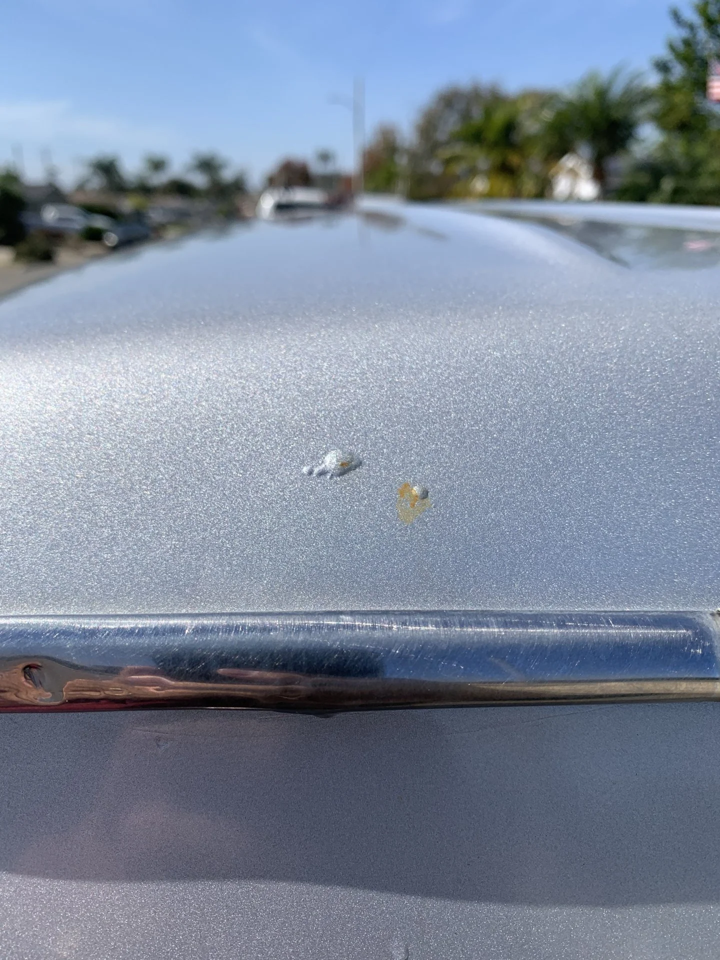

How do I stop this before it becomes a bigger issue

What I did was tape a box around the blisters. sand them down, and spray some primer once you. if you get metal exposed after you sand it down spray some rust inhibitor on it.
Dig them out with a tiny screwdriver to bare shiny metal. Apply a drop of ospho to convert the remaining rust dust in the pores, wipe off, apply a dab of touch up paint primer, then color then topcoat.

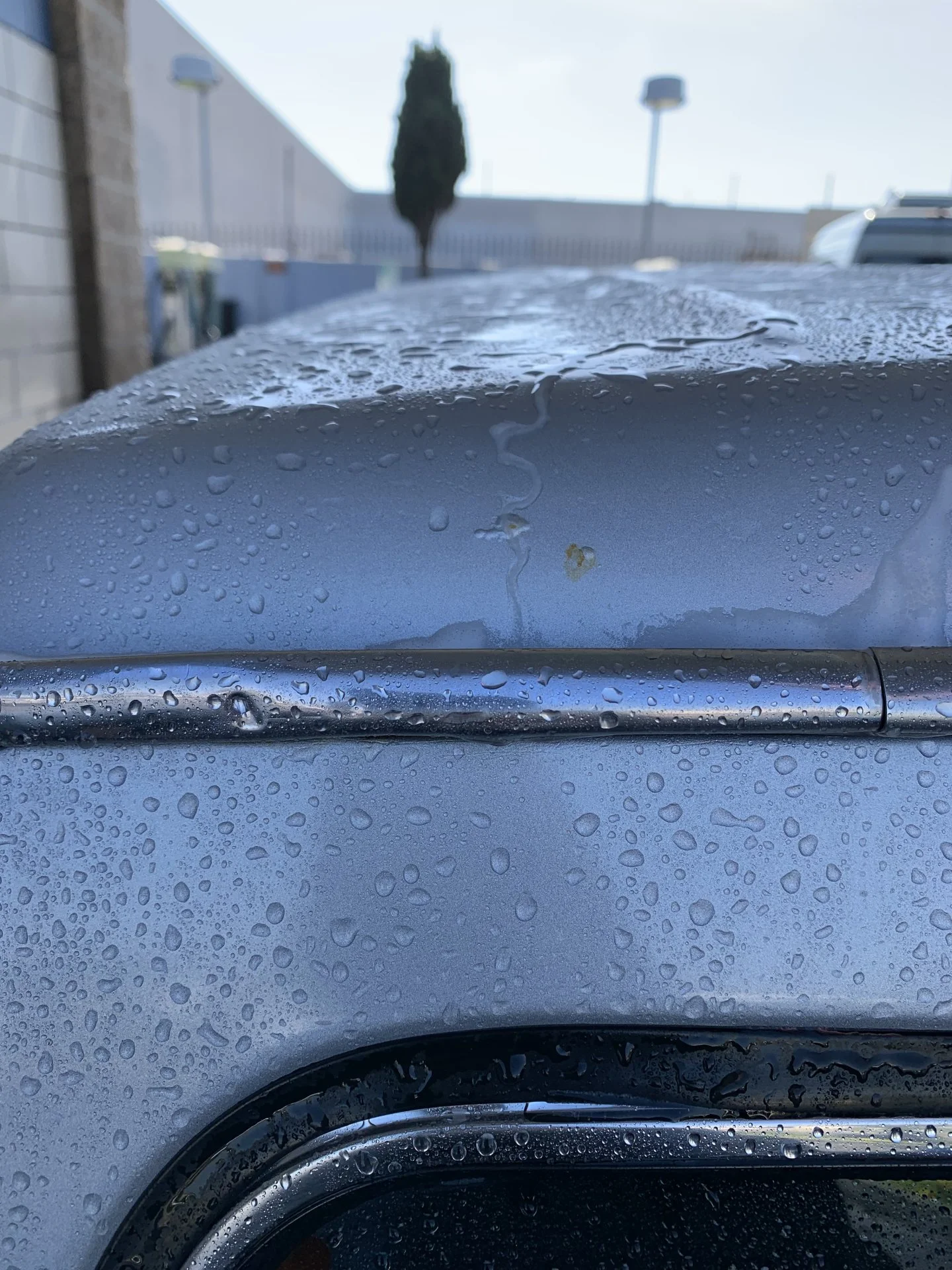

Ended up finding a larger rust spot on the underside of the drip rail (just below where the picture was taken). Got a quote to have both spots sanded down, treated and patched (as well as one additional spot on the inside of my passenger front door). Hoping I can at least stop the spread before it gets away from me. Dang I need another garage space for this truck!! Even in southern California...

Rust is like an iceberg floating in the ocean; you only see what's above the surface, there is more. But yours doesn't look too bad, so yeah! If it's bad rust that requires welding in patches be prepared to have to drop the interior headliner; that complicates things. After you do fix the rust, be sure to get rid of the old/not functioning seam sealer in the drip rails and reseal properly. Good luck my homie! :)

It rusts from the inside.. a car cover wont really assist a great deal in preventing more of this, you need to get a load of fish oil or penetrol into the cavity - not easy with the headlining still in place.
