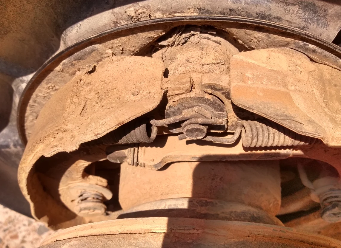

One thing that I did find during a pre-trip brake inspection is the emergency brake drum likes to fill up with mud. The adjustment and access holes were all properly plugged. The mud creeps in between the shoes and the drum. There was a faint squeak coming from this wheel. Since everything is plugged up for the emergency brakes as it should be, I may need to periodically pull the drums to clean out the mud after one or two outings. No rust. Just mud and dirt.
