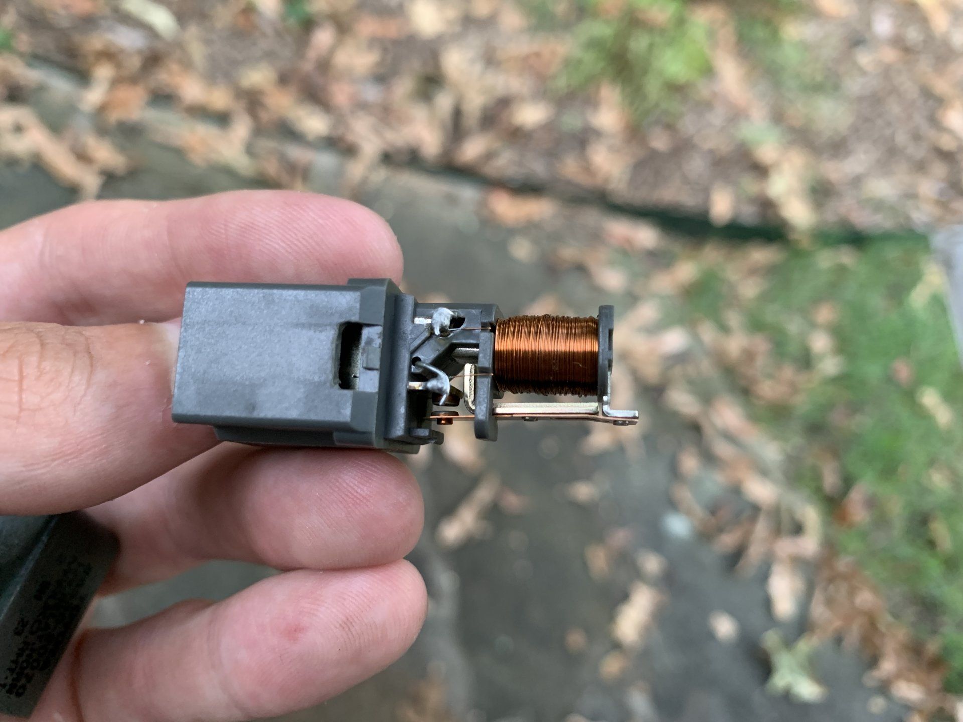

If the relay got damaged it seems like it could just be the mechanical bits of the relay sticking.
Have you guys tried a brand new relay?

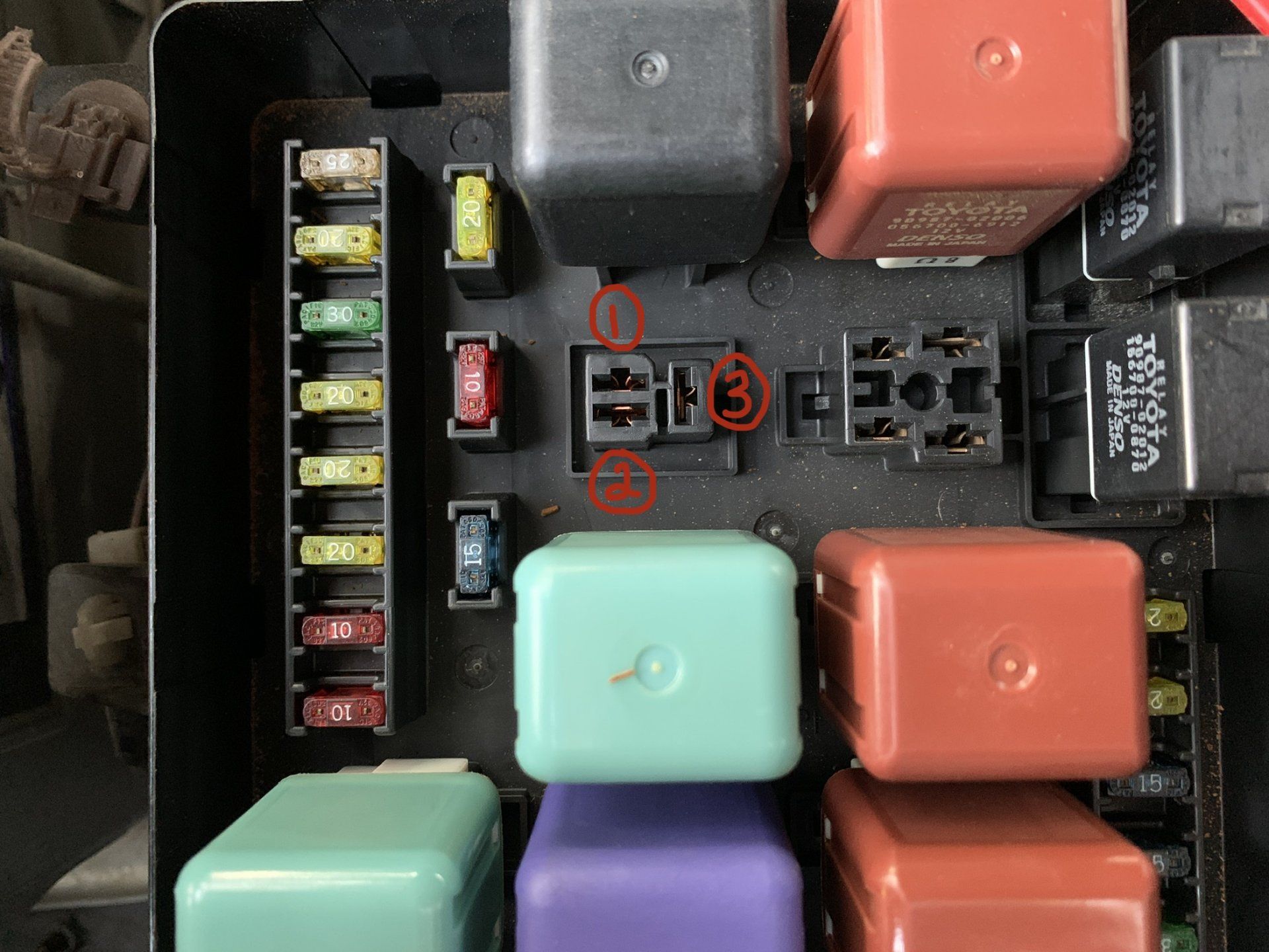

Currently experiencing the same issue with a sticking horn. I started a thread on a similar problem back in January (Sticky & Sensitive Horn); however, I was always able to rectify the issue by sliding my fingers around the back of the airbag module in the steering wheel and giving it a slight tug outward to stop it.
This time that is not the case. The horn sticks on regardless of how I manipulate the airbag. No rain recently so it’s not a water issue. The relay appears fine, but I did stick it back in the fuse box under the hood without the cover and noticed that once the horn was stuck on the relay stayed closed (the contacts touching). They would not open by themselves. I also noticed I have constant +12V across legs 1 & 2 and 1 & 3, and after reading this thread it sounds like I’m only supposed to have it across legs 1 & 2. I’m thinking about buying a new relay just as a simple first step, but the fact I have +12V across two sets of legs makes me think this is an issue with the contacts in the steering wheel. Does that thinking sound correct? Any tips?
