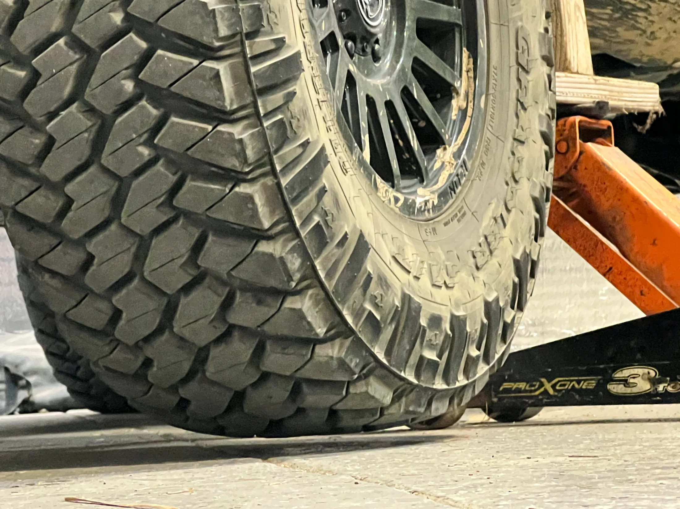

thanks for the kind words on the front bumper. It is also worth noting we offer a higher clearance one as well. As for the sliders. I would agree, typically body mounted and slider shouldn’t be used in the same sentence and we need to do a better job of showing you all how we achieved this. That being said there are some major benefits to our body mounted slider that are worth considering.
#1. Clearance. Because we are mounted directly to the body we were able to raise the slider up about 2-2.5” higher than a typical frame mounted slider.
#2. No need to fuss with all the factory ahc globes and bolts. If you have done this you know how much of a pain this can be.
#3. Rigidity, because we attach to the rocker and pinch weld we actually see a more rigid slider. Less deflection when under load.
We achieve this by not only mounting to the factory bolts but also all the way across the full length of the pinch weld. The pinch weld itself is actually quite strong and we utilize its strength strategically to work together with the slider body to form a super strong and rigid slider. Ours is a tested slider that will support the full weight of the vehicle. Here is a photo of me lifting from the rear of the slider the full weight of the vehicle. It’s hard to tell in the photo but both front and rear tires are slightly off the ground. I would be happy to go into more details if you would like.
We achieve this by not only mounting to the factory bolts but also all the way across the full length of the pinch weld. The pinch weld itself is actually quite strong and we utilize its strength strategically to work together with the slider body to form a super strong and rigid slider. Ours is a tested slider that will support the full weight of the vehicle. Here is a photo of me lifting from the rear of the slider the full weight of the vehicle. It’s hard to tell in the photo but both front and rear tires are slightly off the ground. I would be happy to go into more details if you would like. View attachment 3992479View attachment 3992480
Would love to hear more detail! And also if/when you may consider shipping...
