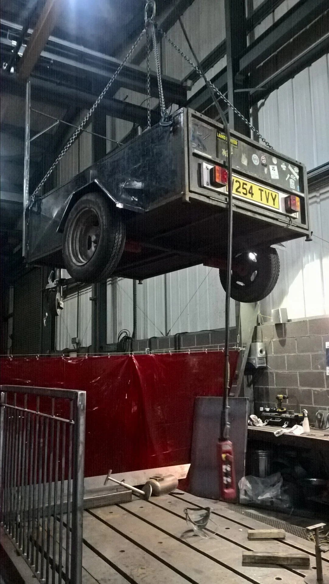

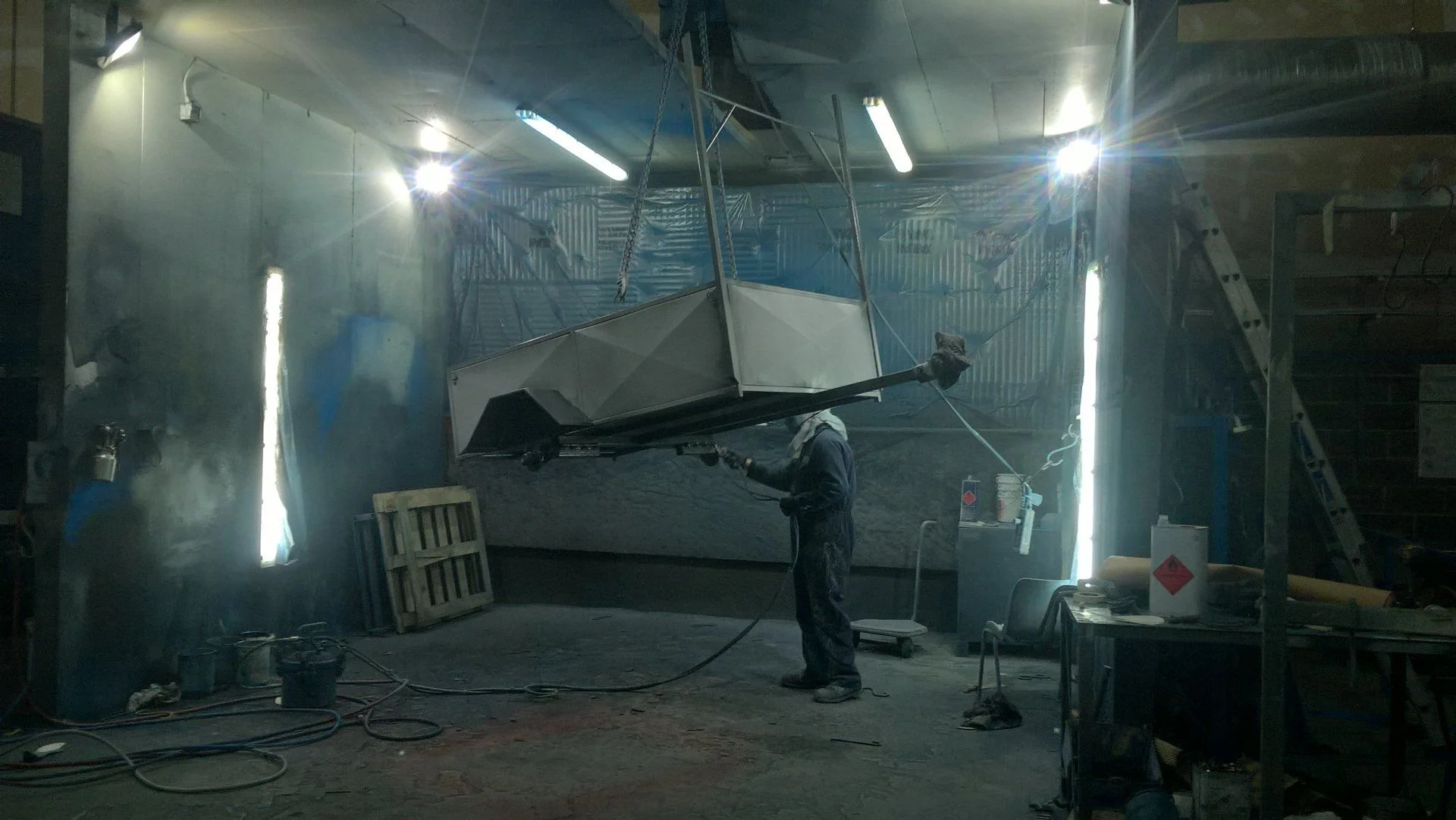

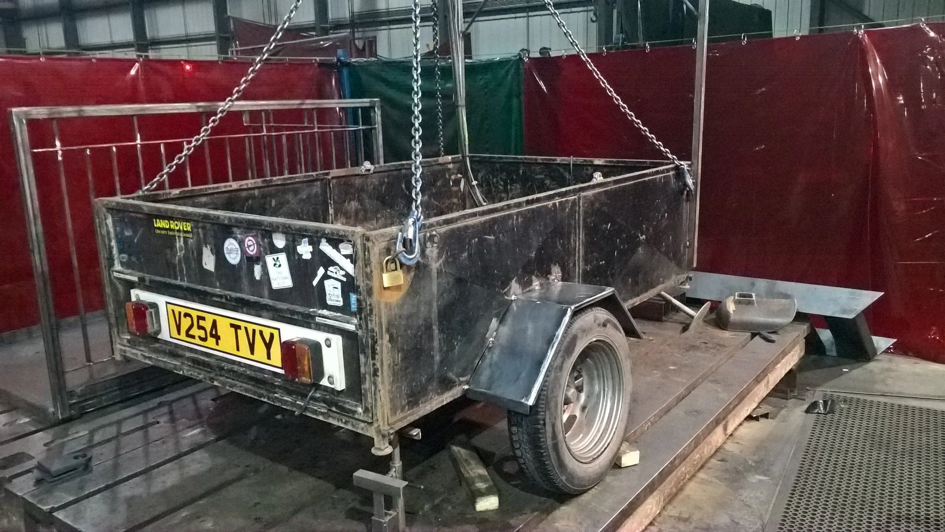

So over the last 2 weeks ive made a lot more progress than I thought I would, got it stripped down, took off old wheel arches and and tailgate, knocked out some of the bad dents, welded up a couple of holes and panels back in place. Then last night the painter at my work said he had nothing to do so I set about it with the orbital sander, steam cleaned it all and he etch primed and painted it for me in a tough hammer-finish grey for me.
Let me know what you think, Richard.
Some more pictures of where were at now.

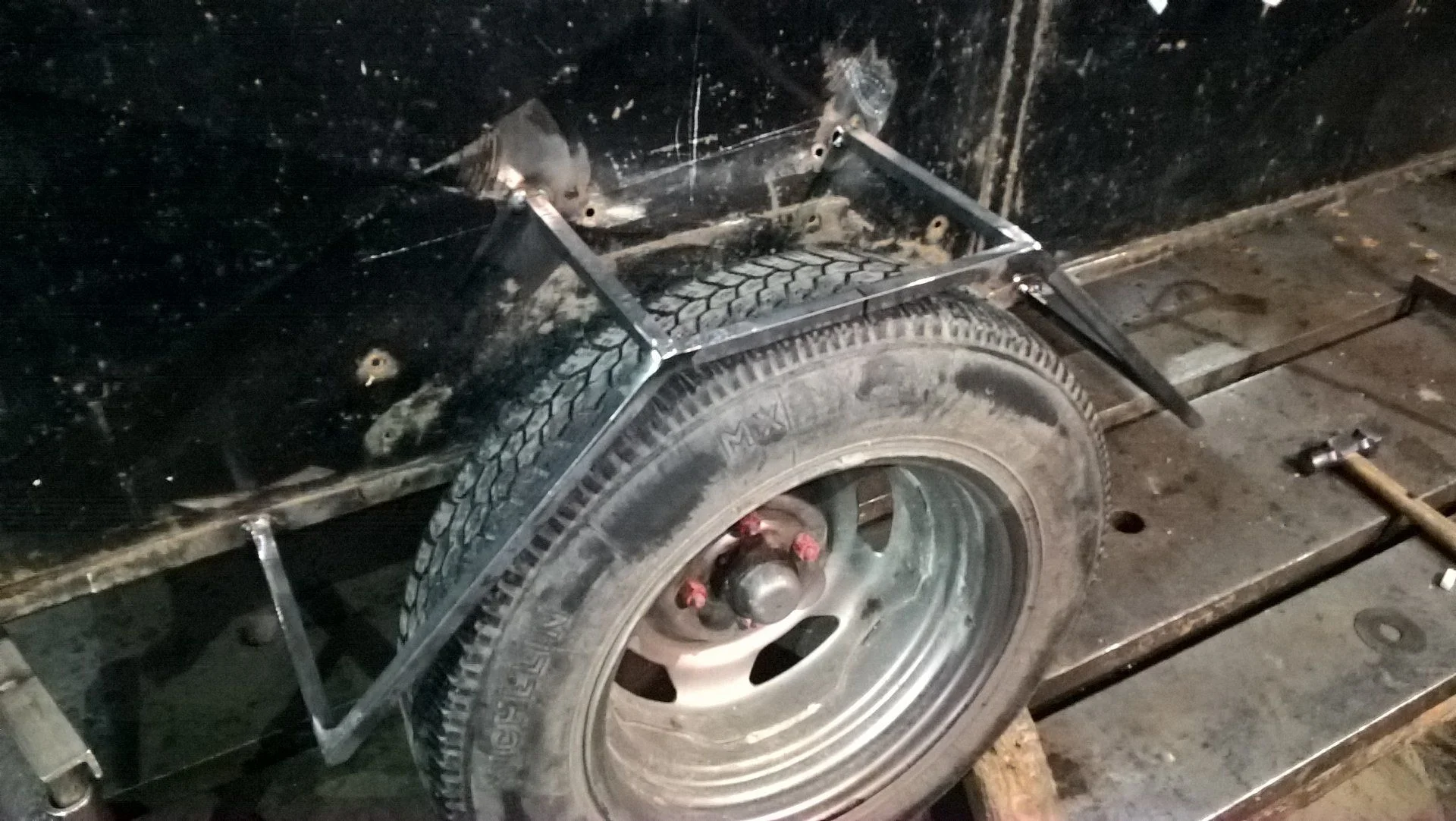

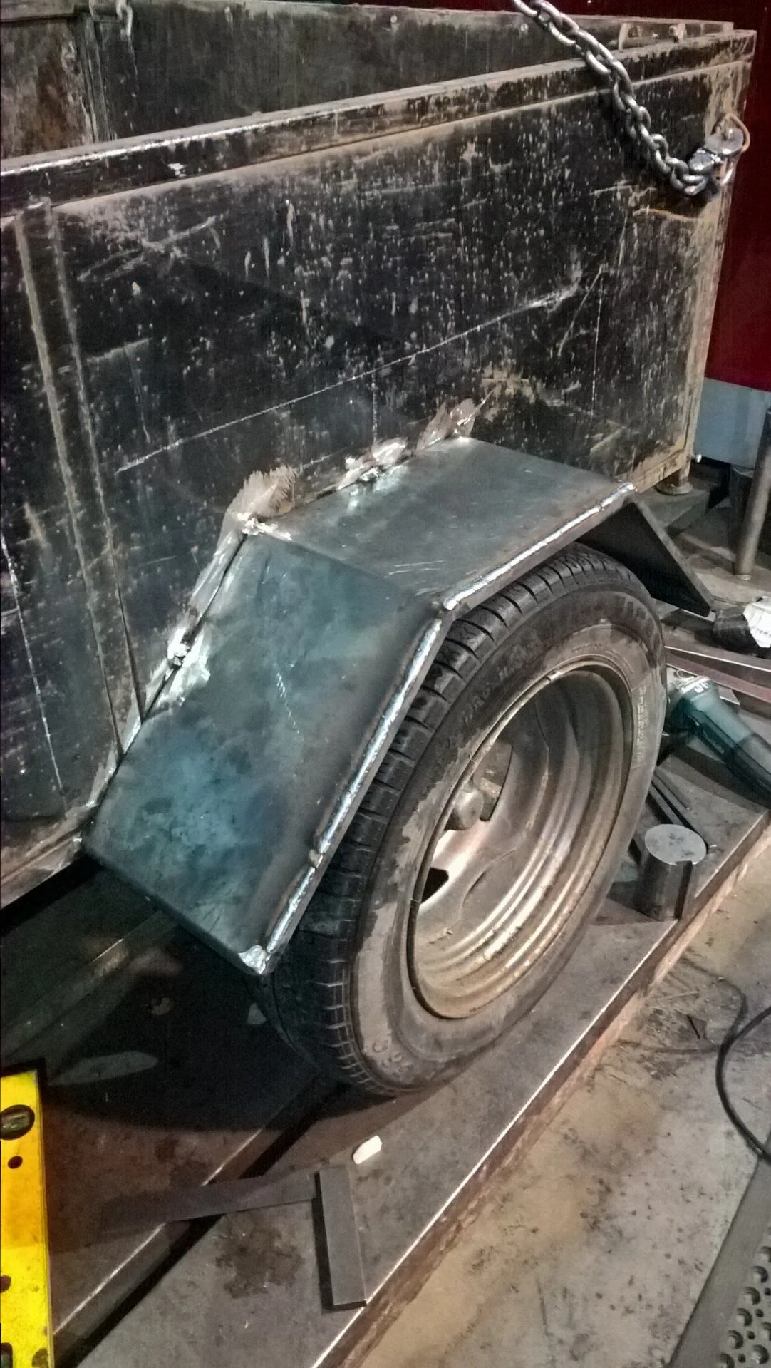

wheel arch frame work used some spare 20mm solid bar
plated up and welded

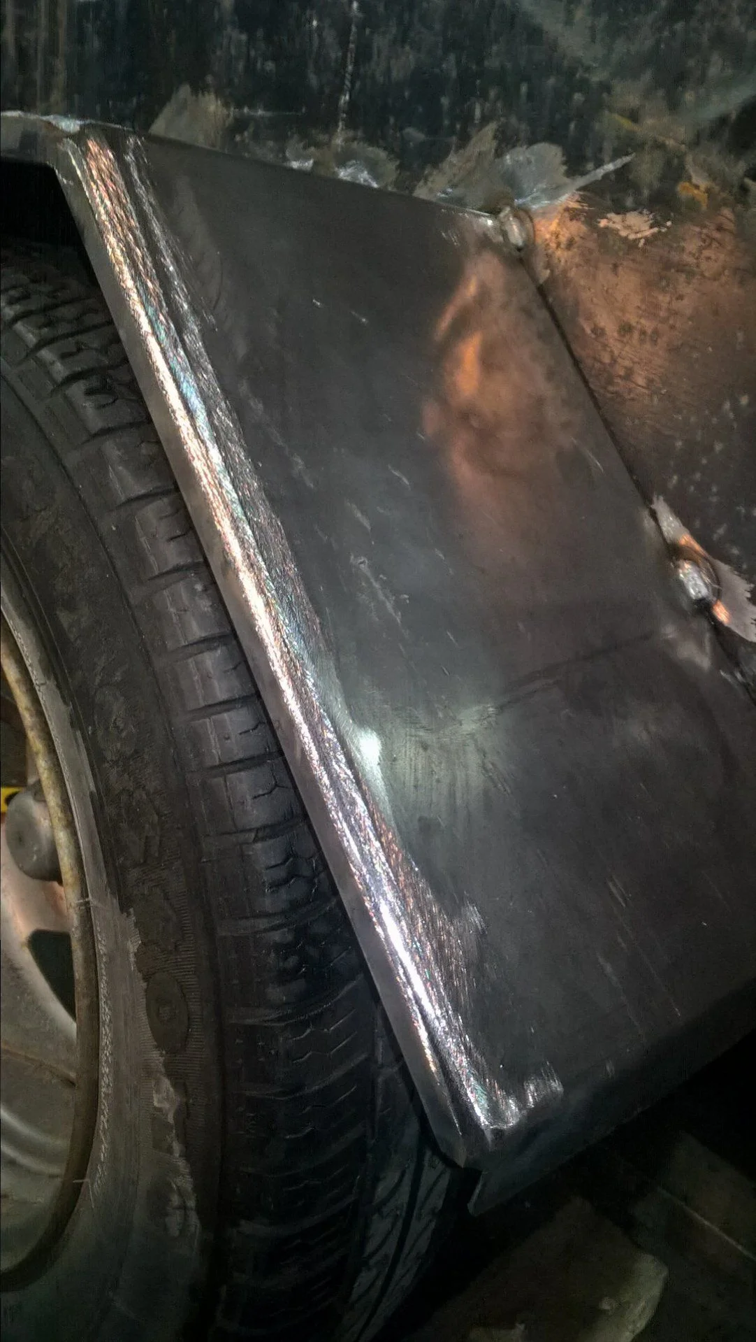

sanded nice and round so no sharp edges

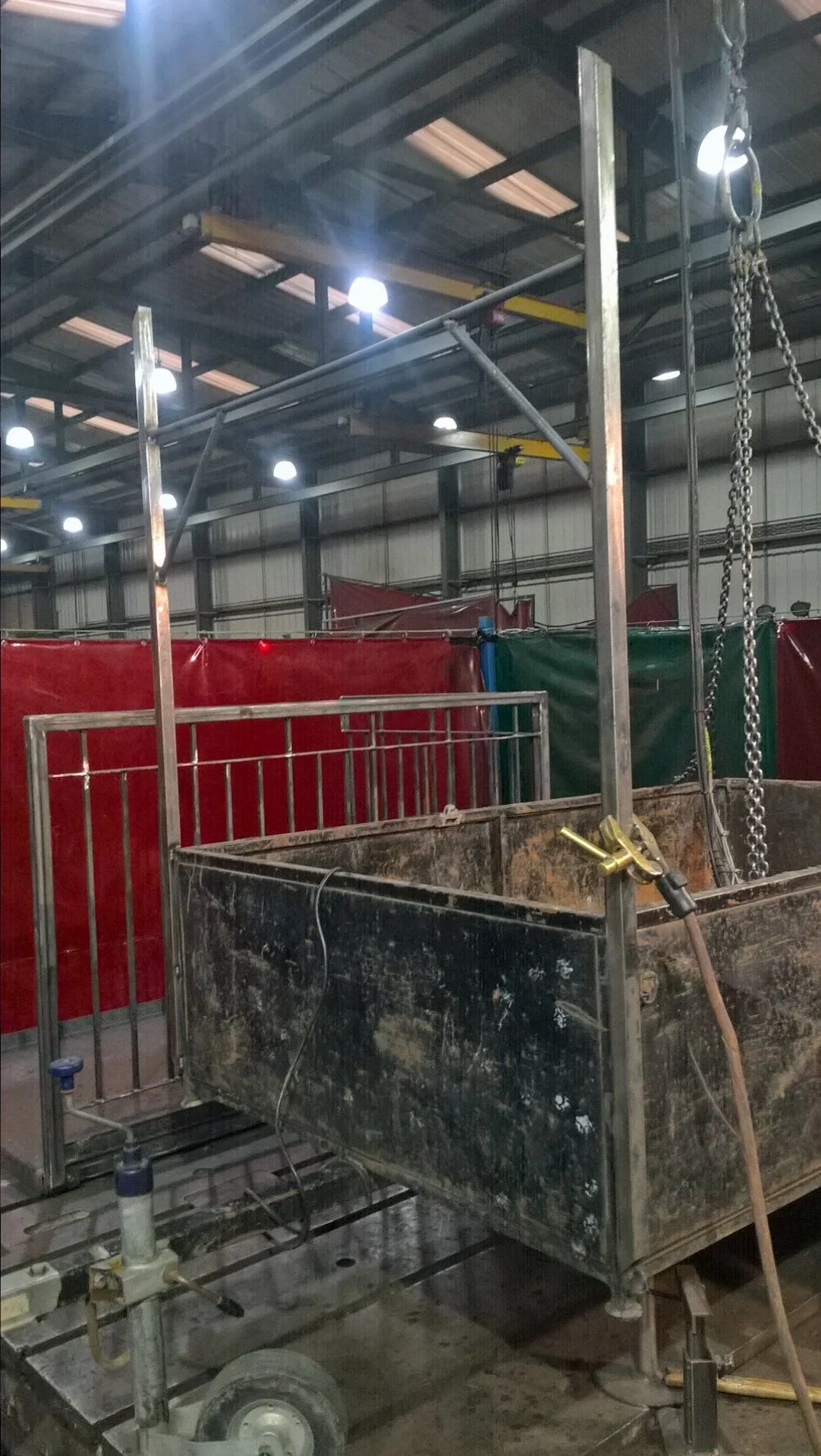

first side finished

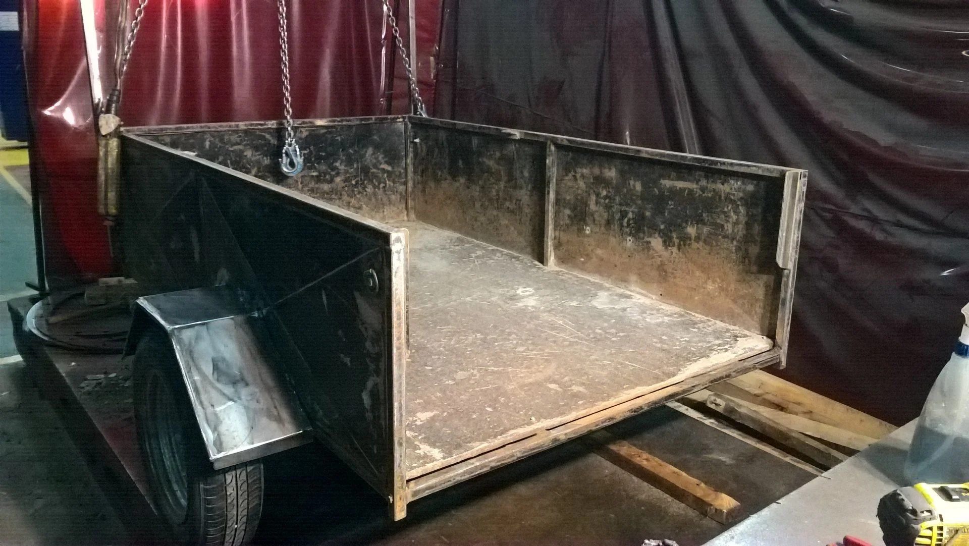

both sides done and ladder bar, off for sanding

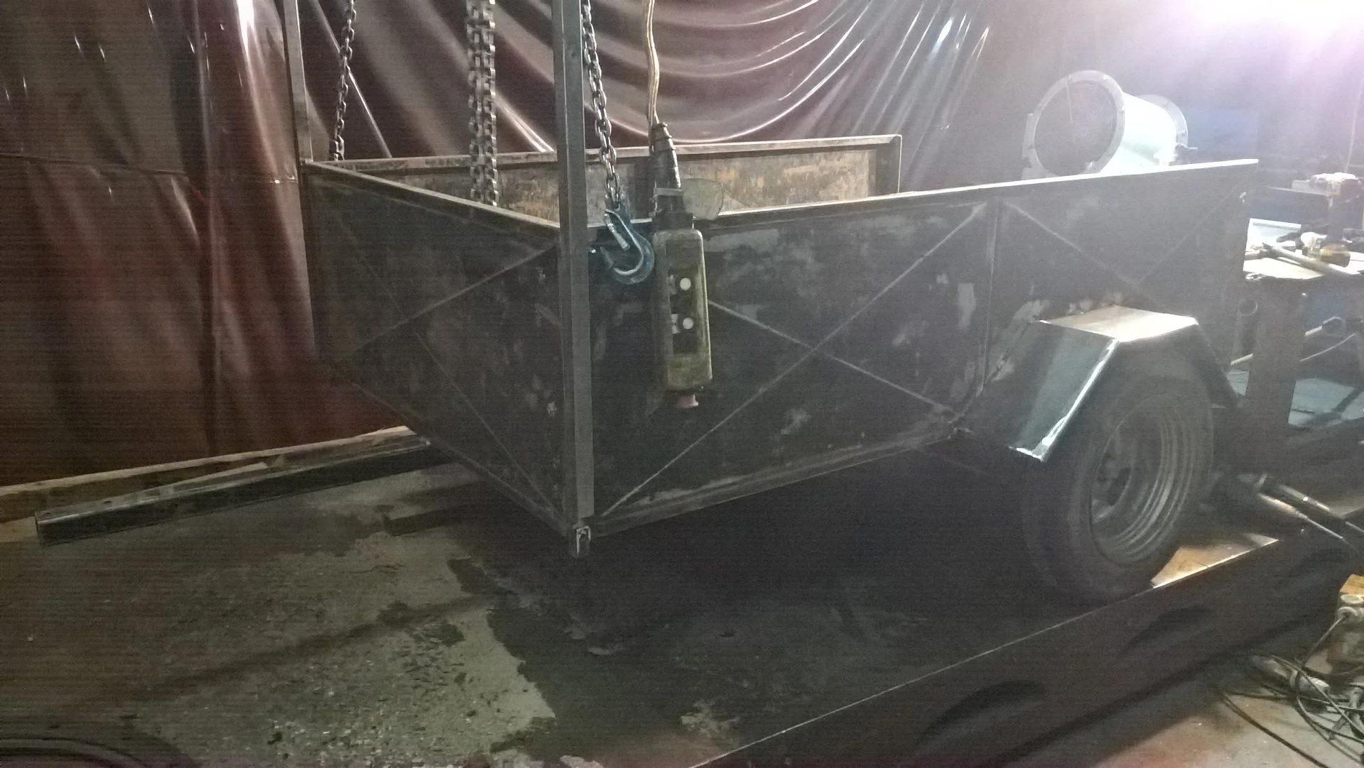

all parts stripped off and orbital sanded, ready for primer

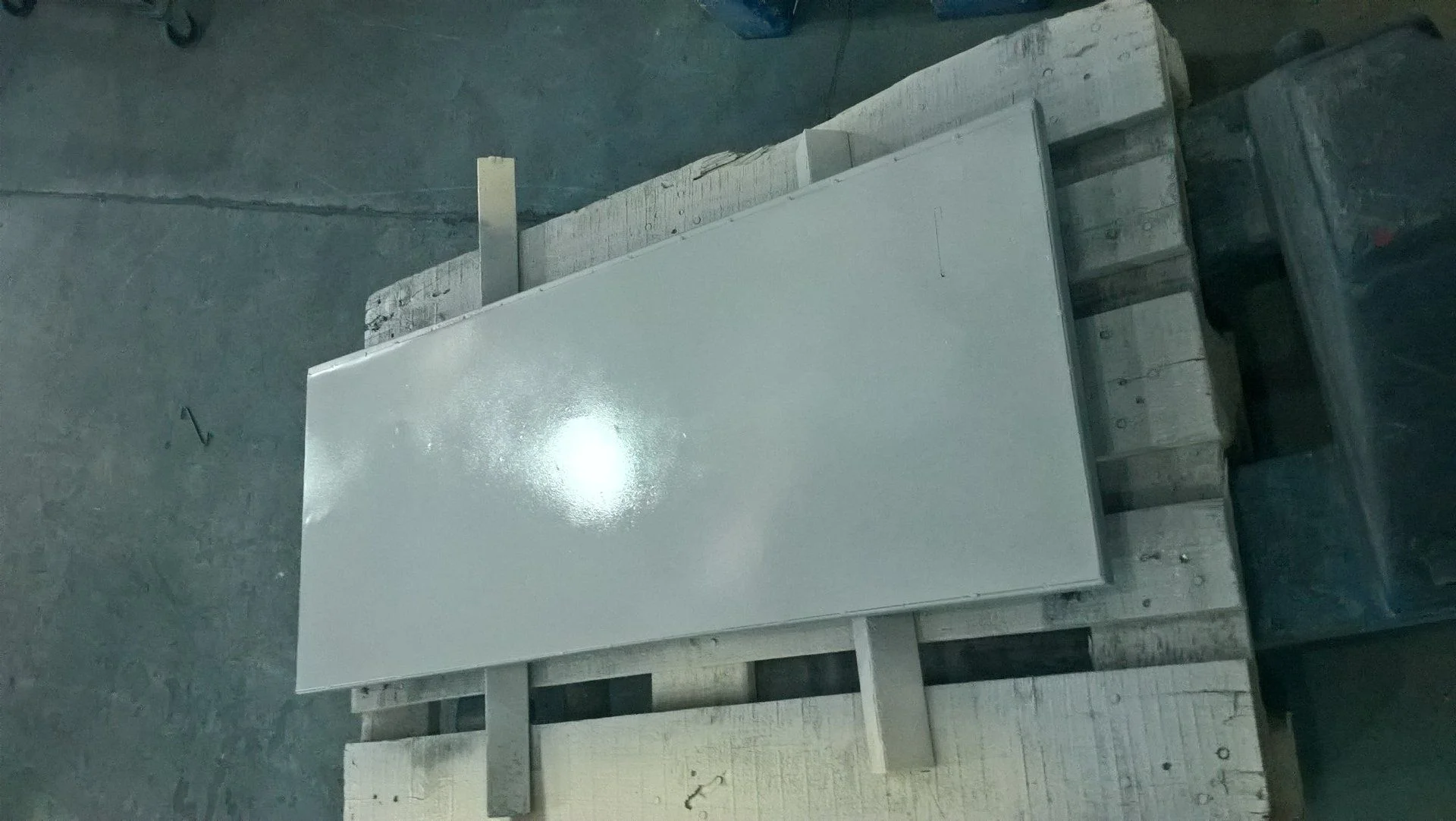

tailgate frame, then plated and primer

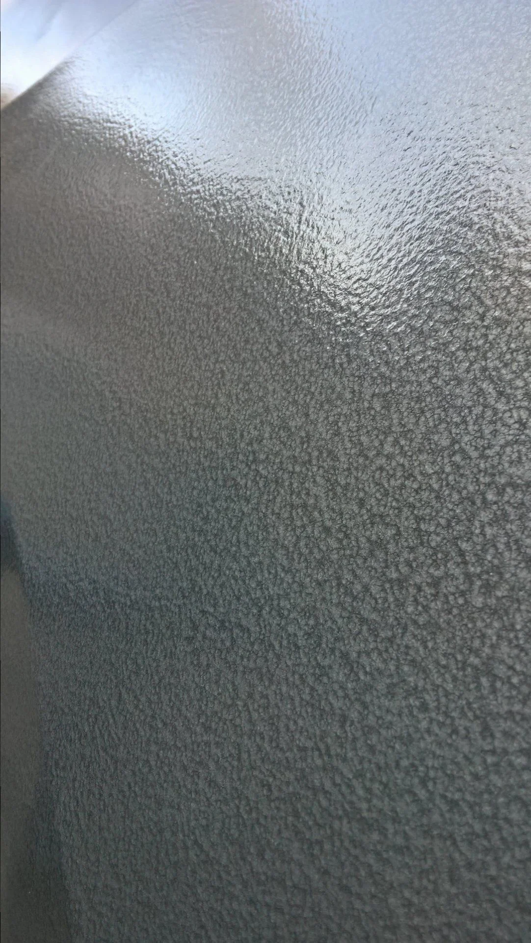

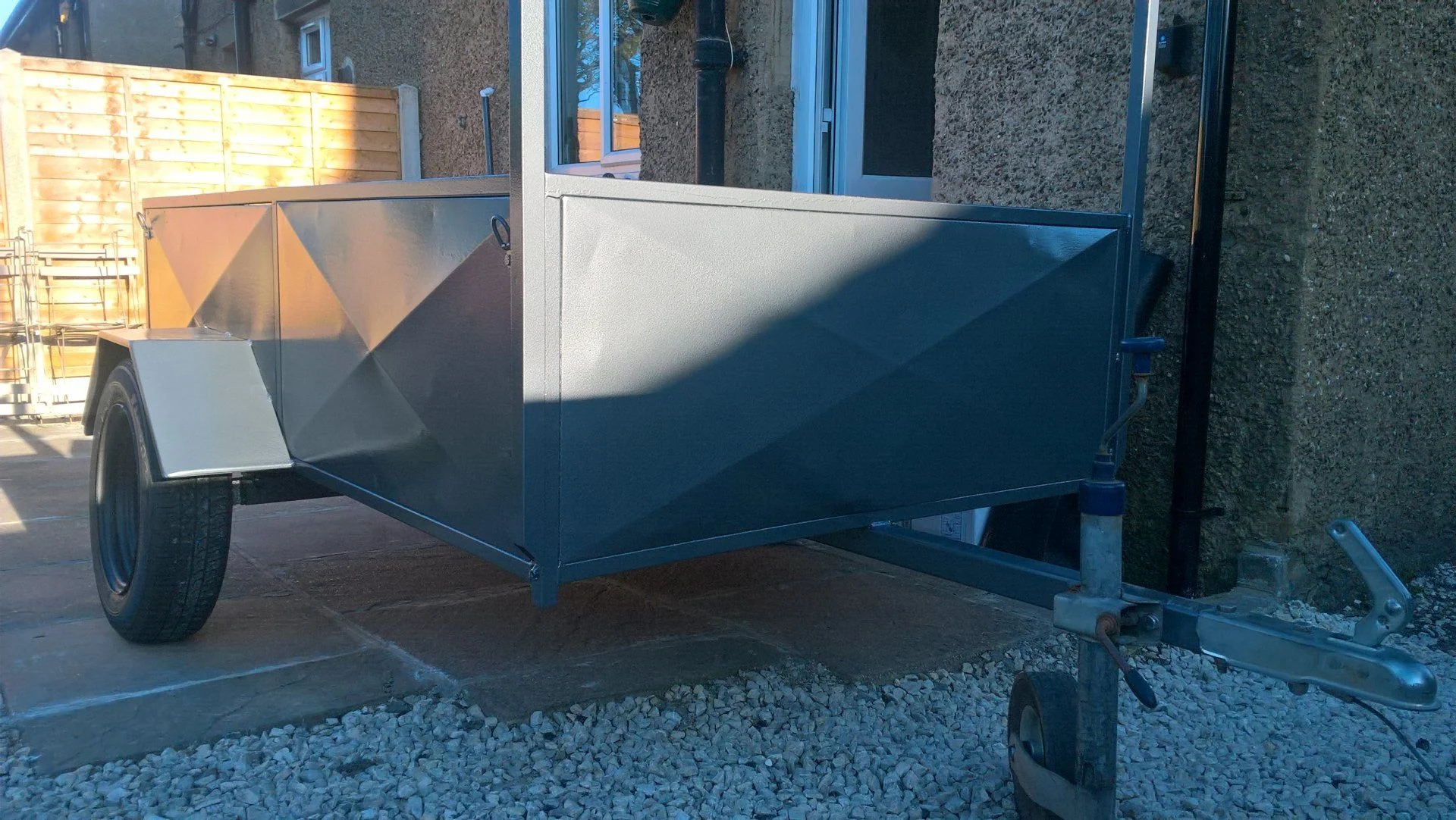

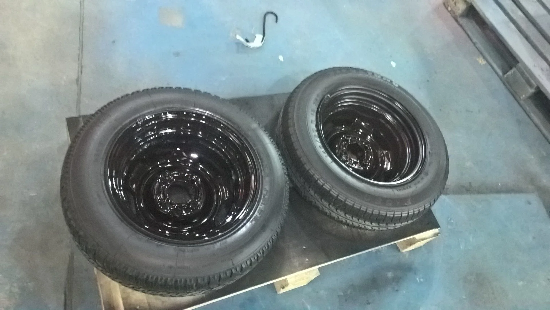

Wheels done in matt black, look nice and glossy when wet though
in primer ready for top, heavy duty hammer finish grey/black
