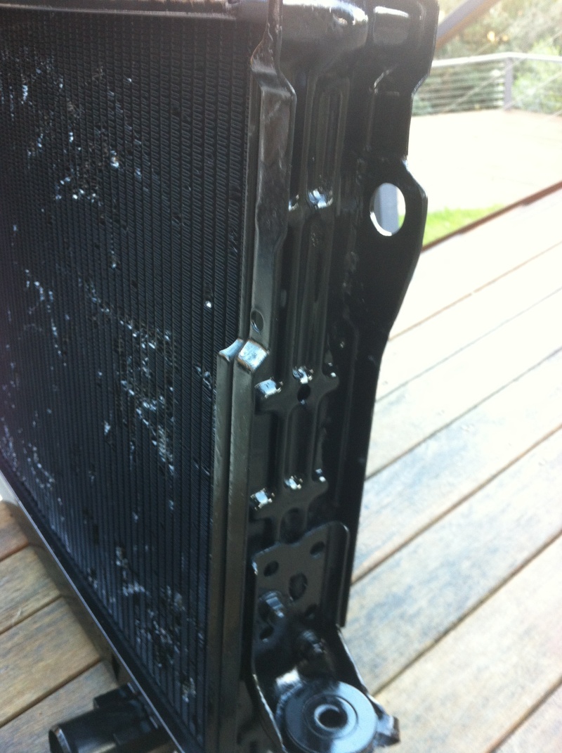

Something that I've been meaning to do for a long time is drop the rad down 25mm after the body lift that went in several years ago. I did this by drilling 2 new holes in each lower mounting bracket. For the upper mounts, I cut them out oversize and welded in a new section of 2mm plate. I then marked the new holes and drilled them out with a hole saw. All up, it took about 2hrs. This was followed by a trip to the radiator repair shop to have it inspected and cleaned. I really didn't think it needed cleaning and, when I went to pick it up, the repair guy echoed my thoughts. Anyway, for $150, it was cheap peace of mind knowing 100% it was good as new. He also suggested I keep using the Toyota red coolant and he said it's the best coolant for that engine.

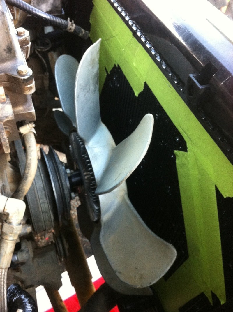

With the rad in position, I taped up an area where the fan spins. Using a square, I marked in several locations where the fan blade edges projected forward.

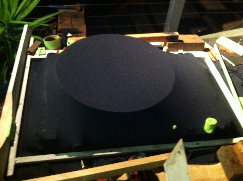

The fan measures 470mm across and the OEM fan shroud opening measures 500mm... that give 15mm clearance. Using some 12mm ply, I cut out a 500mm diameter circle. The OEM fan also sits 100mm off the face of the rad core so, I cut 4 blocks out of 90x45 pine and screwed them to the underside of the ply circle. Then, using the marks on the masking tape, I placed additional marks 15mm further (to give me 500mm over all) Once I'd positioned the plywood into place, I held in in place with a hot glue gun.

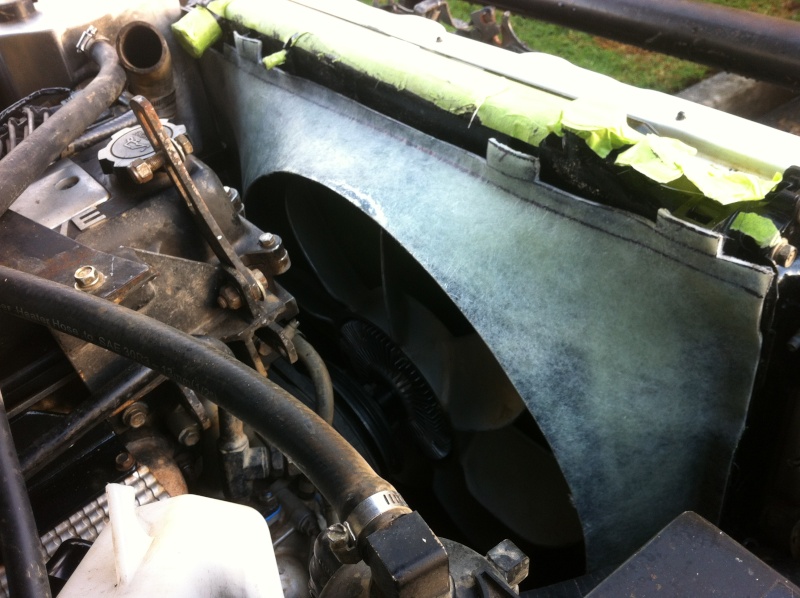

Sitting the radiator on a sheet of ply, and using some speaker cloth (purchased from JayCar Electronics) I stretched the material over the rad to give me a nice, tight fit. I held each side down with a timber batten screwed to the ply. I've used this speaker cloth before with fiberglass projects and it can be made to fit virtually any shape or profile, and it can be stretched super tight without fear of tearing.
Next, I needed to make up profiles and clamps to further control the profile I needed the shroud to take. I did this using a series of timber battens, Alloy angle, steel plate and even bricks to keep it in position.
Once I knew everything fitted, I removed it all and set it aside. I then mixed up some fiberglass resin and painted it onto the speaker cloth. Once it was soaking in resin, I then reinstalled all my battens, clamps and supports.
Left to dry overnight, I then removed all the bracing to leave me with a nicely formed fan shroud template.

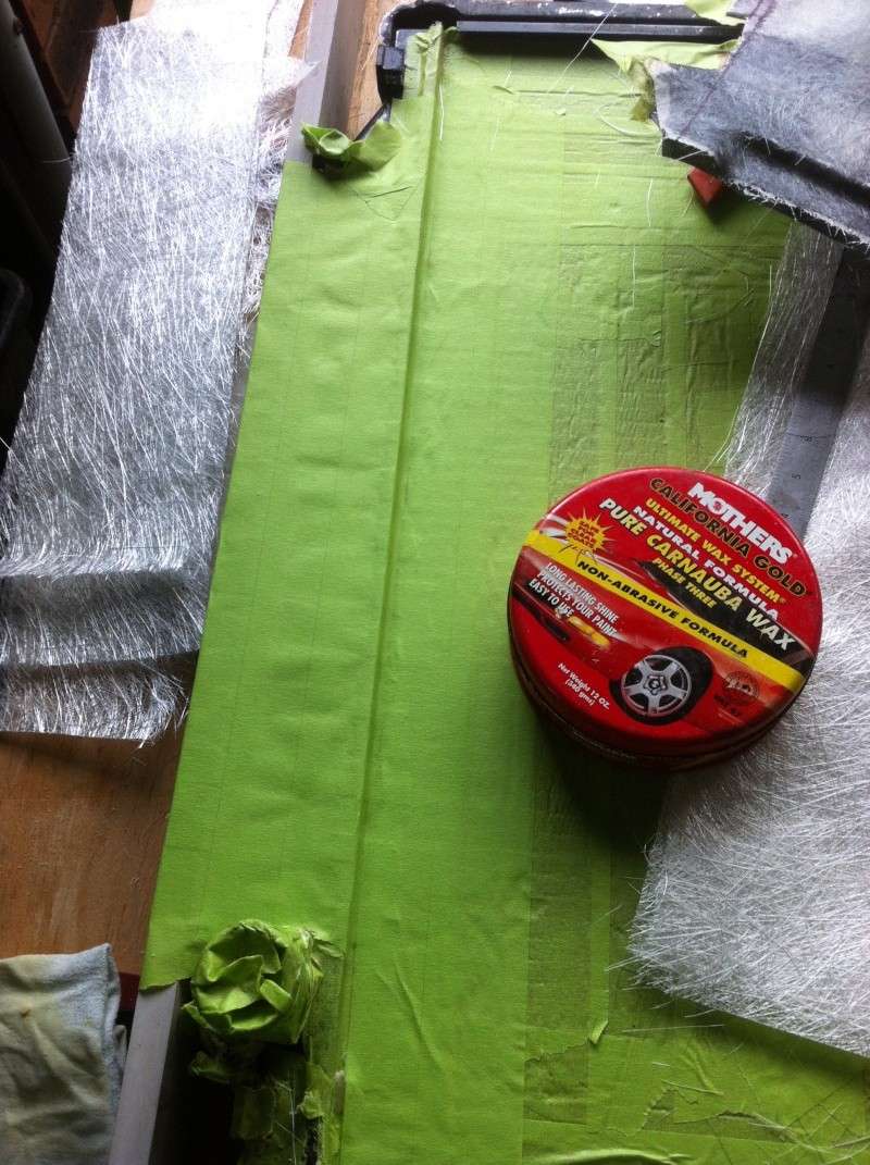

Next it was time to start fiber-glassing. I wanted to get a couple of layer on before fully removing the shroud from the radiator to minimise any distortion or damage. This also meant that it would fit neatly back into position. On tip with fiber-glassing is to make sure you have everything ready before you start mixing the resin. While you can vary the gelling time, you still only have 20-30min before it's useless - and that time can go very quickly with fiddly jobs like this.
For this project I used 225gsm glass strand mat. It works well on these projects as the resin soaks into the mat and the Mat can be formed around almost any shape. Just paint the frame with a generous coat of resin, sit the mat on top and paint more resin over making sure to work it in. Ensure each piece of mat overlaps the other. Once the required amount of matting is installed, I roll the whole job with a steel roller. I'll post a pic later, but it's basically a 3in long threaded rod secured on the ends by a formed wire handle. Using this tool helps to remove any air bubbles, gives a more even coverage of the resin and flattens out any irregularities you might have.
Once dry, I was able to remove the shroud from the radiator. You need to take your time here to prevent distortion or damage. I used a steel rule to help separate the mold. A good trick, and one I forgot to do in my haste to get the project underway, is to apply a couple of coats of wax to the areas you don't want the resin to bond to. Cooking spray also works but leaves a sticky residue finish. You can see I've begun marking where I can trim it back and also the mounting points. For the areas I need to reinforce or make bigger, I've stuck more tape on the back to support the next few layers of fiberglass.

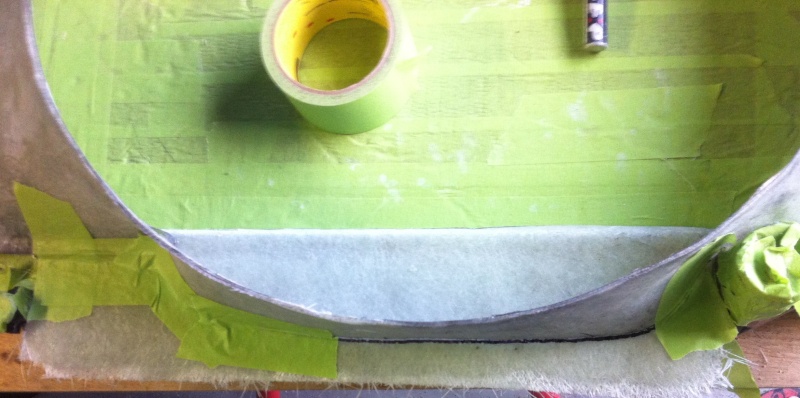

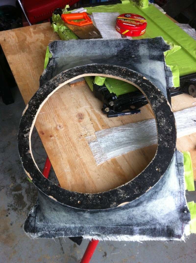

After applying 2 more layers of mat and a few extra bits in places I wanted to reinforce, I then made a lower section to fill in the bottom of the shroud. Again, using a few pieces of timber and some tape, I had a template ready to glass up. Note I didn't forget the wax this time.
After 4 layers of glass, this is it ready for removal and trimming. Don't be afraid to make things a little bigger than needed - it's much easier to trim it back than extend it.
After applying a few more layers of fiberglass to the shroud and a bit more trimming, I sat the shroud into position, placed the lower infill section in place, taped up the outside edge to keep the resin in place, and then glassed up the inside to bond it all together.
With a bit more trimming done, it was time for a test fit. Trying to get it all in reminded me why I might have not bothered fitting the last one. Never the less, it fits first go and I'm pretty happy with the way it's tuned out - even if it isn't finished yet :hhmm:

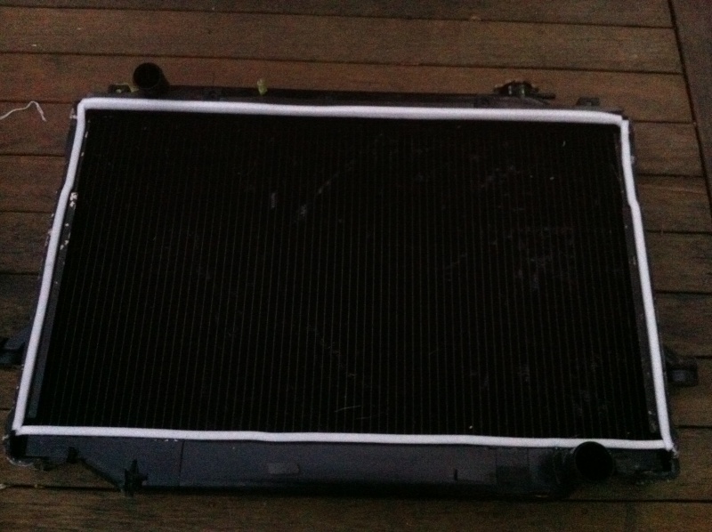

Once I confirmed it fitted just right and drilled all the mounting holes, I put some thick foam around the radiator so the shroud could form a nice seal around the edges. It was sourced from the local hardware store and only cost a few dollars.

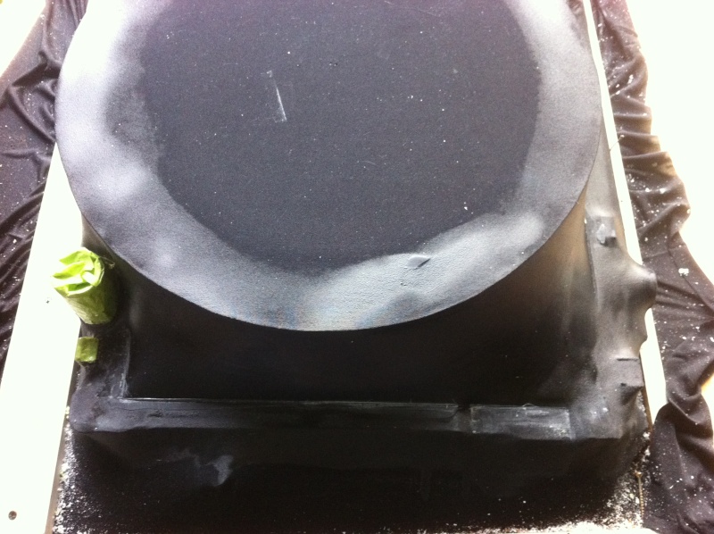

Here it is sitting in position to confirm everything fits perfectly. I wanted a durable, hard wearing finish. To achieve this, I added some black tint to a batch of fibreglass resin and painted on one thick coat. Once dry, I was left with a rock hard, gloss black finish.
And, finally, here it is in all it's crappy picture quality glory. Fits like a glove.
