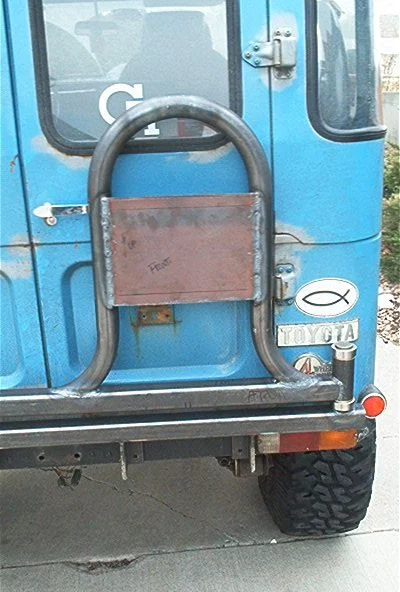

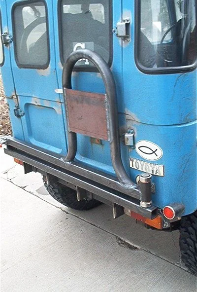

Got a bit more done...
Here are few pics of where I am at after this weekend. We got the swing arm latch done, the tire carrier hoop bent, fitted, and welded in place. It is coming along nicely.
As it sits right now...
Here are a few detail shots of the latch. I grafted a 3/8"plate into the swing arm to get the latch to sit right, I tapped threads into the plate to mount up the latch body. The De-sta-co latches are really stout and this thing really "clamps" down hard on the latch bracket.

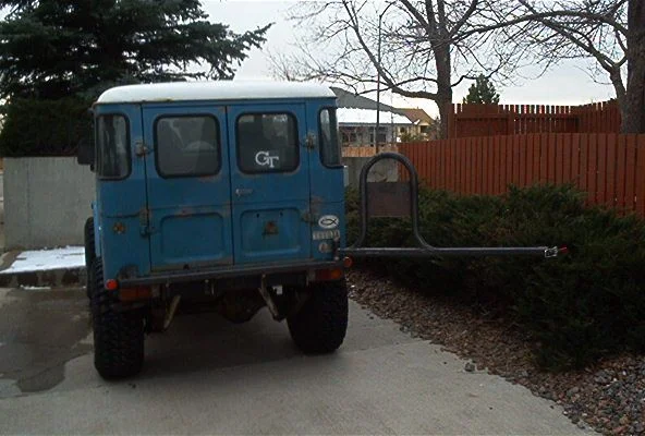

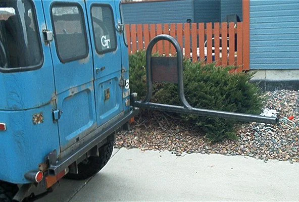

Here are just a few more, some of the swing arm open, it swings nice and smooth and stays where I stop it... we will see how it acts differently when I put my 92lb MTR up there with a highlift.
We bent up the hoop with IanB's tube bender, it was really neat to learn how to bend up the tubing. Very simple machine, very good results. I flared out the bottom to spread the load over more of the swing arm. In retrospect, I would have mounted the hoop to the front of the swing arm giving a bit more room to gusset front to back.
