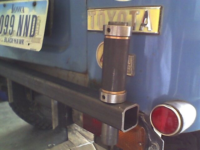

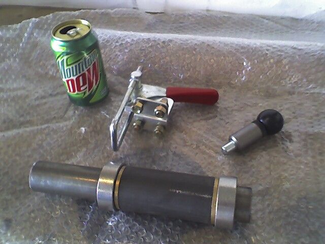

Here are the components I am going to use for my carrier.
The hinge is Iron Pig Offroad, it is sweet.
The Latch is part # 5135A27 at Mcmaster.com
The spring pin is part # 90222A415 at Mcmaster.com
I put a soda can in for size reference.
thats awesome i wish i used thast setup. damn. oh well i will use that when i break mine.

Just the pics of a pin I was about to search for. I'm sold on that setup when I get to doing mine. What was the pin, $30? Faw kin sweet IPOR part.
Yeah, I had a booty fab idea before Lance gave me a shout on a previous post. It is a great idea, replaceable bushings, 1.5" solid steel rod... and two collars that hold it all together... all for like 30 bones!

I havent ever built one, but this looks pretty sweet. I only have one question, Why do you need a spring pin? As far as I can see you have the latch and the spindle. Isn't that enough to secure it while driving? Or am I just missing somthing as ususal?

The spring will be welded to the swing arm hinge or right near it, the idea is when you open the swing arm on uneven ground you can "pin" the carrier in the open position. I will simply have a hole in the lower bumper that the spring pin will drop down into, holding the carrier open.
