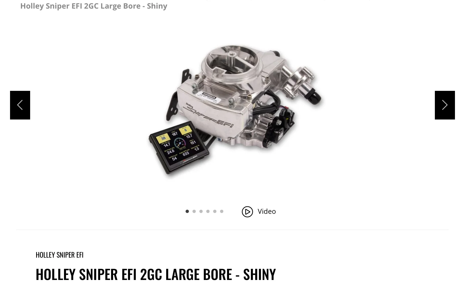

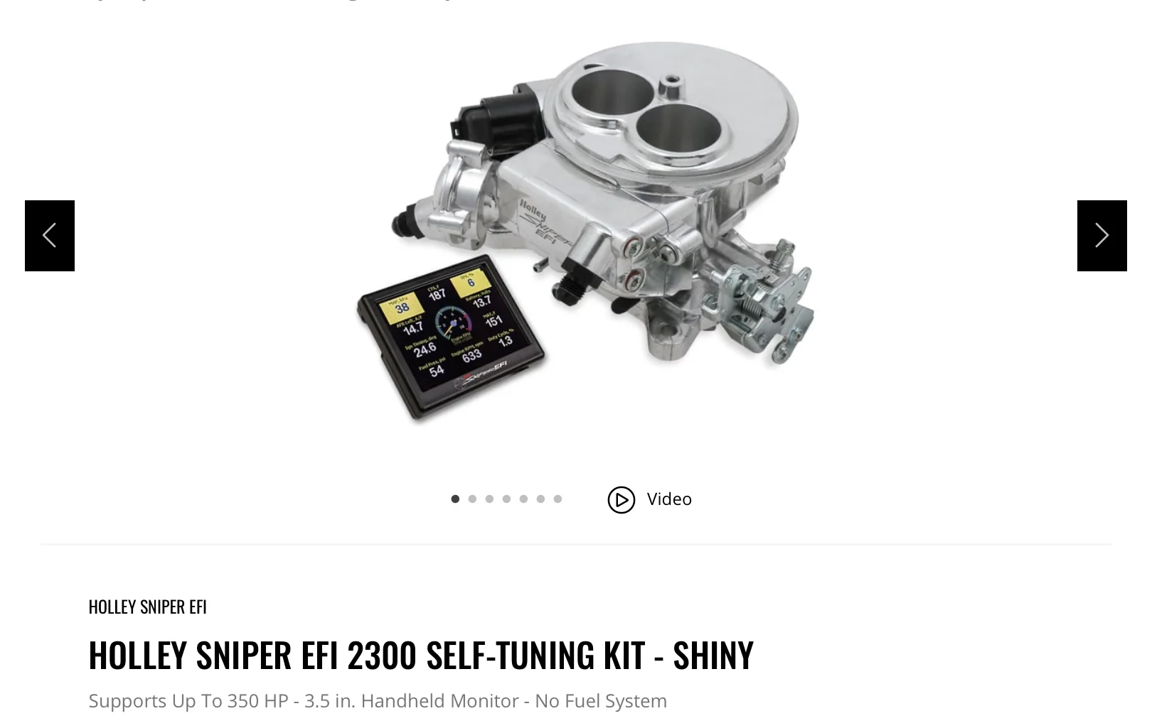

I’ve seen both the Holley Sniper 2GC and the Sniper 2300 used on the 2F….curious if anyone knows the difference, or if it’s simply a manifold mounting difference between the two?
its just a manifold mounting difference. They compensate for your engine, you enter number of cylinders and displacement. I ran a 2GC large bore with an adapter I had machined and it worked great. Most installations are the 2300 though, though its wider and harder to adapt to stock air cleaner. I had 8 of the 2GC adapters made in case you want one, this is the thread
