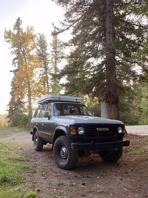

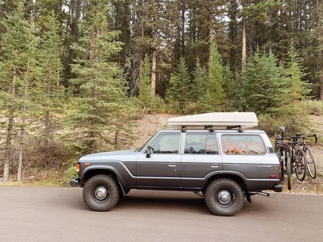

Before I get into how we actually made it look pretty and drivable again, here are pictures of the before and after.
Given that my girlfriend and I are both students, we had a limited budget and all the work was done in a driveway. But we are very proud of how rad the truck looks now!
