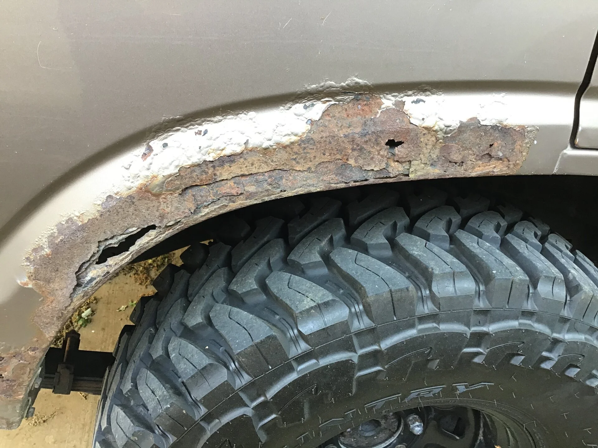

CrusierCobes this is a great share! I will be embarking on the same quarter panel replacement and have been looking for others that have done it. Question for you, did you need to remove or repair any of the inner wheel well tub behind the quarter panel?
@gvtxcruiser , the only way to know for sure is to tear into it. with exterior looking like that i'd almost bet it'll need work on the inside. there's numerous threads in here that deal with what you pictured n queried about. my "the dragonship" thread included. good luck man
