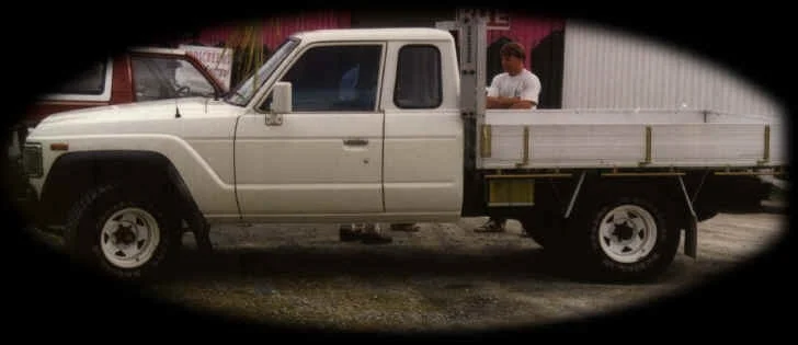

With the rear section (at the bottom), a panel was fabricated to weld to the bottom of the hatch, and then welded to the floor from underneath. This panel also has 2 H channels tacked onto it (inside) for extra strength and support. We rolled the sides to match the rounded corners at the rear.
With the inside panel, a bit of fabrication was done here also. But this was just a 90 degree fold at the top, and another 90 degree fold on the bottom (going the other way though). Another piece was welded in the corners just to neaten things up a little.
Dont know if these pics show what you want to see, but here goes anyway.

Loomis, thanks for posting the pics, they show exactly what I was looking for (how the rear of the cab was enclosed).
Extremely impressive work. I can't believe you did that in a month. But why on earth would you want to turn the impressive beast that is a full sized fj60 into a hobbit??
With the trayback, it looks more balanced
I'd like to see another hoop over the tray at the back, more like a family cage.
I would also consider extending the bar forward to get some more protection for the cab.
Most importantly- the work looks well done!
